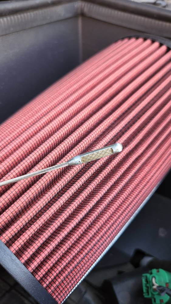

So I set up an appointment to get the Jeep checked out at the dealer... I've had it since Oct'21. Had about 98k miles when I get it and I did an immediate oil/filter change just to get oil in it that I knew.
It's at 101,300 now... started noticing some power issues and sputtering while riding about 25-35mph. Got home... checked oil... WTF?!?!
It burned through 2.5-3 quarts of oil?!? (That's about what I added to get it clearly visible on dip stick)
The dealer just did a valve/lifter job due to some serious tapping and there has been zero oil under it in our driveway. That seems like A LOT of oil to burn through in only 3500 miles!!! Doesn't it?
Thoughts? Suggestions?
Thanks
PIC: It was not visible on the hashed part of the dip stick but the bottom nub had oil on it. 20220318_153554.jpeg

I have a 2014 with 96k and mine doesn’t burn any oil. A problem I did have was with my oil cooler. It sits on top of the block between the valve covers. The seals go bad on it and oil will leak out and fill up the area it sits in. Mine didn’t leak any on the ground but would slowly leak as it was running and covered the underside of my Jeep I only noticed it because the trailer I was pulling was covered with oil. Did your oil pressure light turn on to let you know you were low or just the power loss?
Check your plugs. That should tell you if you are burning it.
Also be sure the vehicle rested for 1/2 hr before checking and adding oil.
I made the mistake of not letting it settle and overfilled.

Do a compression test to tell if it’s bad rings.
If you check again after 2tbl spoons of transmission atf oil in each cylinder and it reads a lot higher then you may have caked up rings.
If this is the case, there are a few things you could try to free up the rings.
Also check your intake. PCV valves allow oil to get sucked into the intake.
New motors are not built with tight rings and tight piston to bore tolerances. So blow by can be an issue. Also the simple does your oil smell like gas test.
Little more searching and there are threads about the rings being installed wrong from a mfg assembly plant in Mexico. You could check the back of the engine for the stamp.
T = usa
S = Mexico
