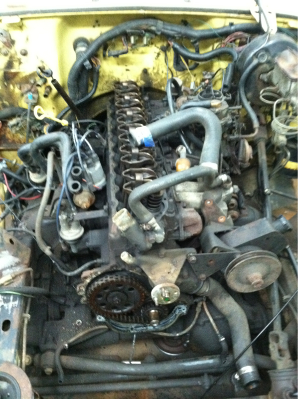

2 hoses im unsure about
CJDan
Have 2 hoses coming up from near the transmission into the front of the car. I'm in the process of putting everything in the correct place it goes but I'm not to sure about this. I have a picture and it is a yj. They are on the left side in the picture right in betweeb the distributor an fuel pump. I'm not too sure what they go too or where they really are supposed to be location wise but that's where I have them for now.
Those appear to be Air Injection Hoses. They would normally go to a belt driven air pump (emission control for pumping fresh air into the exhaust syst. to "light up" the Cat. sooner).
