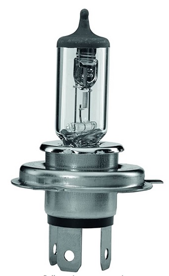

2) How do I find just the headlight harness for this kind of bulb? 3 prong, pic below. Every search I do for H4 hella harness gives the whole thing and I just need the parts that plug into the bulbs w/ pigtails.

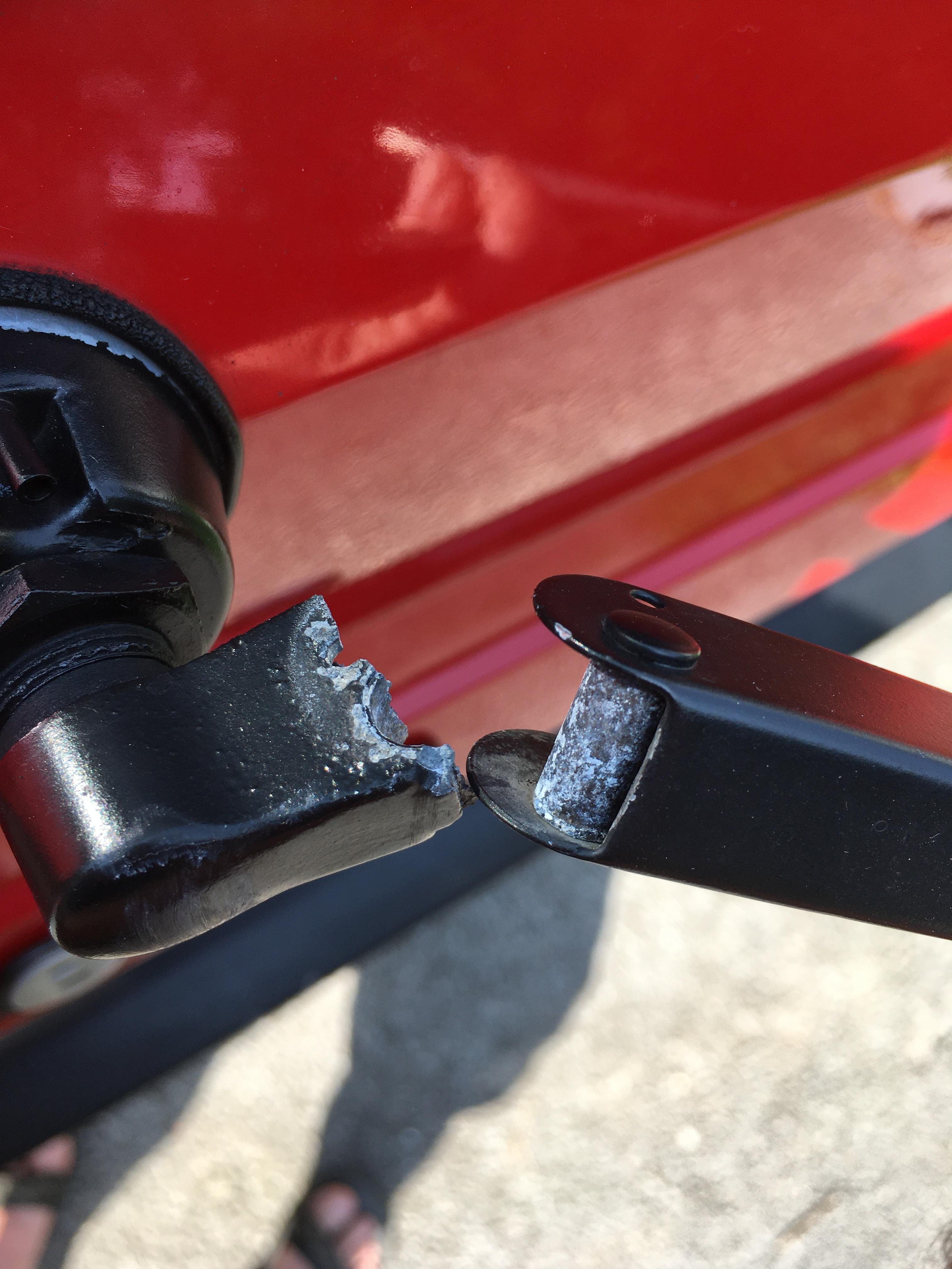

3) Broke the dang rear wiper assembly the other day and need to find replacement parts. Thing is I hadn't paid any attention to how this broken part (pic below) was before it was broke so I don't know how they go back together, or if I can just order the small broken part or the whole arm assembly that comes with it. Also wondering what it's called and where to look for it.

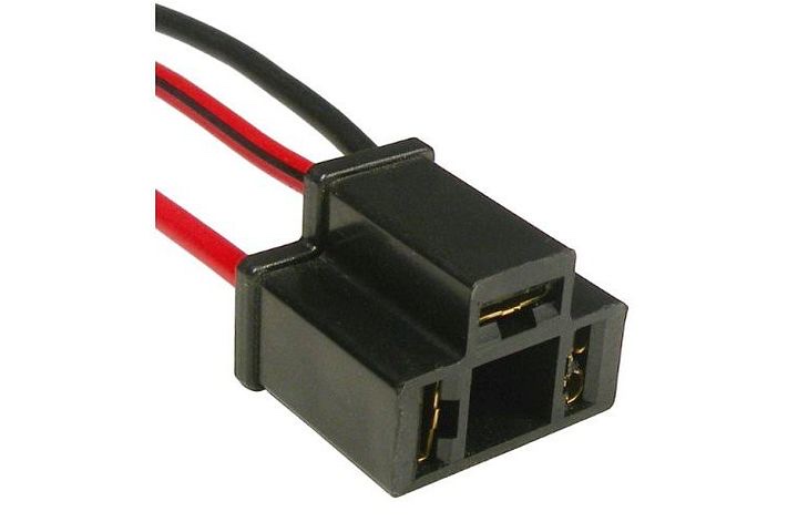

H4 female pigtail.
Doorman. Napa. If you go high wattage you might want a ceramic connector and run heavier gauge wires through a relay.
Same just google it 96 XJ rear wiper arm assembly
OMIX 19710.08 Rear Wiper Arm for 84-96 Jeep Cherokee XJ | Quadratec
