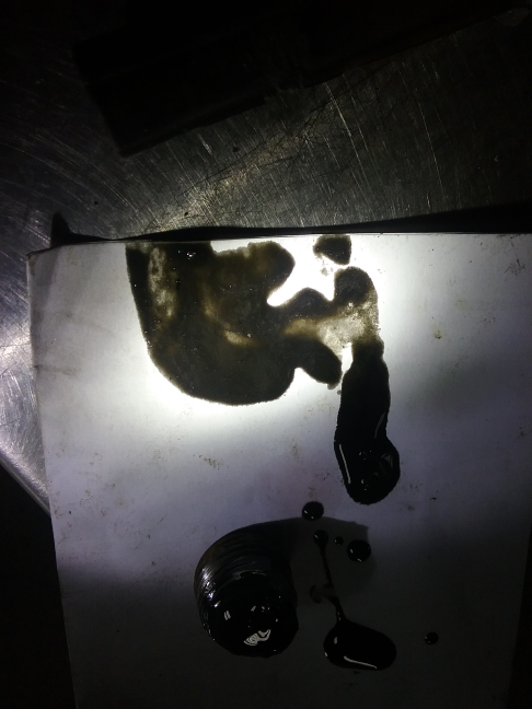

I have a '11 Crown Vic with 300k miles on it and my rear diff fluid looks like this...

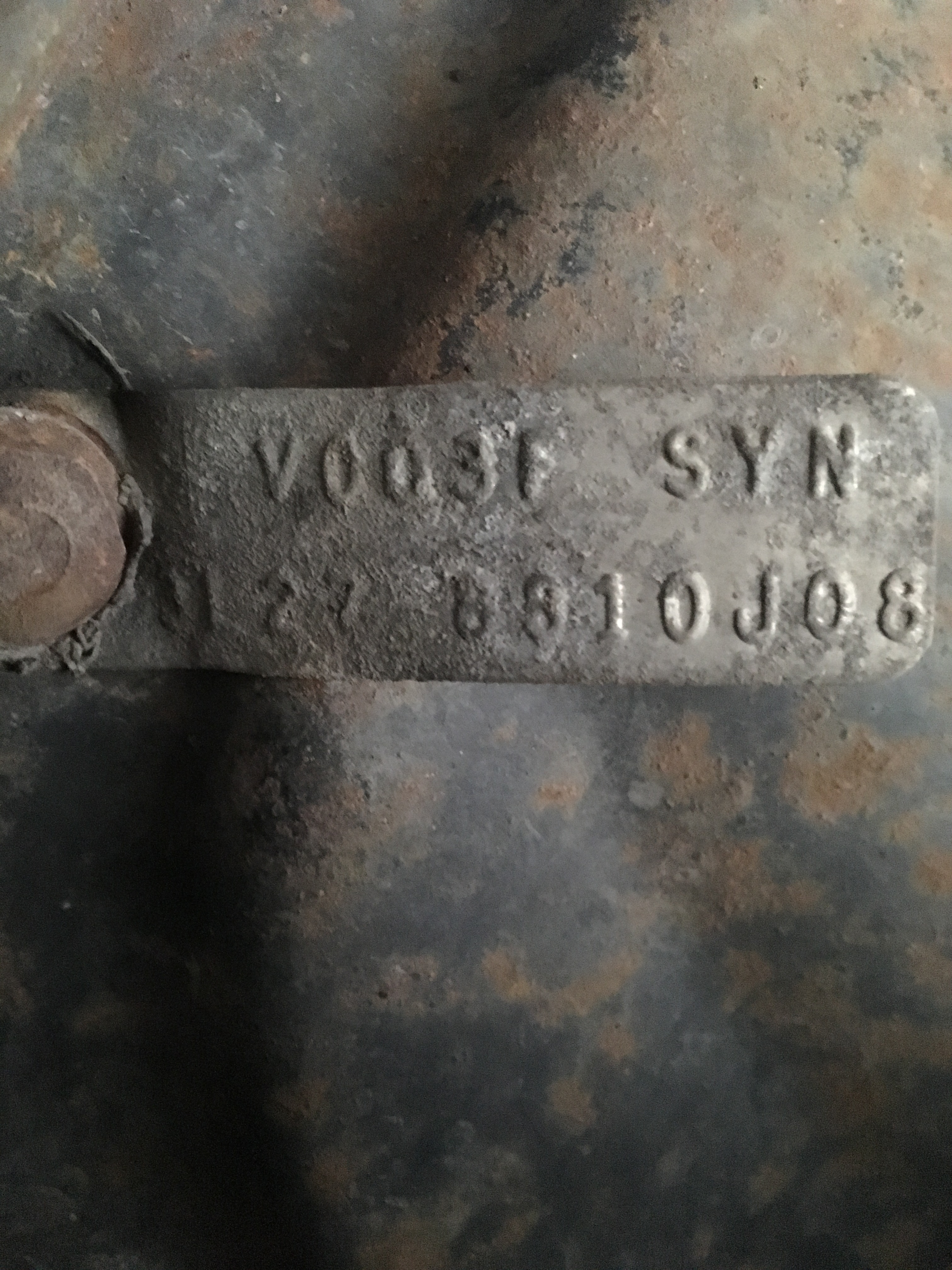

Here's the diff tag...
I believe that shows a 3 (L or 1)? 27 which indicates a 3.27 gear ratio, and then an 88 after, which indicates the 8.8 axle. Not sure what that SYN means, unless it means synchronous?

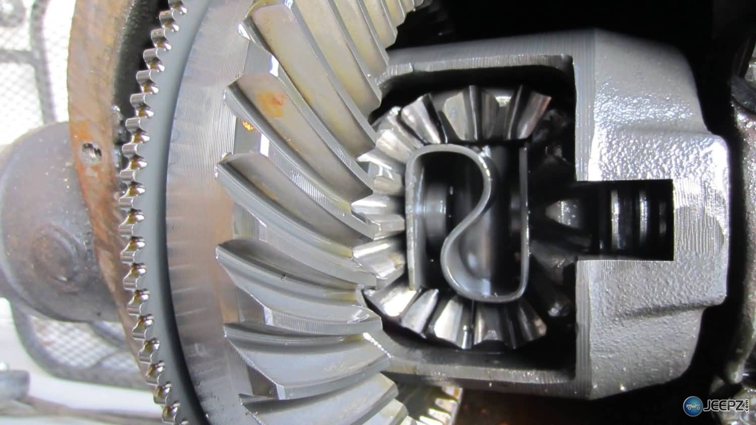

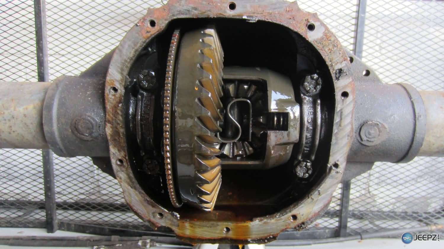

If you are changing the oil and have the pumpkin open, check and see if it has this S spring - this is what applies pressure to the clutch packs
15847d1357679549-terrymason-s-2005-jeep-tj-build-12-stock-ford-8.8-carrier-terrymason-jeep-wrang.jpg
You can kind of see the clutch packs in the right of this photo
15848d1357679549-terrymason-s-2005-jeep-tj-build-13-stock-ford-8.8-lsd-terrymason-jeep-wrangler-.jpg
If it looks like Terry's good. Just wipe it out.

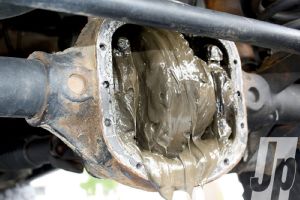

The below needs some cleaner.
