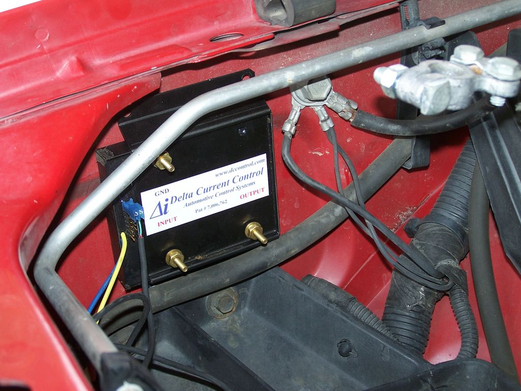

Go with an Aluminum Radiator with at least 3 row, then use an Electric fan and an adjustable Thermo switch. I've had this set up for at least 5 years and haven't had any problem with the Cooling system. Bounty_Hunter has a cool fan module he just purchased. i beleive it's a Dakota Digital.
A stock radiator rebuilt to 3-core will work also.
Here's the electric fan controller: http://www.dccontrol.com/0820.htm
