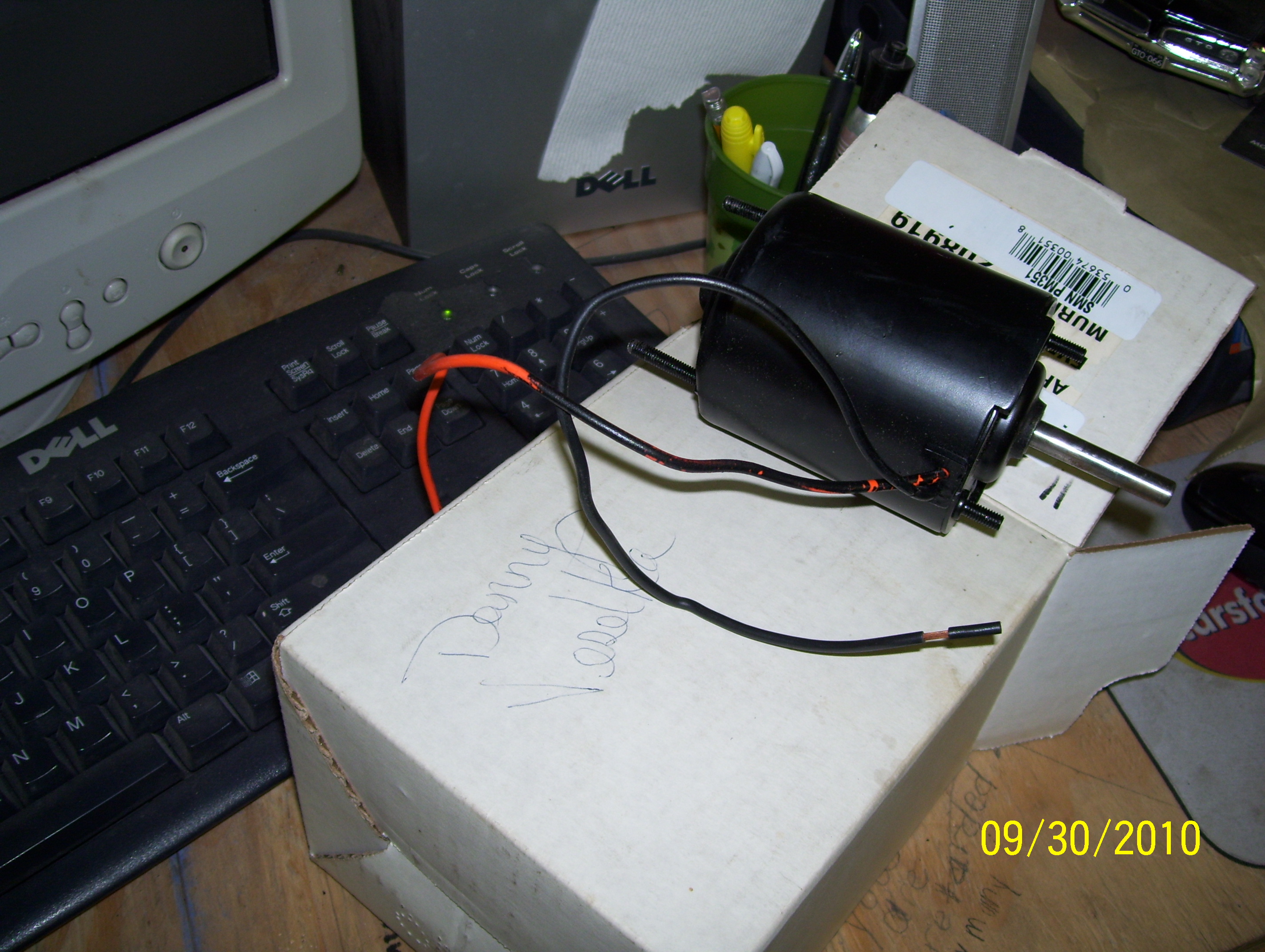

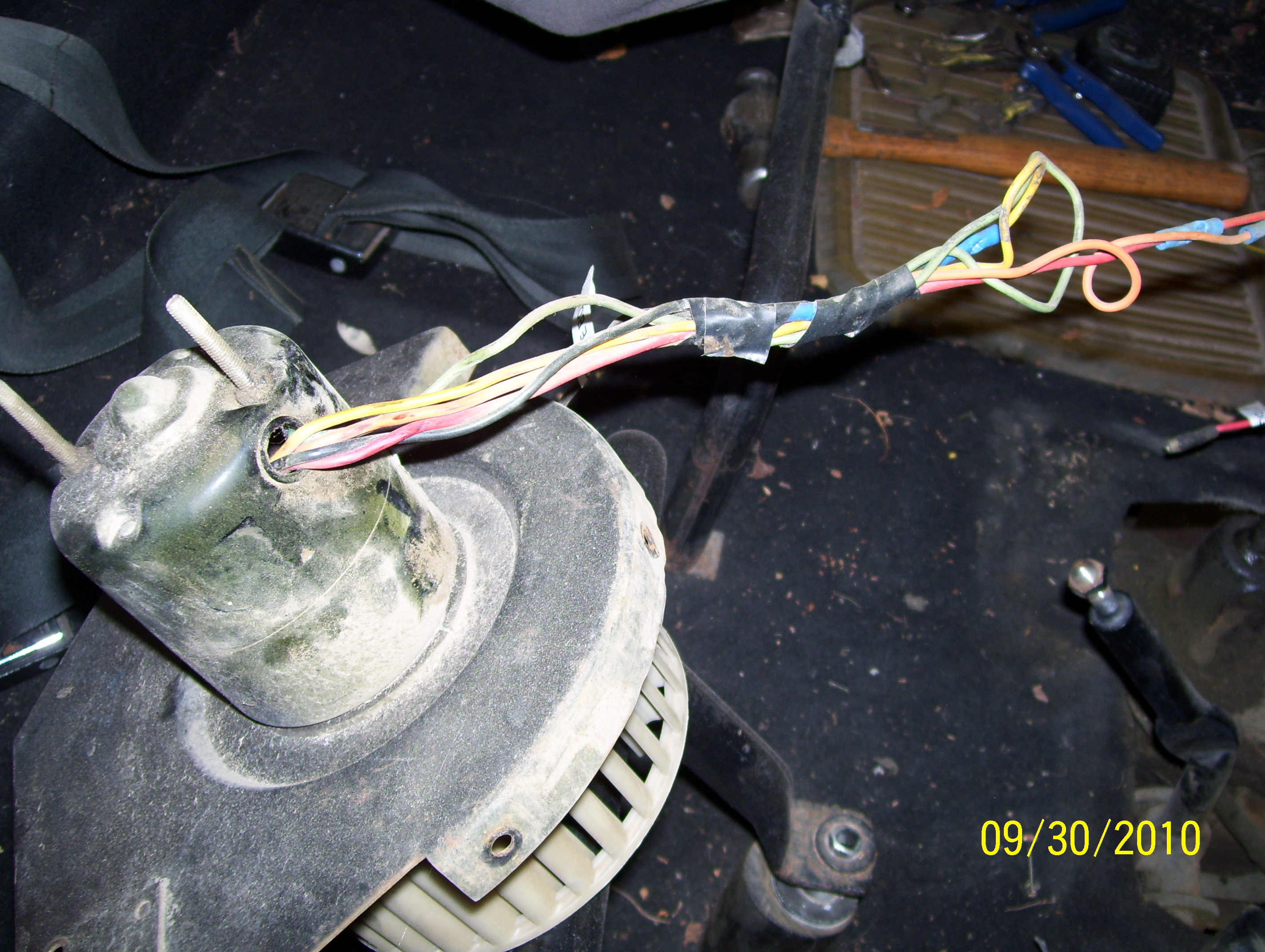

Anyhow I put some pics up that show a new blower versus the old one. The new blower motor has 2 wires coming from it.
The old motor several more. Oreilys insists this is the right one. What gives? I have a fan switch that has high and low speeds.

I think your old blower motor is out of something else. If I recall, my CJ only had two wires going to the motor. There is a resistor on the heater box that "makes" the speeds. You should find that some of the wires from the switch go to the resistor. If you are changing the entire wiring harness the new one should have the right plugs to make it all work. Nice Jeep, very classic. -John
The wiring diagram I have for the "75 shows 2 wires from the blower switch to the motor(one red one orange) & a ground.The ground may be thru the mounting bolt.As Crazey4Diesels said the resister is in the switch(to "make the speeds")

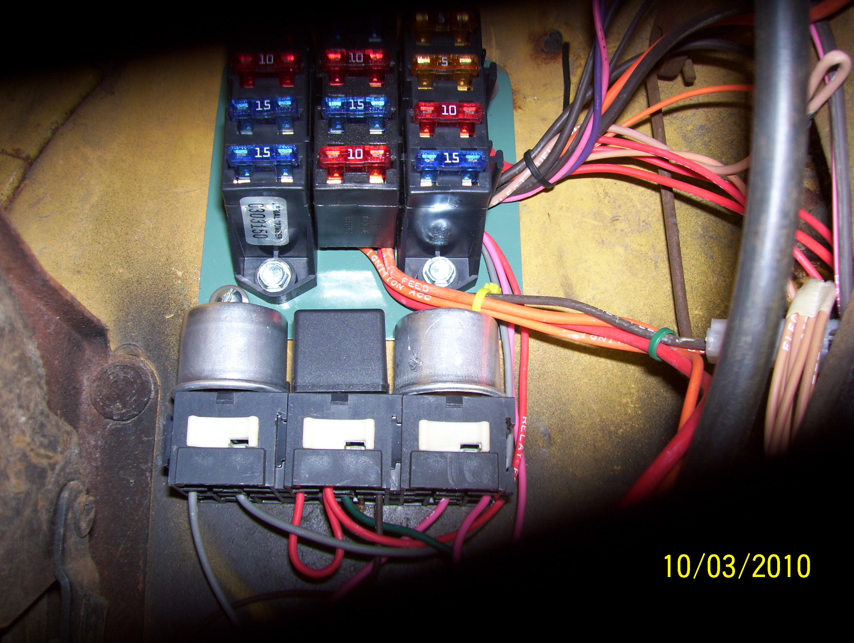

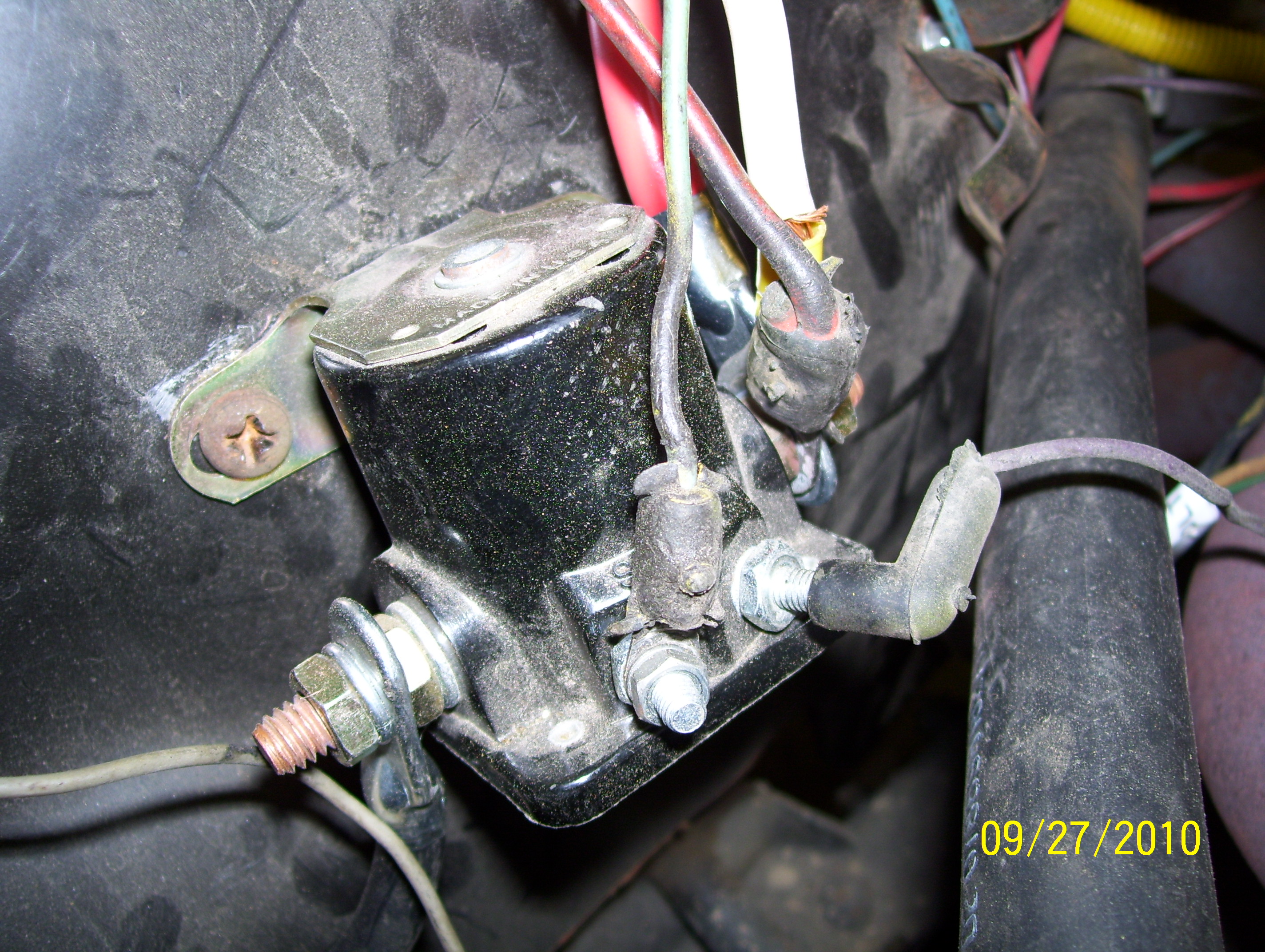

Also the 3rd picture you posted is the starter relay.I suspect the PO wired the heater switch to draw voltage from there instead of the fuse block.The heater should be fused. Hope that helps!! I'm not familar with Ron Francis wiring kits,but I would expect it will come with decent instructions & diagrams.
Thanks for the quick replies! You confirmed what I had thought-PO installed "some kind of motor" from something else.

BTW... You do see that the right angle connector on your starter relay is barely on there. It will get replaced when you do the new harness BUT in the mean time it could cause some intermittant grief. Best of luck with the Jeep - keep us all posted on your progress -John

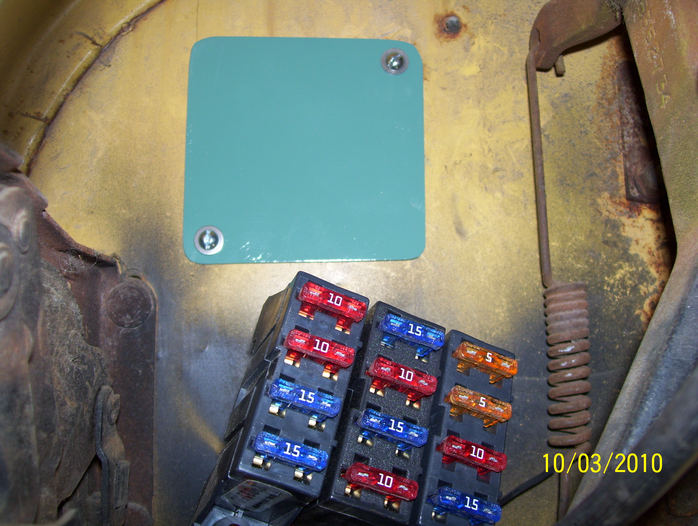

I made a steel patch and attached the fuse box to it. Then I bolted it into the area of the stock fuseblock, bulkhead.

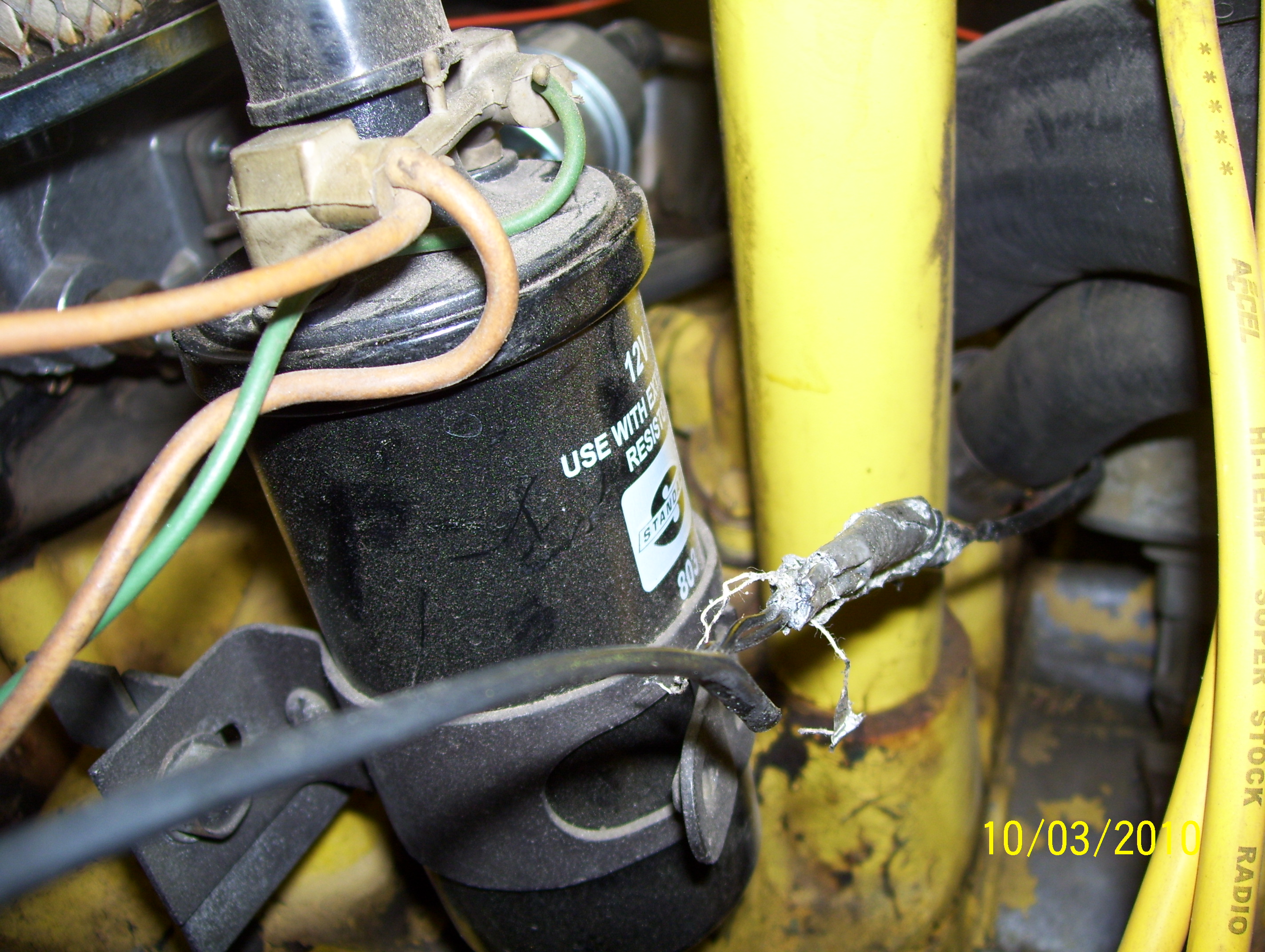

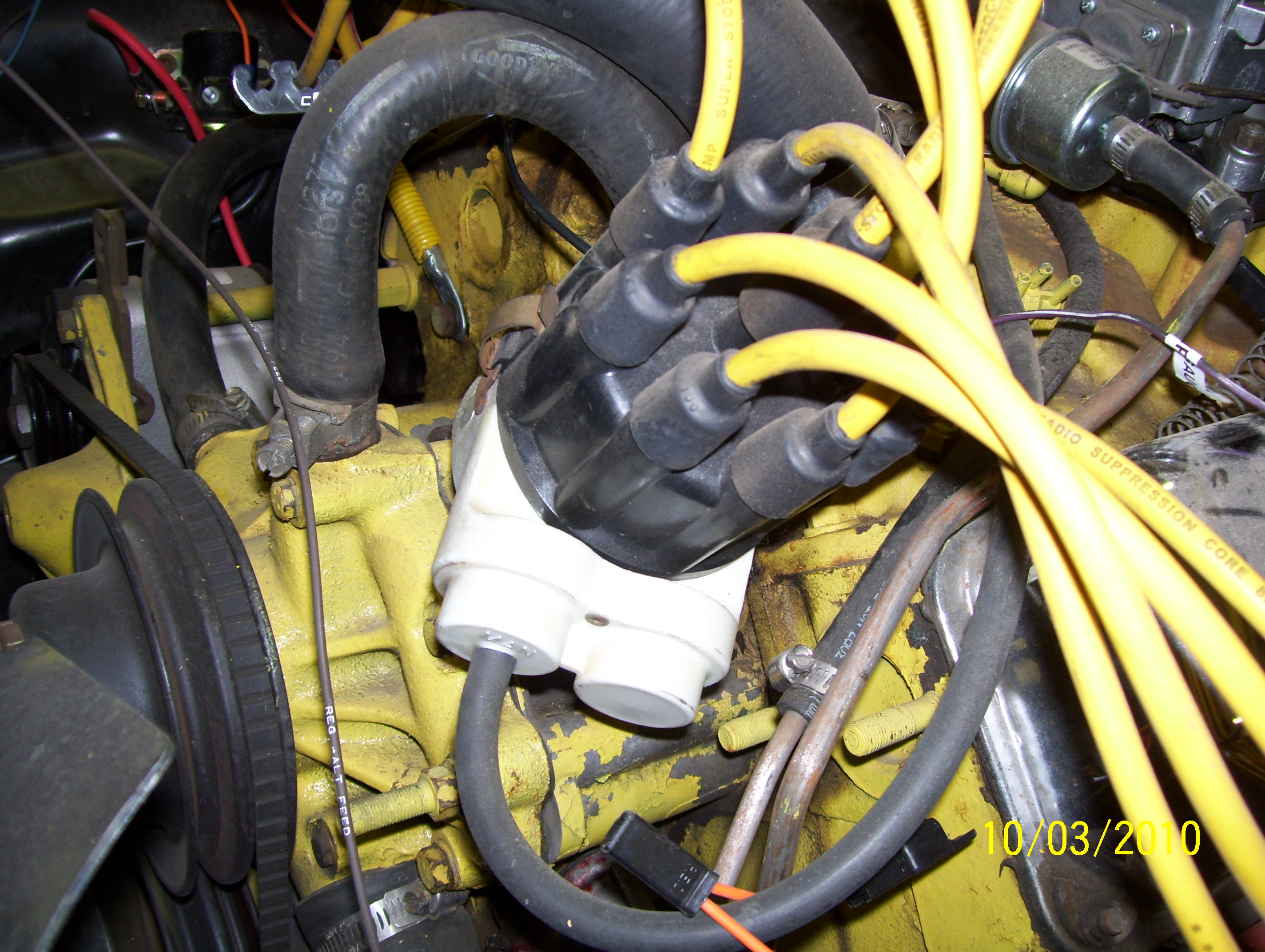

First of all, are these pictures of the prestolite electronic ignition? There are 2 long wires coming out of it that I assume would be the pickup coil wires? They have been spliced together at one point and used DUCT tape to insulate it?

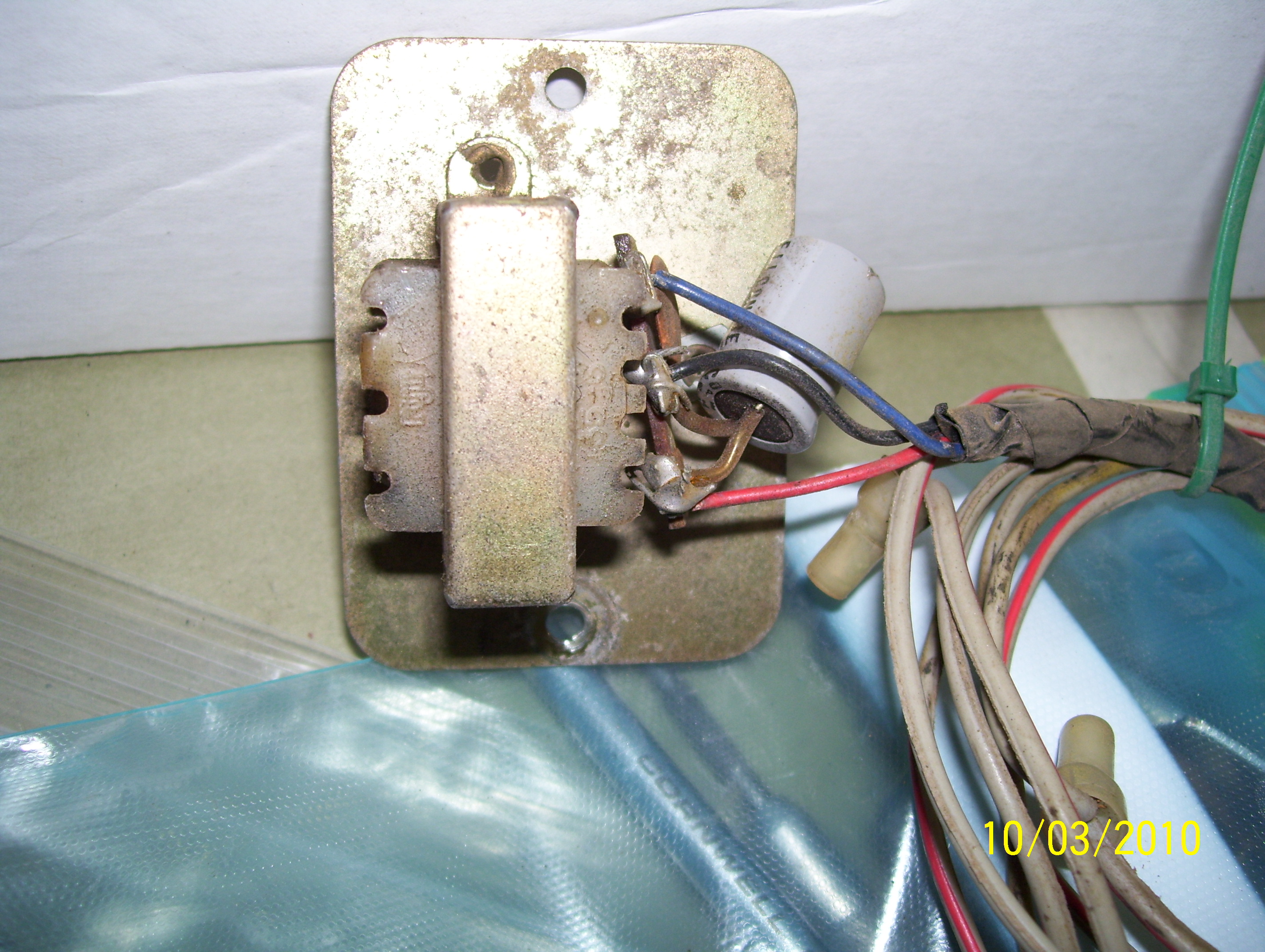

Another picture is from under the dash near the defroster duct to the right of the steering column. Is this a resistor?

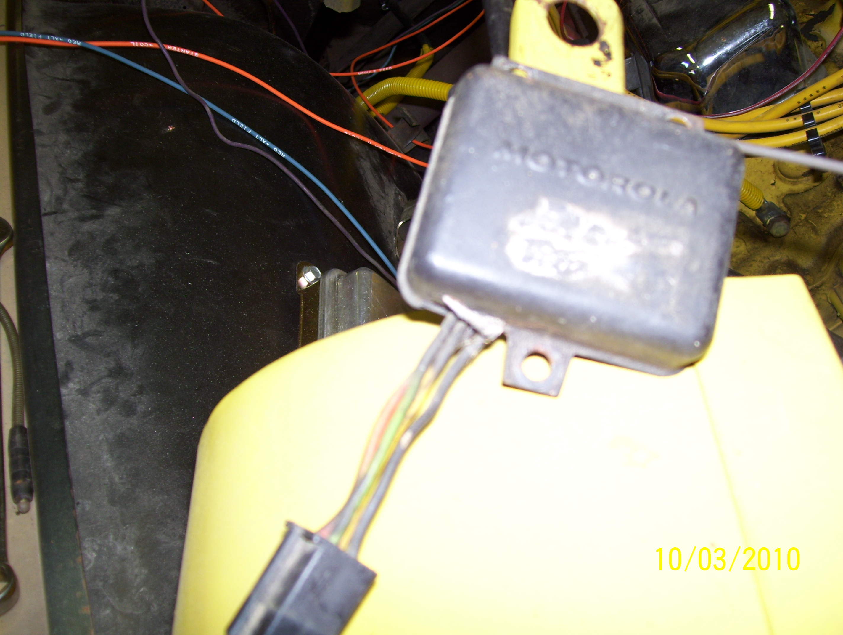

Last question is that black box that says MOTOROLA the module?

I just ordered a new HEI style distributor for the 304. For 90 bucks and upgraded system it just seemed easier.

The thing you found under the dash looks like a crossover or filter for the radio (probably not stock). The resistor is in the side of the heater box (look for a tan bakelite or phenolic flat thing on the outside of the heater box near the passenger side. It should have at least three wires going to it - mounts with a couple of screws) . Did the wires from the Motorola unit go to the alternator? You have a Jeep that falls in the time period when they used Motorola alternators and external solid state regulators, I believe. Best of luck - John
