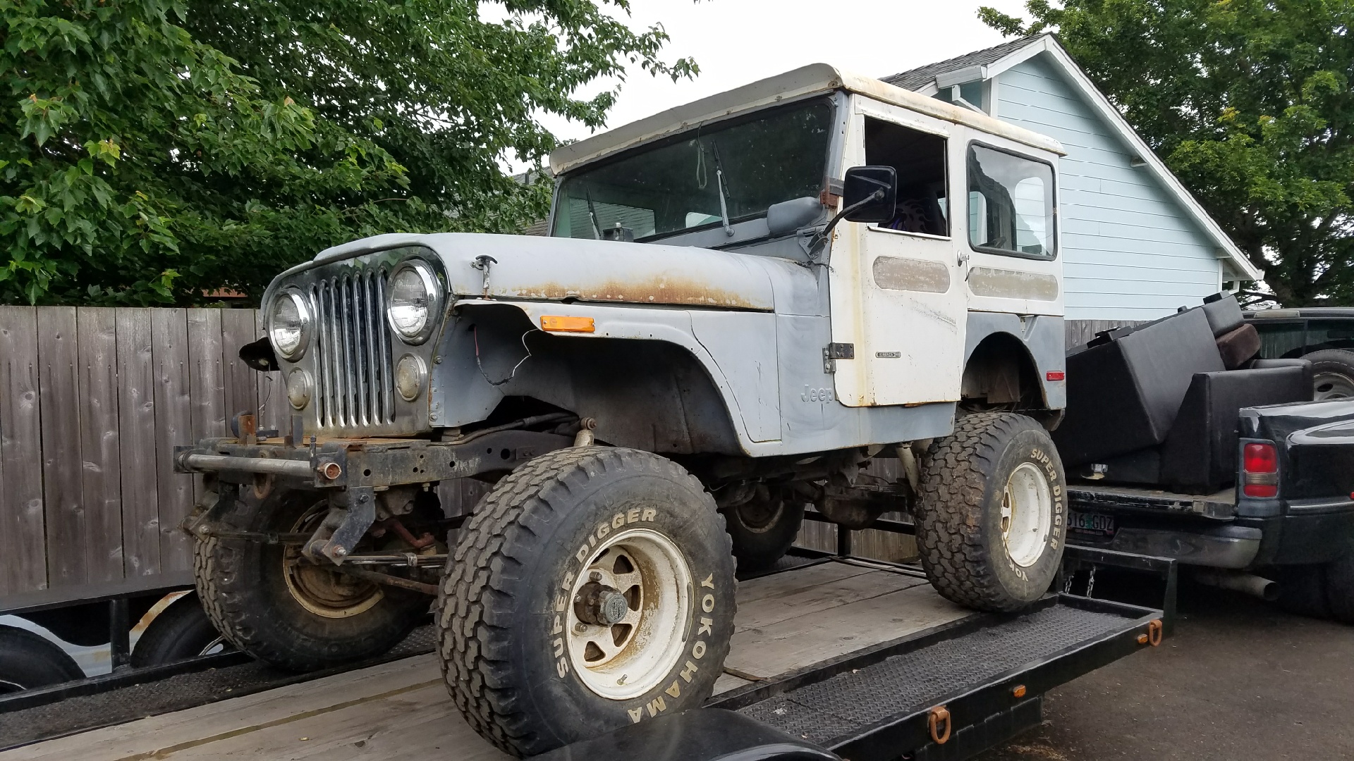

Hi all, I'm new to the forum. I searched the forum with no solid conclusion. I am trying to find out what tubs I can use on my 76 cj5. It has a lot of rust and I want to change the tub. What other years will fit on my frame? I'd rather not alter the frame. Thanks in advance. Shane
Any CJ5 tub will fit. The hood & fenders were shorter from 56-71. In "72 they stretched the hood & front fenders, but the tubs dimensions stayed the same.
There's a lot of differing opinions on fiberglass vs steel for replacement tubs, I went with a steel tub from Willys-Overland(repli-tub) on my "78. 2 buddies & I had it bolted on in under an hour without rushing. I've also worked with fiberglass on other Jeeps & there are pros & cons to each. Do our homework before you spend our money.
Lt us know what you decide & as always...Pictures are appreciated! Check out the"Jeep Builds" Forum.
Thanks, that helps a lot. I'm looking for a used steel tub that is in better shape than mine. Don't want to spend too much, it's just a toy. Has the 304 with 3 speed and hard top. 33 inch tires on steel wheels. Bought it cheap. Good winter toy when I get it done. It's stuffed in my small shop so hard to get pictures yet. Also, does the title go with the frame or the body? Thanks again, Shane
I did have a couple pictures when I bought it. Forgot about them.
The title goes with the majority part of the vehicle....in your case that would be the chassis. If you buy a new replacement body, they do not come with a title. If you buy a used body it may or may not have a title & or vin plate depending on the seller.

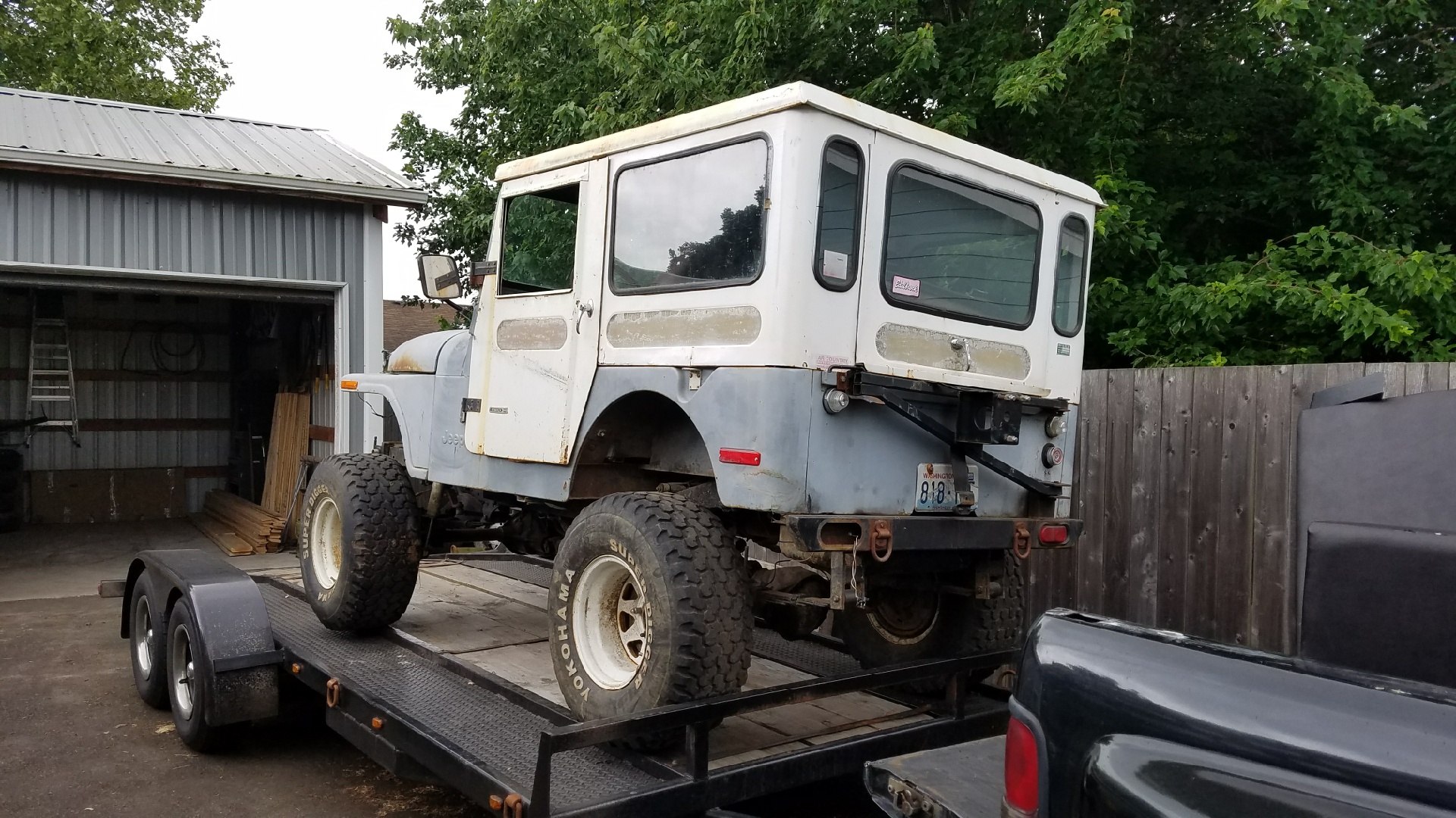

I didn't find a tub so we just started replacing the floors with some .0125 steel I had laying around. About double the original thickness of the stuff we took out. It sits level now. I have a rebuilt 304 to put in it that came with it. That's next. Then just need to replace the front fenders. PO cut the front of them off. I want the full fenders. Wire it up and test drive it. Still cheap if the motor is good.
Got the floors done and the engine in. Looking for a water pump pulley for a 304.
