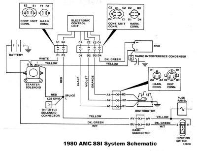

This is what I am trying to achieve. pin E2 F2 is the problem wire
