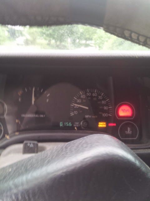

Hello, I am new to this forum, but have heard good things about it so here goes:
I have a 97 Jeep Cherokee Sport, and the oil light recently started coming off and on. There's not a lot of pattern as to when it comes on, but it seems to come on more when going around a curve or up or down a hill, and go off on straight-aways. It doesn't seem to stay on more than a few minutes at a time.
There is plenty of oil in it.
In addition to the oil light randomly coming on, a recent pulley noise has started. It sounds like your typical malfunctioning power steering pump, but it really sounds like it's coming from the opposite side of the engine, specifically the a/c motor. The a/c and heat both work really well. I don't know if the sound and the light are related, but they both started at the same time.
I took the belt off and tried spinning all the pulleys. It doesn't seem as though any are lagging real bad. A bearing could likely be going out, and perhaps that's affecting the oil pressure. That's my only guess.
Has this happened to anyone else, and given the clues I've provided, does anyone have any suggestions aside from the shotgun approach like buying random parts, such as the power steering pump and fuel pump?
Thanks a bunch.

Could the noise you are hearing be In the engine? A bad oil pump could cause your oil light issue.
Sent from my SM-P600 using Tapatalk
I don't know. It sounds a lot like faulty power steering pump. If it's coming from inside the engine would it sound the same?
Is there a way to test the oil pump?
Hi Issac , welcome to Jeepz.com . If your sure there is no short in the wiring on the oil pressure sending unit switch , is the engine idle stable , not dropping or raising like a vacuum leak at at the correct rpm ? Too low an idle will produce too low oil pressure but would have to be really noticeably low rpm . If you are not getting any rattle , knocking or vibration from the engine , especially under load , rod and main bearings should be ok . As you drive , listen for this.
As far as overheating , knocking would happen before overheating if a bearing(s) were going bad.
Since your curious of your oil pressure , see if you can get a decent oil pressure gauge from a parts store . You want to connect it in line with the existing sending unit so you can get an actual reading in psi so as not to depend on the idiot light. If a really nice one is gotten , you may want to install it on the dash so you may monitor oil pressure as you drive. Since this is troubling you , it may be a good idea to do this. You can't actually test the oil pump itself , you can only check the oil pressure , which is the by-product of the oil pump so that should suffice .
As far as this noise your hearing , try your best to isolate it . An alternator bearing , which the alternator is of course on the opposite side of the power steering pump usually could stand to be checked as well as the a/c compressor . If the a/c clutch bearing is going bad , it may proce a scoring / squealing noise as will an alternator bearing. Also , if this noise is heard at idle and you suspect the steering pump , does it increase when you lean gently on the steering wheel ?
You need to know if any of the driven accessories have a bad bearing before it seizes and throws the serpentine belt. Although the alternator , a/c compressor , power steering pump are important ( also , check the water pump and clutch fan ) , please do get a psi reading for the oil pressure . We know that is important. Wishing you luck and hope all will work out.
P.S. - did you check for a trouble code since the check engine light is on ?
P.S..S- forgot to mention , the o-rings inside the oil filter mount , if they are shrunken , oil pressure is lost there too .

Great, thanks Greg. I hooked up the oil pressure gauge today, and it's reading 50-65psi. I didn't drive it more than 10 minutes with the gauge, so maybe it'll drop lower once it's warmer.
I think maybe the sending unit was loose or going bad, and screwing with the idiot light. I've got the pressure gauge mounted so I'll keep an eye on it.
