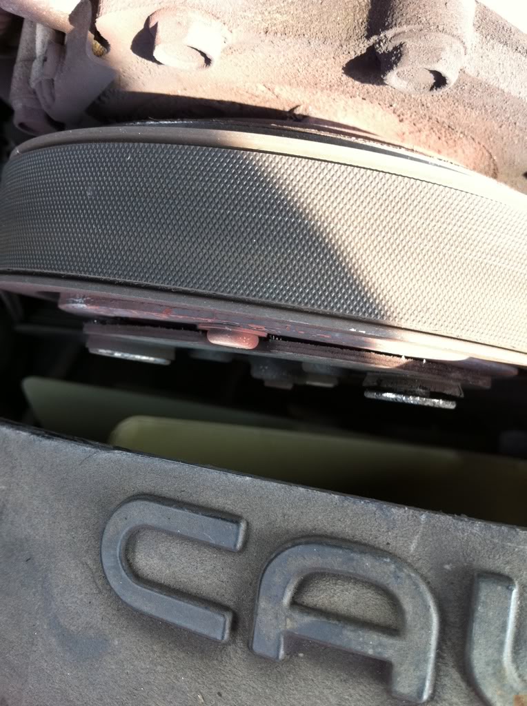

Looking at the compressor the one head is pushed out and it looks like a washer is loose as well:

Im not sure if i missed it, i saw some of the dash lamps turn on when you key on but i didn't see the needles on the gauges move, does it?. The symptom of not having any cold air coming out on the hvac during idle is most likely due to a low freon. The picture that shows the pulley and the clutch indicates a failure on the clutch part which could also seize up however, if thats the case, the engine would still turn over and start but will be followed by a loud screeching noise due to the pulley locking up IF that's the case. A no crank can possibly be a weak battery, bad starter, bad starter or ASD relay or a bad PCM. One thing to consider is if your Jeep is equipped with a SKIM key(Gray). If the tell tale lamp on the dash (red dot) lights up and stays on at all times after a key on, the security system maybe whats causing a no crank condition and should be addresed first.
