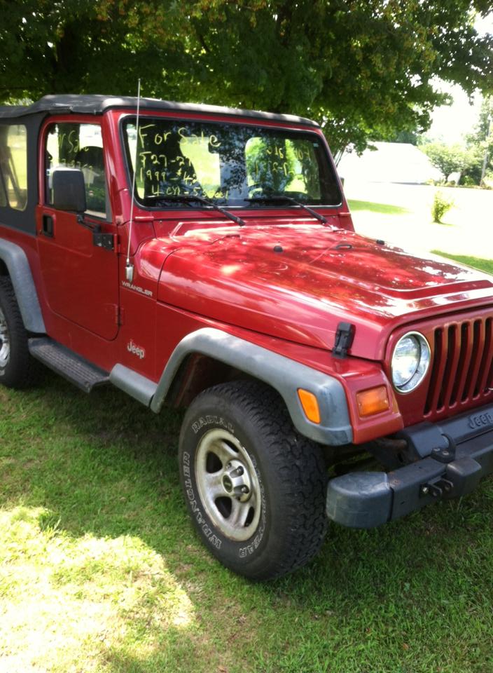

We agreed on $4000 for a price. It needs a new soft-top but besides that it seems to be in relatively good shape, I checked pretty thoroughly for rust and didn't find anything out of the ordinary for a vehicle that's over 10 years old. Does this seem like a fair deal?
Here's a pic of it in case anyone would like to see it:
