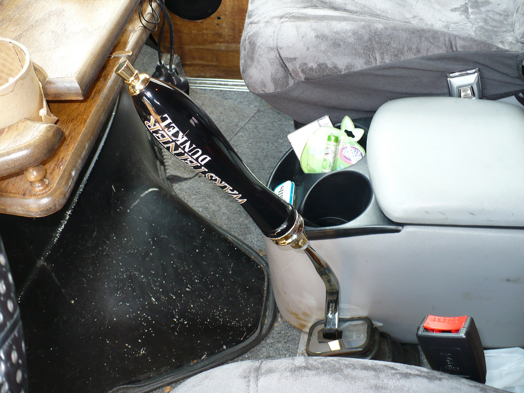

Funny thing, my old black panel van "Easy Bake" had a 3+1 Rug/Rab standard transmission with the stick coming out of the floor like a pickup truck. Had a 3' long stick for wasy reach but when the shifter linkage went kaput, I grafted on a Hurst Competition Plus shifter. The handle was too low for comfot in my van but noting the thread pitch on the stick, I threaded on a tap handle of one of my favorite German biers.
