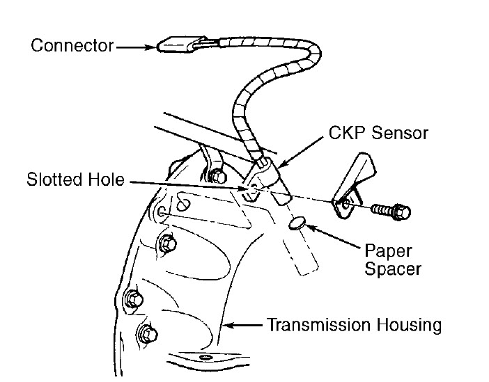

When you replaced the CKP was there a paper spacer or gasket on it? Did you install it with the paper gasket? If you install it without it the CkP will likely be damaged at the first start.

There was no paper spacer on either of them when I installed them. I did get a chance to scan the CEL this morning before work and got P0113 - Intake Air Temperature Circuit High Input
