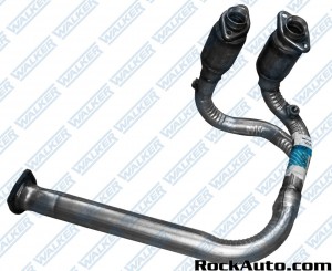

I have re-indexed the sensor several times with the same result....I still cant help but wonder about the wiring harness missing plugs to plug in the 2 o2 sensors in the exhaust manifolds. the tj has 2 upstream and one downstream....however there is no catalectic converter between them....so that has me confused as well....this leads me to believe there was some swaping that happened before he bought it. unless im missing something....going to swap the flexplate just to eliminate that as a possibility
The 2000 should have a three cat system.

well that's not whats under there. has 1 o2 sensor just before the flange and that's it....
