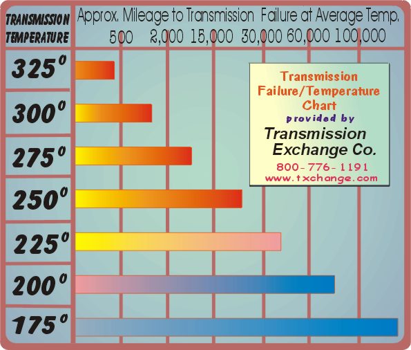

I read that ATF is designed for 175F and will last 100,000 miles, and that every 20 degrees above 175F the life of the fluid is cut in half. I'm not sure how accurate that is though.
