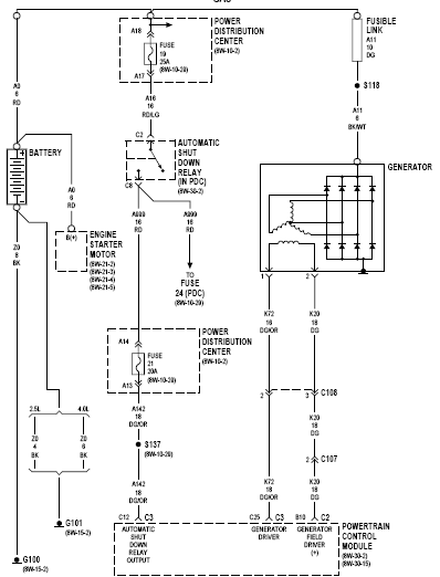

Found this, may be helpful :).

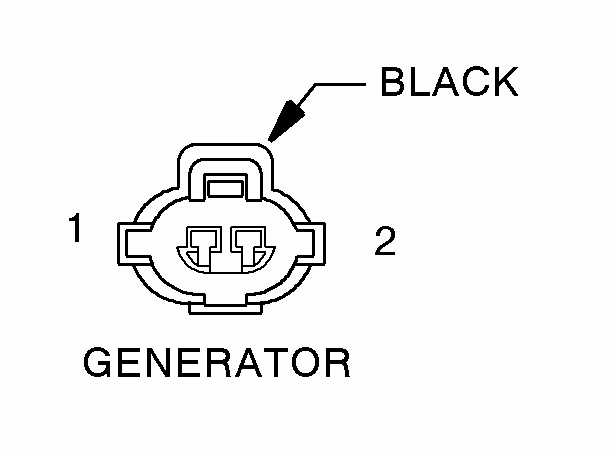

and to make things easier can someone tell me where exactly the green wire, and the green and orange wire are supposed to go??? are they supposed to have a plug on the end of them that plugs into the alternator? if so, from top of vehicle which one goes on top side and which one is on bottom?
GENERATOR - BLACK 2 WAY CAVCIRCUIT FUNCTION(1)K72 16DG/OR GENERATOR DRIVER(2) K20 18DG GENERATOR FIELD DRIVER (-)
By looking at the plug orientation vs. the alternator , you should be able to determine which wire goes where if there's no number on the back of the alternator.
thanks alot for that picture. so whatim understanding is dk gr is negative and dk gr/or is a positive? my dark green/orange is pulling in 12.4 volts while engine running, no volts with engine off, but the dark green is disconnected....
so just went back out there and now this is not making any sense, dark green/ orange wire while engine running is a positive 12.4 volts. shut engine off and it is now a negative 12.5 volts... wtf. the dark green wire is negative 12.2 running negative 12.15 while off. i now believe this "thing" on the back of the alternator is an external regulator... but i believe all this wiring is wrong.... this is racking my brain
The book says the dark green should be near battery voltage with the engine running and the ASD relay energized, voltage into the field windings. You can test this at the green wire disconnected from the alternator. That thing you are looking at is doubtful to be an external regulator, more likely the fusible link. Disconnect one end and do an ohm test to the other end after stripping back a little insulation, should be zero ohms.
What you are reading on the orange and green wire is likely residual voltage from the regulator/driver, it said in the book it is a pulse regulator.

i have a picture of this "thing" but have no clue how to put it in here, its not like other forums where you can drag and drop :( but anyways i was out there messing around with it and following that plug diagram i did a plug and pray lol i totally disconnected this "thing" :twisted: connected B+ from the proper location, hooked up the dk green and dk gr/orange to the according pins thanks to the earlier diagram of the plug. plugged everything back in, started her up, started fine, moment of truth, put the dmm on the battery and she has 13.9 +/- volts while running!!! took her down the street with no problems so far.... also, there is absolutely no fusible link going to alternator, i changed all the power wires and noticed one that look to be joined with a plastic sleeve on it, so stripped the sleeve and its just where the wires are connected no fuse no smaller wires.... have i done something wrong? will be going to autozone later to ask them to run a charging test for me to make sure amps and what not are right. crossed fingers, but shes running fine now.... oh and even tested with engine running, headlights and a/c running and it ran around 13.1 volts.... is all safe and good to go???? did we do it???
