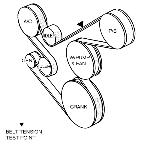

after changing my water pump i tried to put my belt back on --but must of forgot how it went --1994 4.0 6cyl. laredo--looked in the archives but none of the diagrams match my setup--Jeep has a/c and p/s--i have 2 idlers on the left between the water pump and a/c and alt. --p/s is to the right --i did not move anything or even loosen the p/s--now the belt is too long if i put it the way i think it goes with flat side to all idlers--any diagrams for my setup? --thanks
Check under the hood (on the bottom side) and next to the radiator for a belt routing sticker.
Check the attached image file for belt routing

Good. Information. On. The. Belt. Routing! A. Couple. Of. WEB. Sites. Where MORE. - - - Belt. INFO. Can. Be. Had: 1. Freeautomechanic. 2. Serpentinebeltdiagrams 3. Alldatadiy.com. (Third. Site is not free). But, there is. SOME. Real. GOOD stuff there! Also. - Chilton. WEB. Site. Is not. Bad. JB

replaced belt and both hoses while i was doing my water pump --the tensioner is the p/s pump and moved pretty easily after i took out the air box--the only problem was the belt routing and trying to fit the fan and shroud both in at the same time-thanks to all
