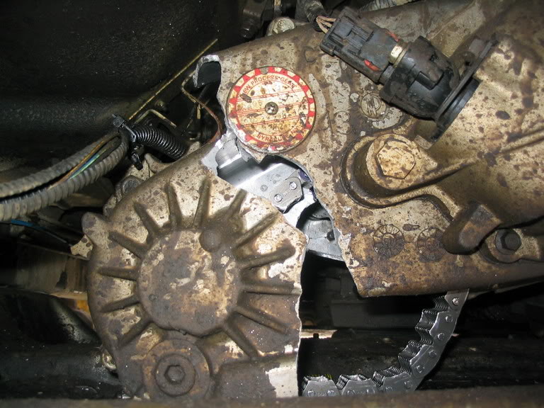

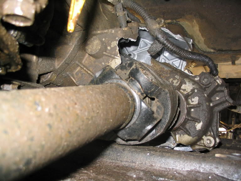

This is the carnage that occured on the highway after my last wheeling trip. It wouldnt be that big of a deal except i dont know if its a NP231 or a NP205. Does anyone know? It's a 1999 TJ, 4.0 straight 6 automatic.
Ouch. Yeah definately an NP231, but for future reference it should be stamped on that metal tag in the pics.

There is some good news, your unit was assembled in syracuse, ny.

you did a good job on that thing!

I bet next time you will take a few minutes to pull the front driveshaft out. If you get the slip yoke eliminator in the rear of your new case you would be able to remove a bent rear. That sucks nevertheless.
