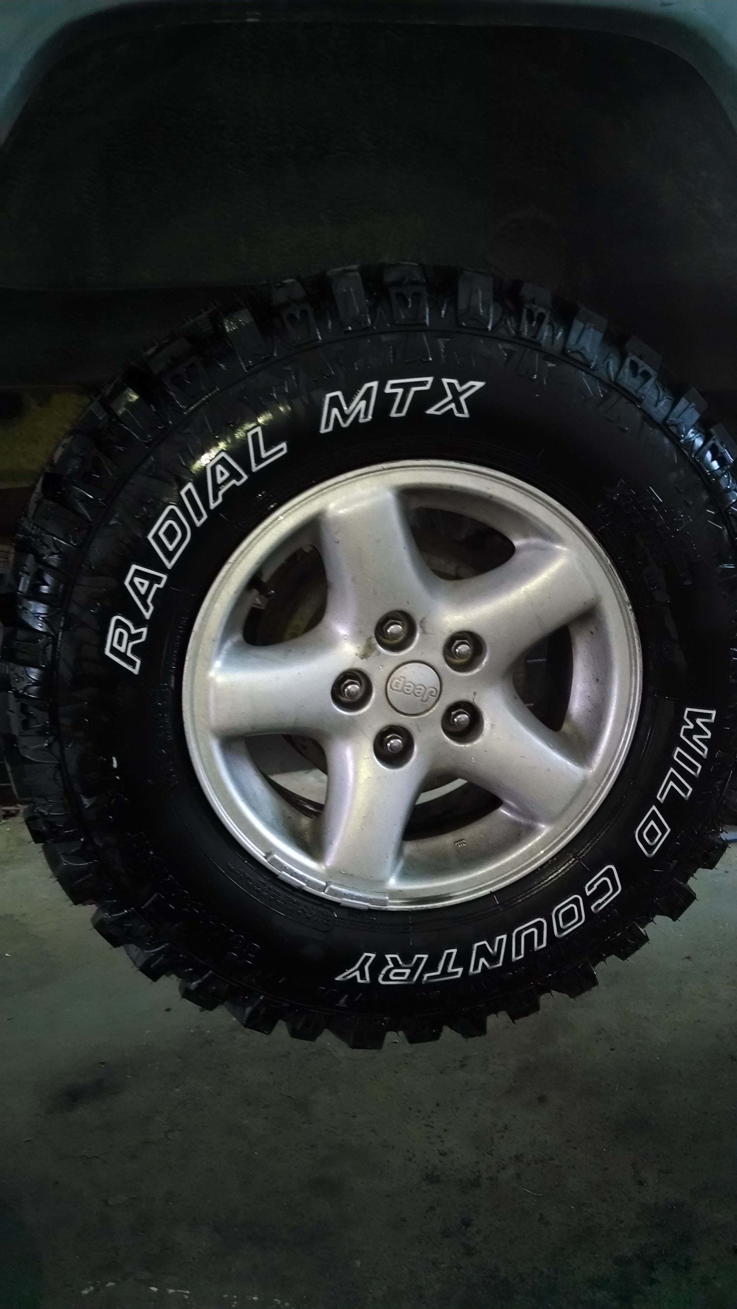

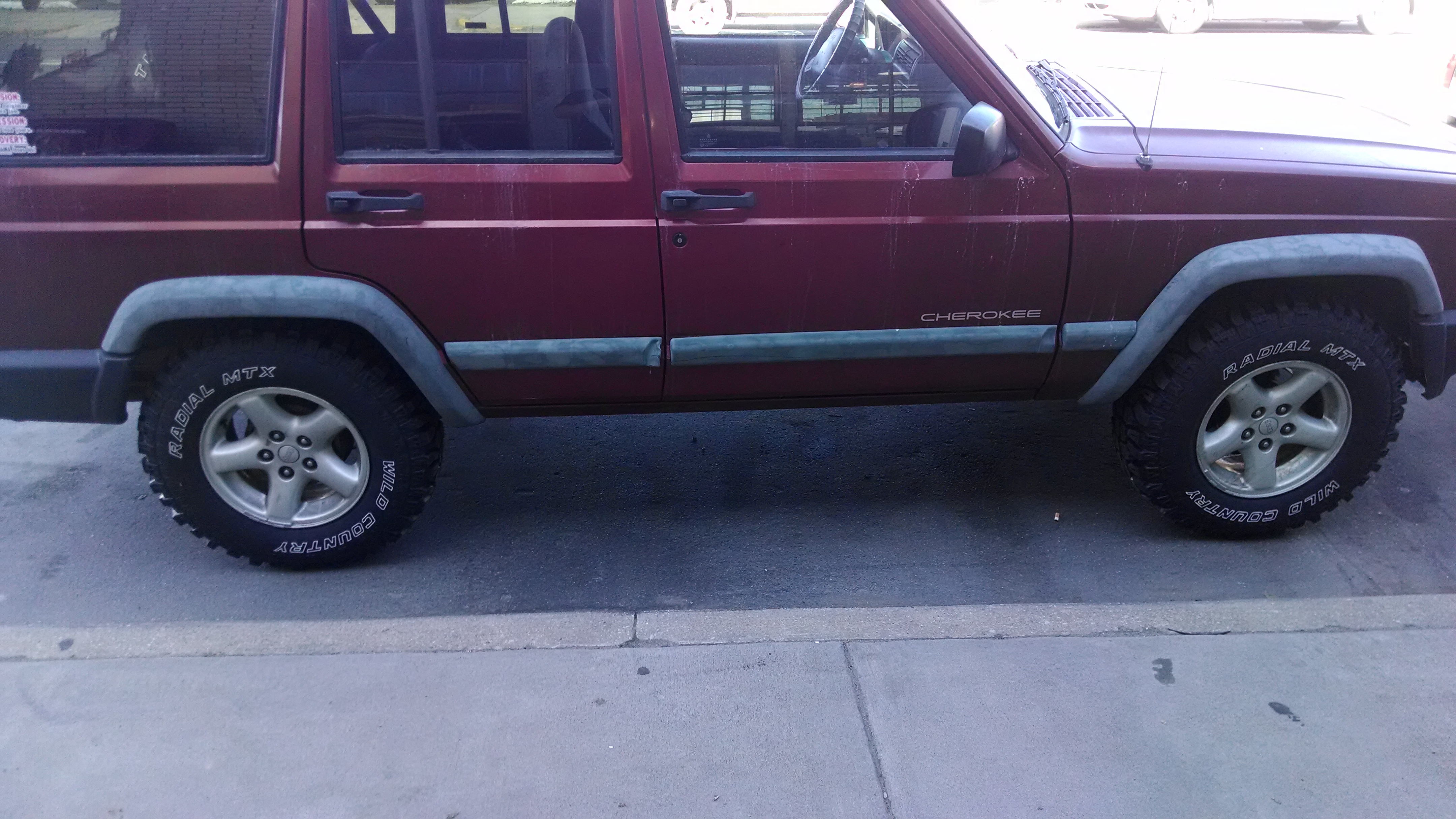

I am running 30.9 the only issue I found is an extreme turning angles I get a little rub and when you load the Jeep now or for adults and all the stuff from your semi truck you get a little rear tire rubber and by the way I'm I have a 98 Cherokee XJ 4 door.
