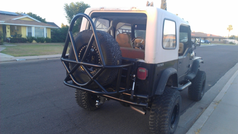

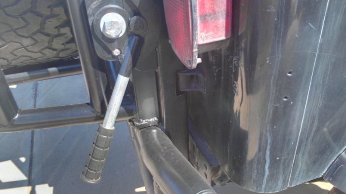

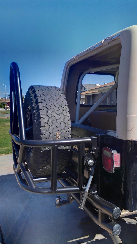

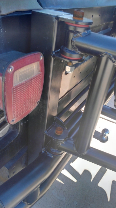

THIS is the tire cage I fabbed for my yj. I attached to my old smittybuilt tube bumper. no connections to the body at all. there was flex in the c-member till I put in the backing plate washers. she's golden now!
ok, finally got the pics sized. i still have other things like a mt.bike rack, and roto-pax brackets i want to fab on it. i don't know yet if i want the hi-lift jack to go back there, or up on the front bumper somewhere?
