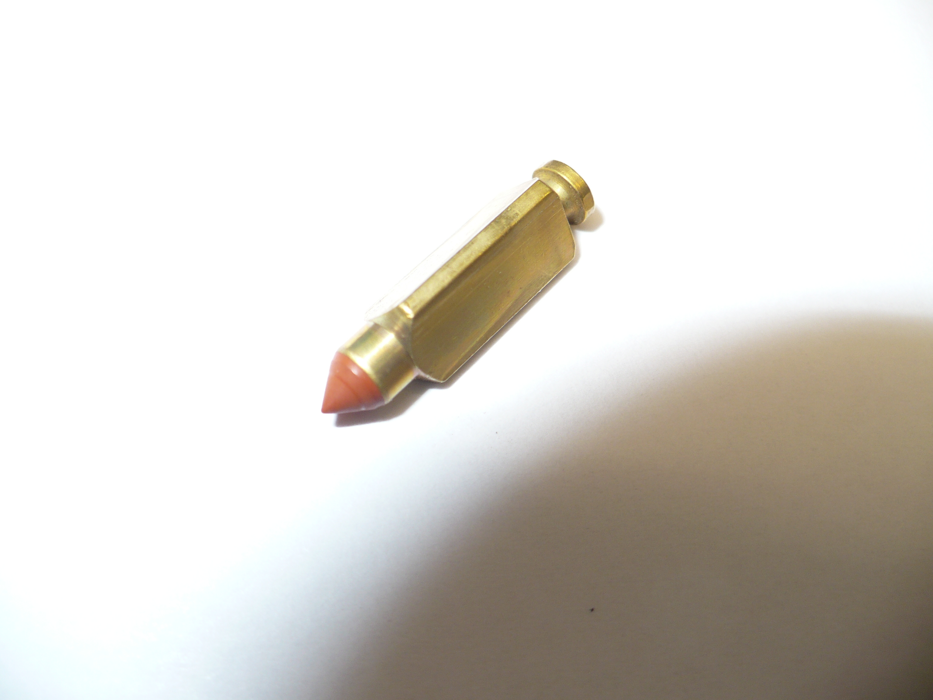

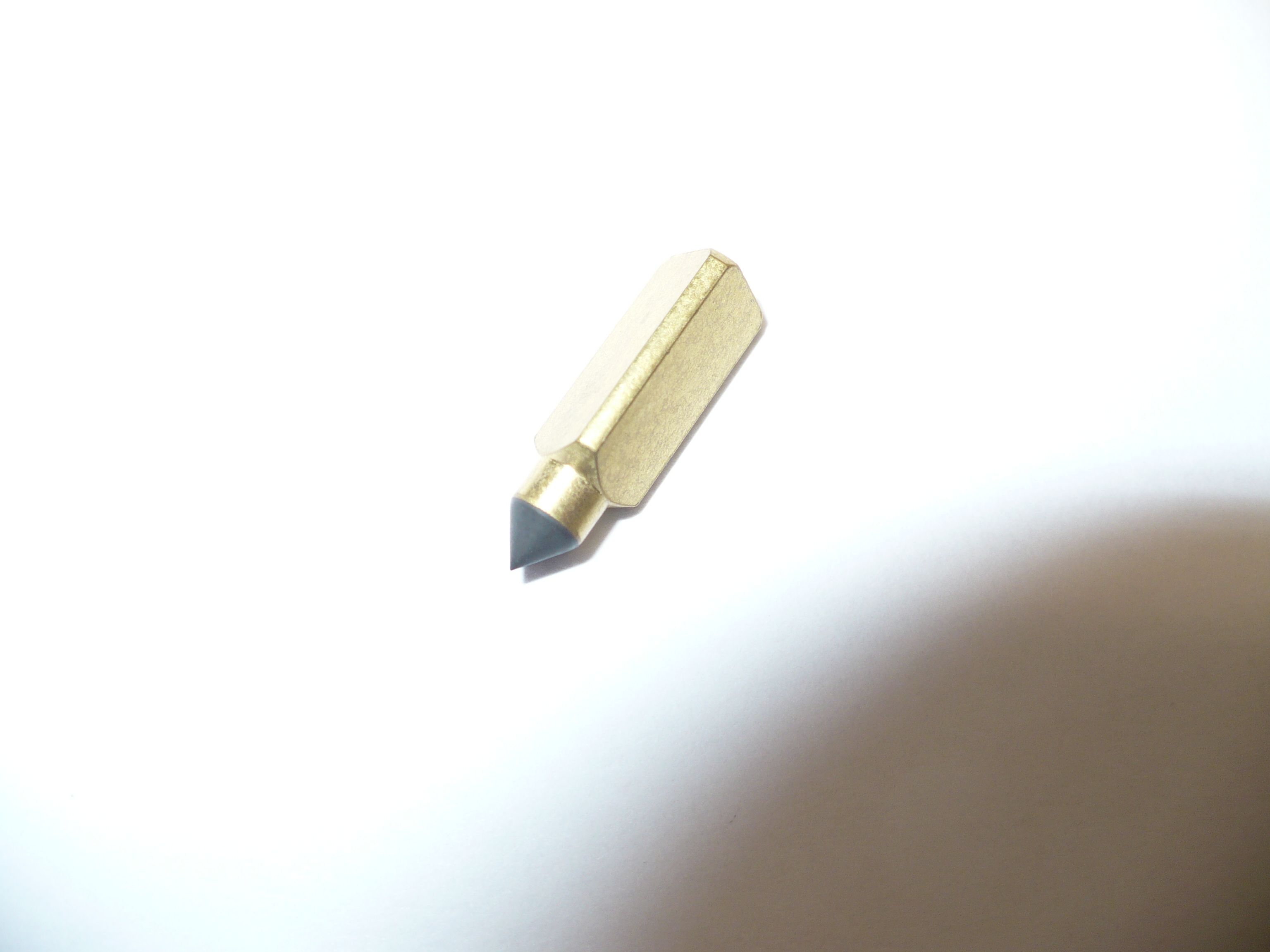

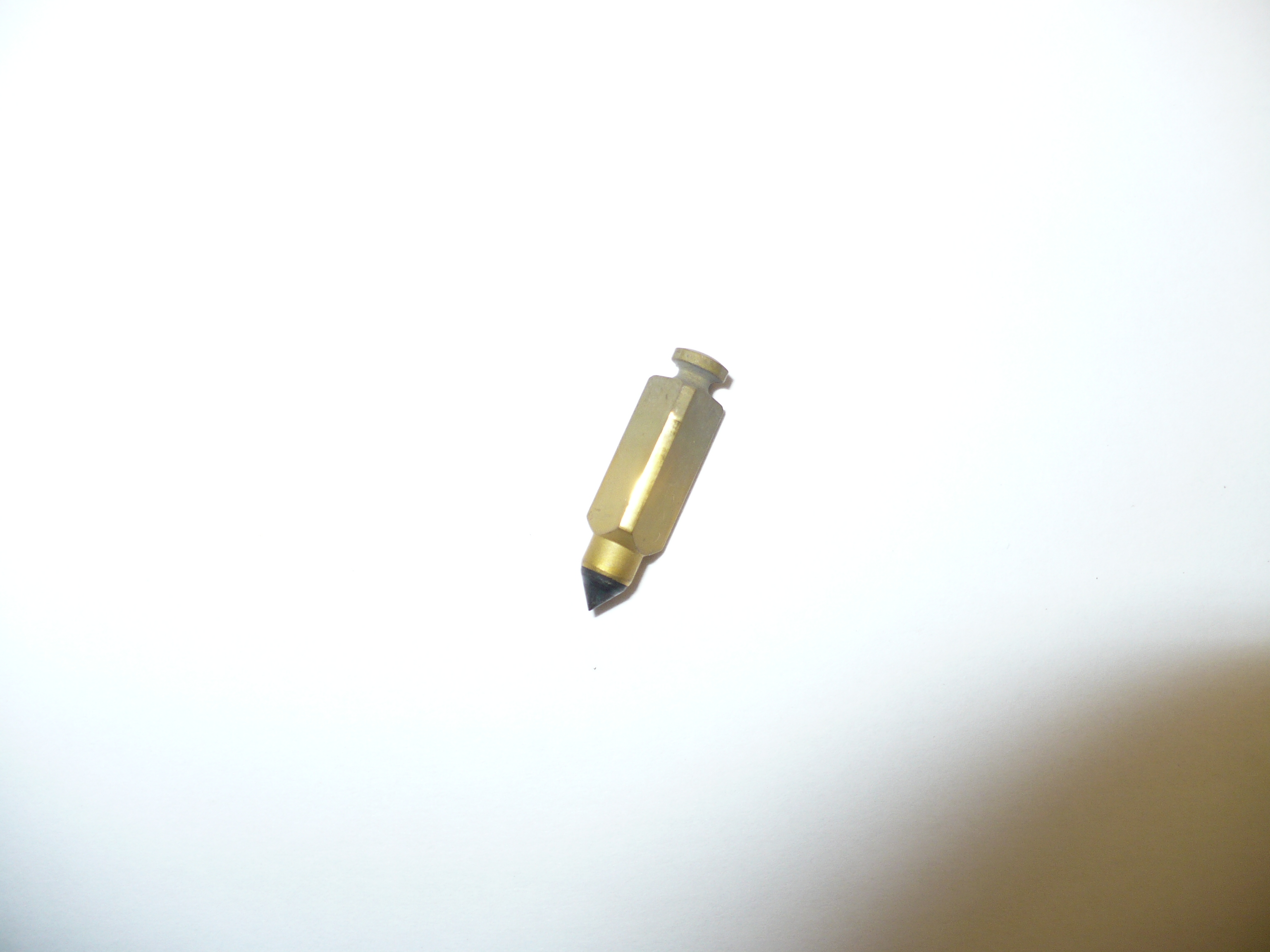

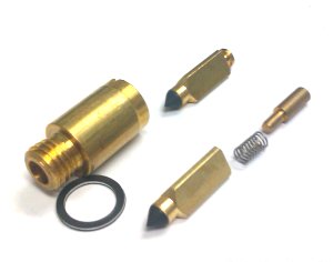

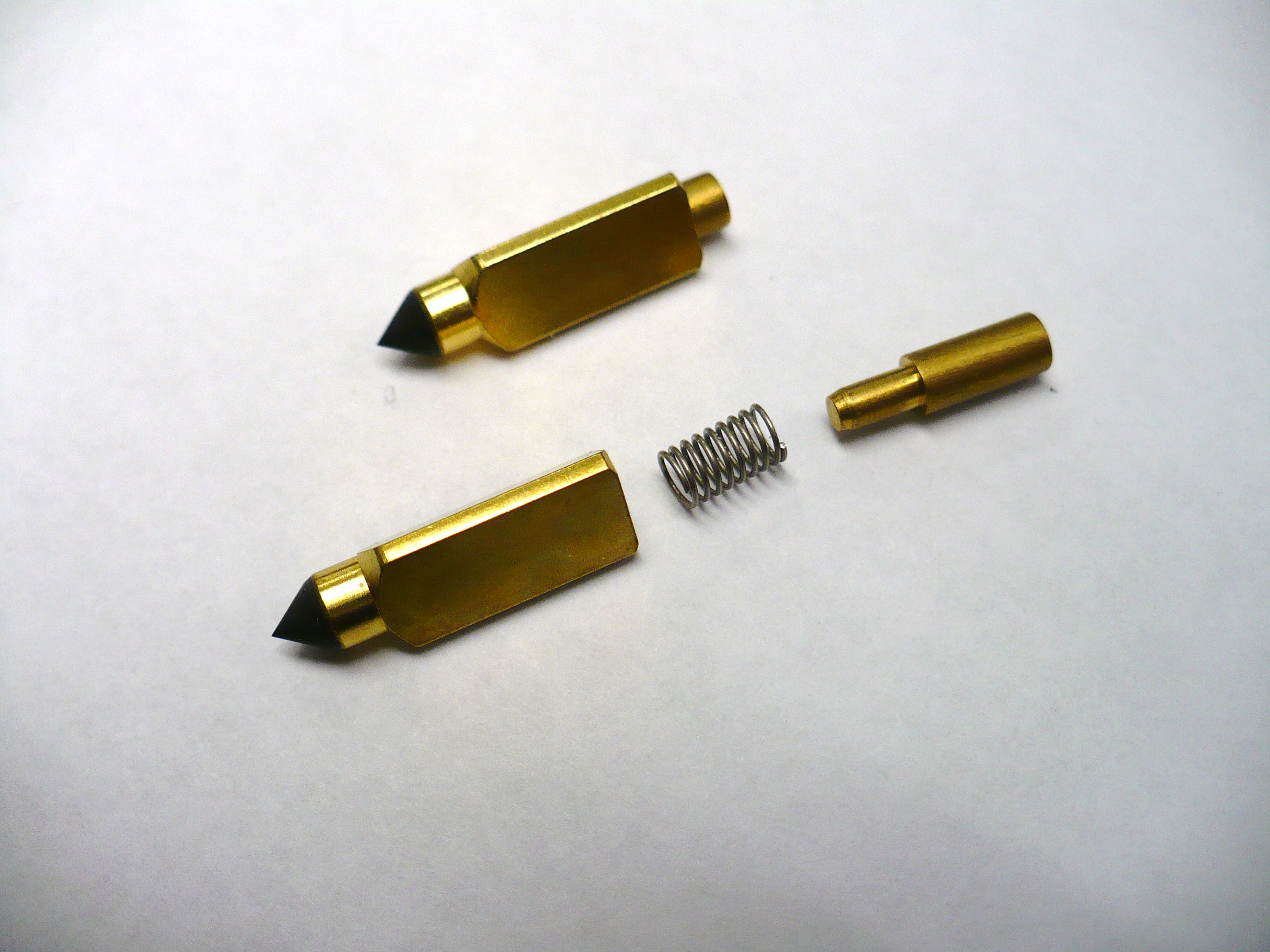

Now, the Echlin rebuild kit I got from NAPA included two sets of Needles (needle and seat) one pair with internal springs and one pair of solid. The instructions mention the spring type are for late model AFB's and the solids for earlier ones. In this process I've noticed these;
that are for Marine and Off Road, are these the same as in the rebuild kit?
I am not sure, so im just assuming. I would think if they say it fits your carb and is the same size then yes.. mine say 110 on them for my holley.
Well, this is what was in the Echlin rebuild kit, they look the same to me.

Now that I've regained my brain and got out of that funk, I had a look at the original installation guide (from '85) and on page 4 the troubleshooting section the first item to check is needle and seat. Looking into my Strip Kit I took note that while the needles appear to have the same tip (save for one pair that are solid brass) the only difference is the float end;

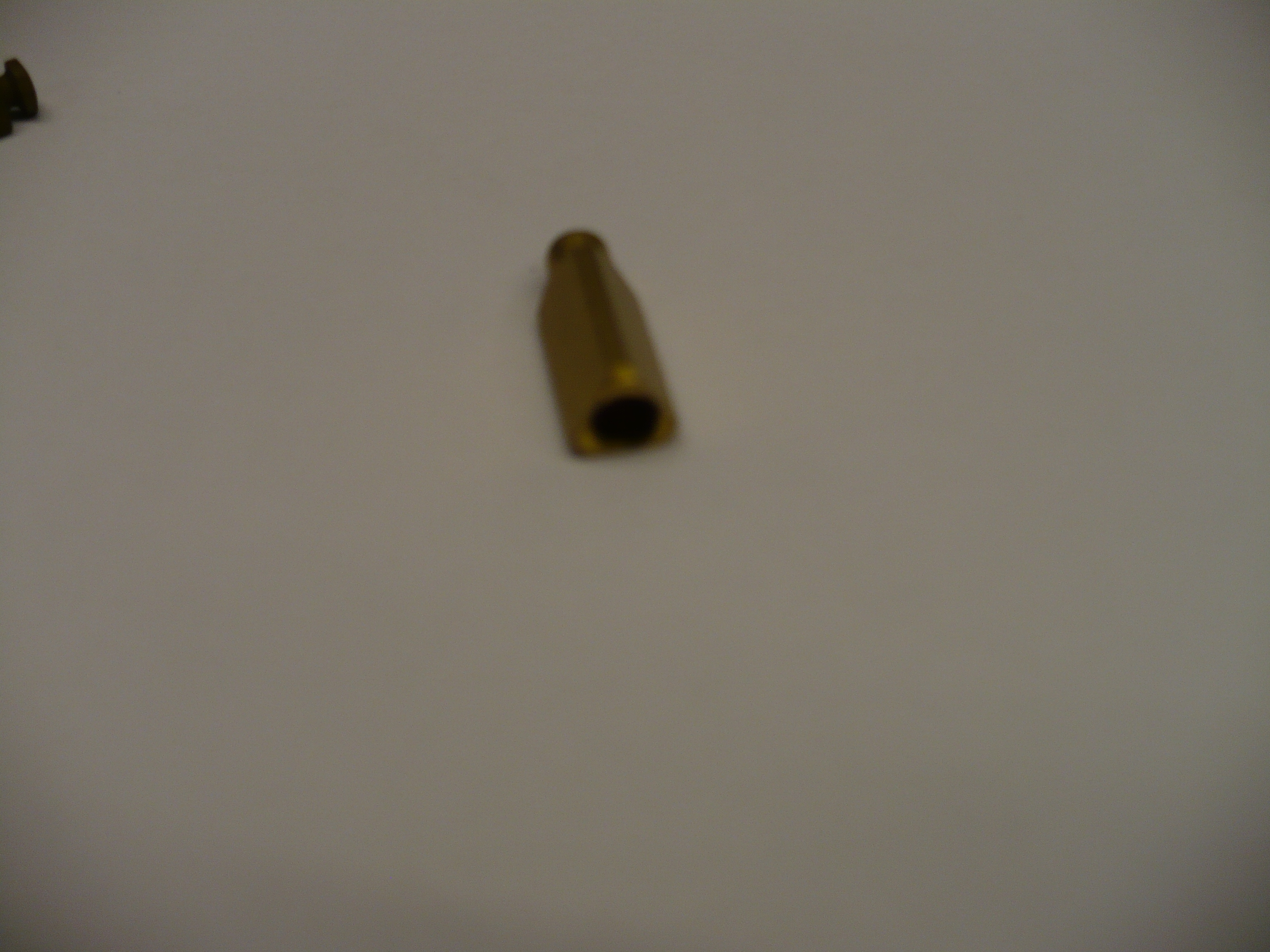

a. was the check valve for the accelerator pump circuit
c1.P1060420.JPGThis one is the internal spring type (Marine/Off Road)?
d.P1060422.JPGNote the red tip on this one

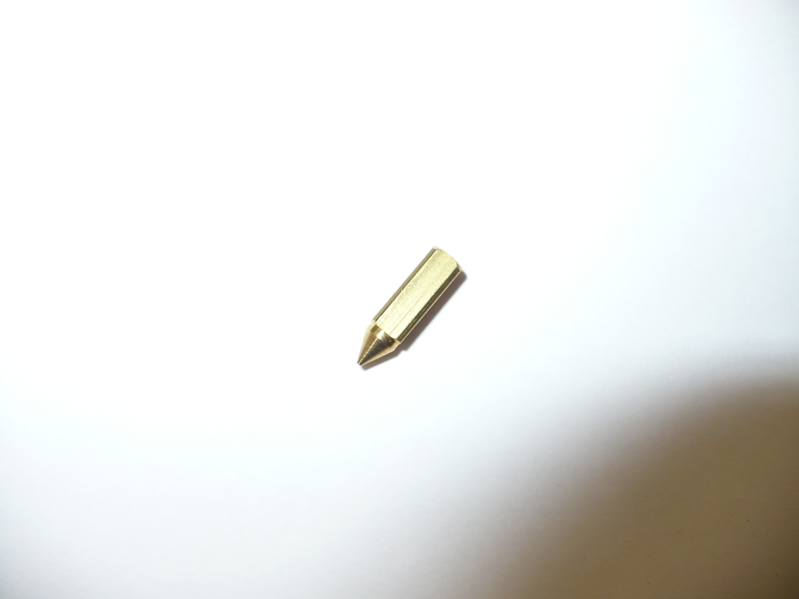

Now where I seem to have gone wrong (unless I'm missing something ELSE) was at the seats where they are metered (like a jet) from what appears (by drill size);
1. 5/32
2. 3/32
3. 13/128???
and 4. 7/64
I have yet to tear into the air horn but I'm betting theres a honkin' large seat in there that's flowing too much fuel. Would anyone have information on the correct size for the flow differences between these for an AMC 304, 360 and 401?

Okay, doing decimal conversions I detirmined that the smallest seat (3/32) is 0.0935 which is a stock factory diameter according to the Dave Emanuel book on Carters (c 1983 ISBN 0-931472-11-3), while what was in this AFB were monstrous 0.1094 another set were 0.1625! I'm reverting back to that O.E. seat in the hopes it'll take care of the flooding. Sidebar this large seat is what came in the Echlin rebuild kit, apparently for a B Mopar. Also I had maladjusted the accelerator pump, now within spec.
Reinstalled the AFB with that small seat and the motor fired right up after fuel reached the carb, I'm hoping now I'm on the right track. Did I turn this 360 into a turn key?
