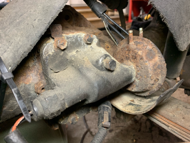

My 4WD quit working last winter on my 94 YJ Wrangler and I let it be for the year and now winters coming around and I want to get it fixed. I went under it and saw there weren’t any lines to be found connecting to the vacuum diaphragm on the CAD and have no clue where the lines would connect from. Any got any diagrams to point me in the right direction ? 62776358327__7B4AF003-8CDB-4854-9B0D-5F36DB27C3B6.JPG

That is EXACTLY right! Thanks terry. Found a cracked suction line that is supposed to kick on when you put it in 4WD so I clipped that and reattached good line and found rusted hole in diaphragm so I bought a whole new setup. Very helpful!
