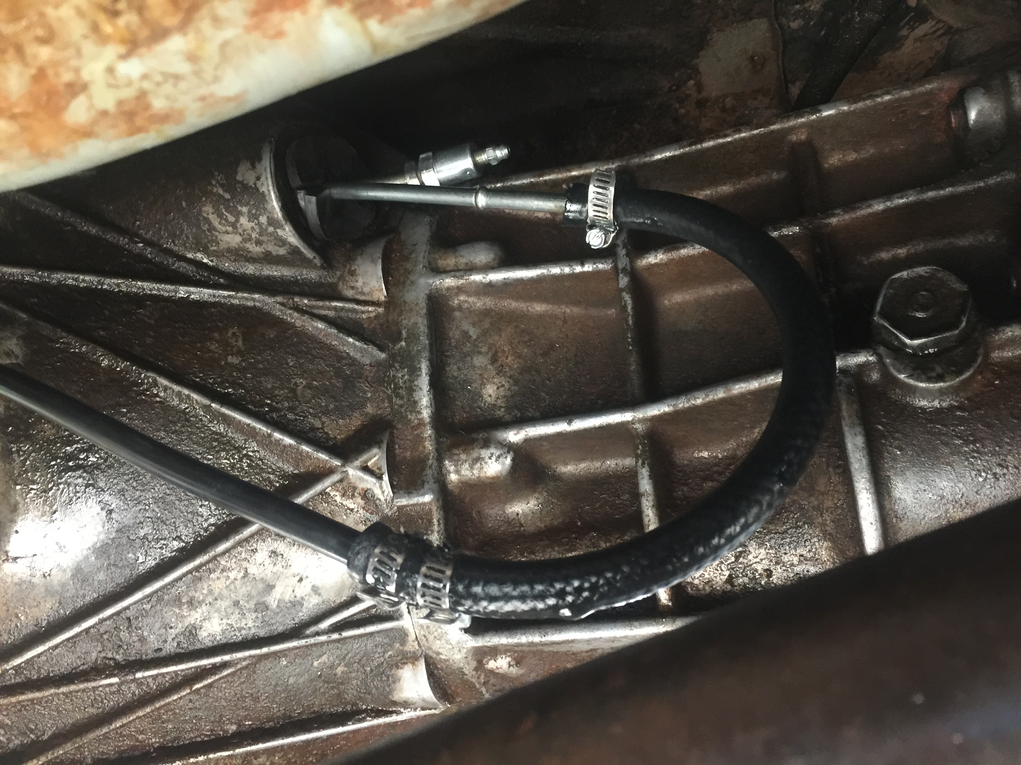

My friend was with me and noticed that the hose underneath for the clutch fluid slipped apart where it had been clamped (where the two clamps are in the photo below). My buddy got it back on there and we pumped the air out and it was fine. Then it happened again later. We repeated, it was fine. He figured he just hadn't put the hose deep enough and we put two clamps this time. On the way home the clutch stopped working again, this time in the middle of me driving, so I pulled into a parking lot. The hose was still attached but the fluid was obviously leaking from somewhere.
We went around asking about parts, found out there is supposed to be a different part of the hose there but they don't make them anymore, which is why the last person probably clamped the hose on. Another friend looked at it and said he thinks it's just spraying out past the clamps.
Somebody told me they think there might be clog in the line which would have pushed it apart in the first place. But if that were true, I'm wondering why it worked fine for a while each time?

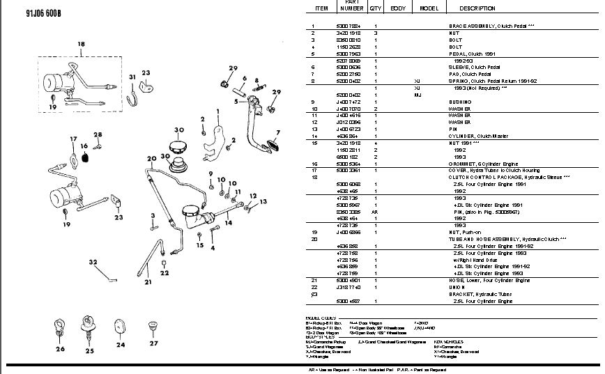

Jeep # 4636859
google it let me know if you find one

Jeep # 4636859
I googled it and found one on the first link for $65 (is that a normal price for such a part?): Flex hose, Jeep; 4.0L; MJ, XJ Series for 1992 Jeep Cherokee 4636859 Safely buy online today - it's fast and easy.
Clicked through dozen or so other links and they all say discontinued part.
I'm also wondering if replacing it will actually be my solution, because I'm still not completely sure what's happening since the line is staying attached now but it's still not working.
The jury rigged hose clamp setup is not rated for the pressure in the line when it is full of fluid. You probably lost most of the fluid, that's why it's staying together. Does the clutch release when you push the pedal?
A good hose shop could make a new line, but you would have remove it and bring it to them. It's just a hydraulic line.
