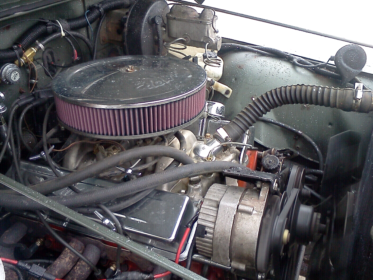

i personaly woundnt put the jeep on the chevy frame !!!!! do the motor swap u will like it so so much better and it will perform awesome here is a pic with a 383 stroker sbc in a cj

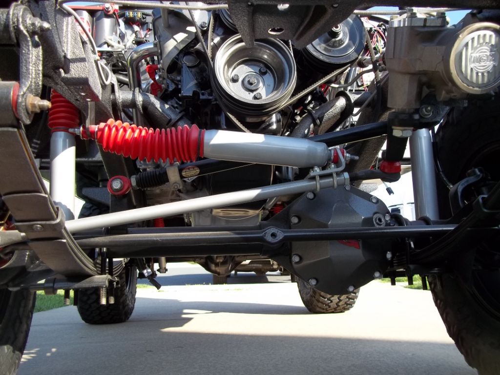

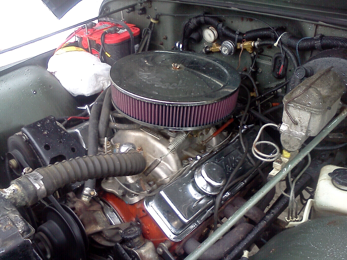

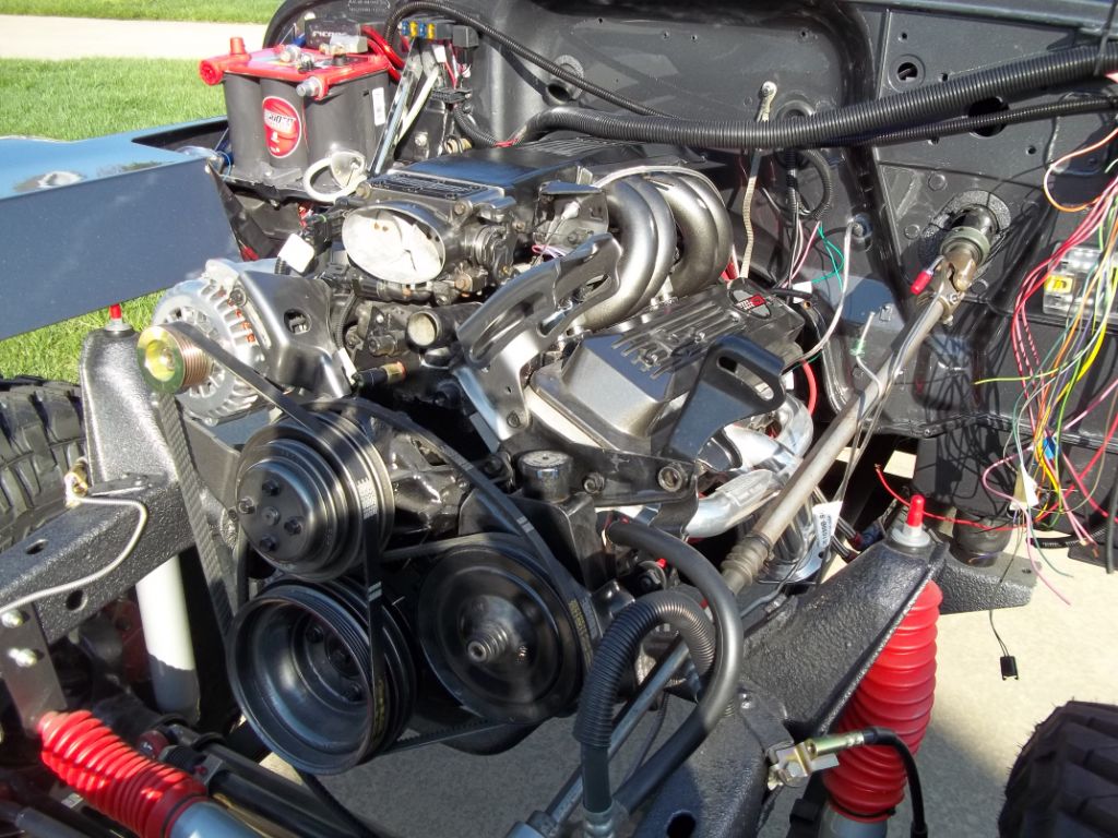

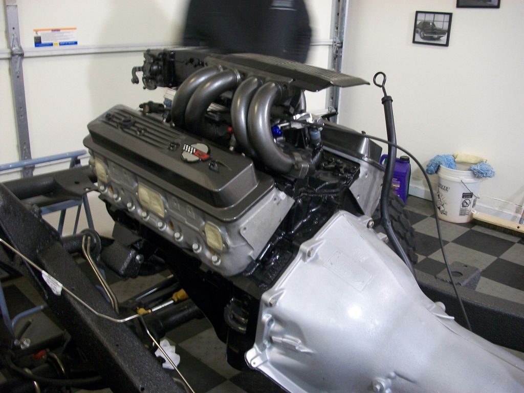

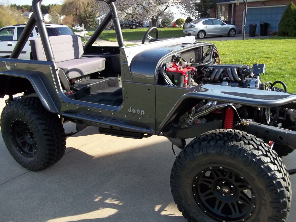

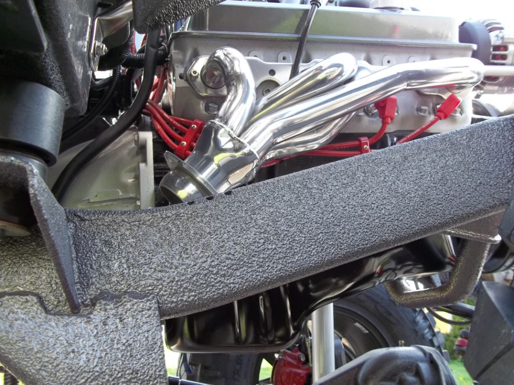

Here's a 91 TPI motor from a corvette ZR1 in a YJ:

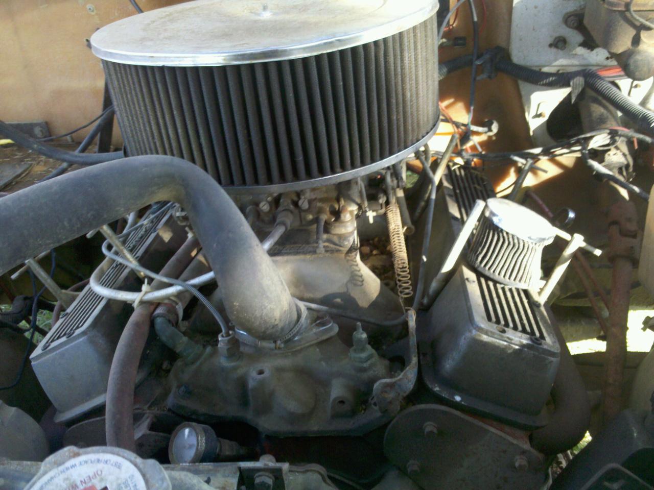

I did a 283 chevy small block and a turbo 350 in my 92 yj and it was simple enough.....
Ooooooooo that's purrdy.......... maybe I can see it out on a trail some time......
Originally Posted by 56cj5
That is effffing sick!!! Great rig!!
Thanx fellas....I'm building it for a buddy of mine...he wanted a "hotrod Jeep" lol....he may do a few small trails....but i seriously doubt he'll topple anything larger than a coke can lol.
