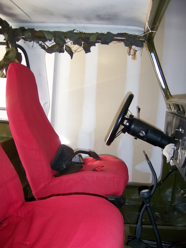

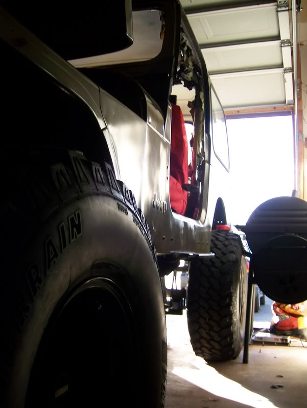

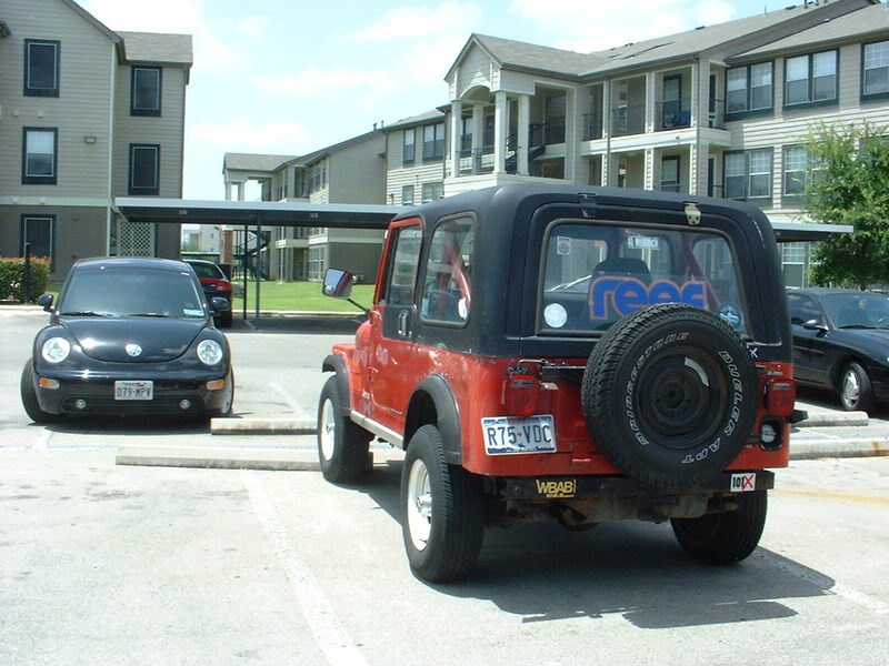

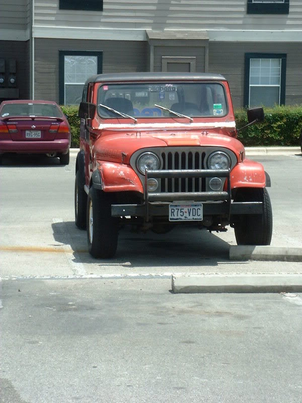

A couple of before:

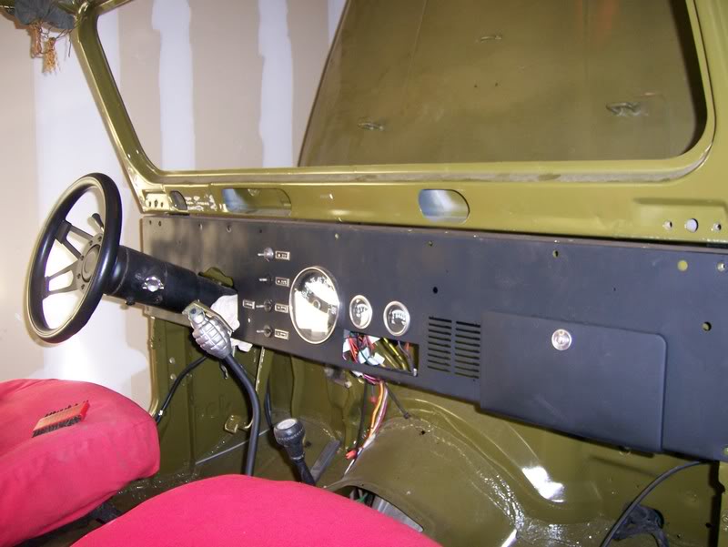

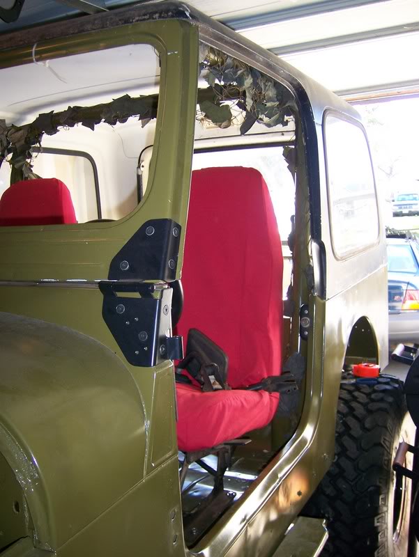

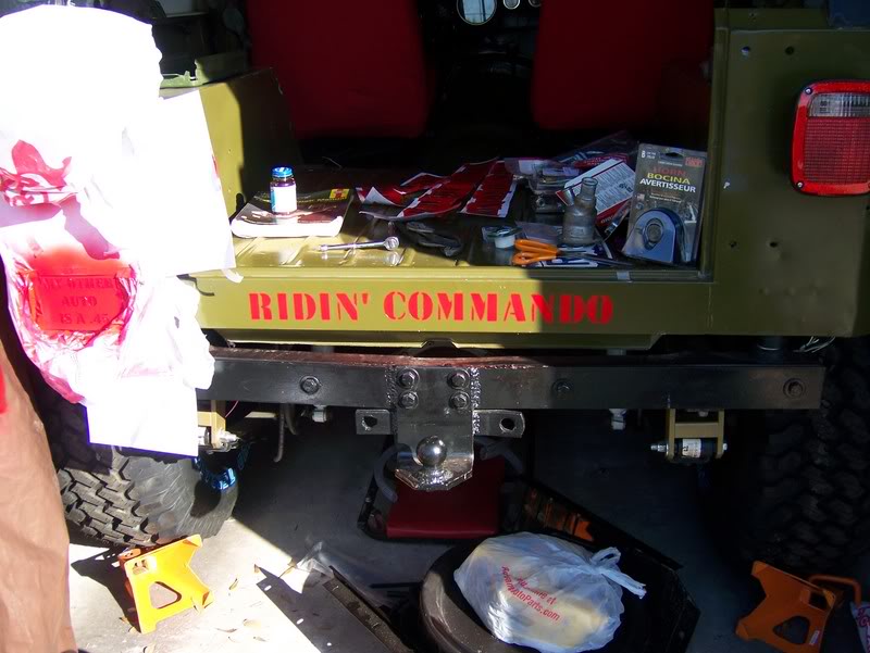

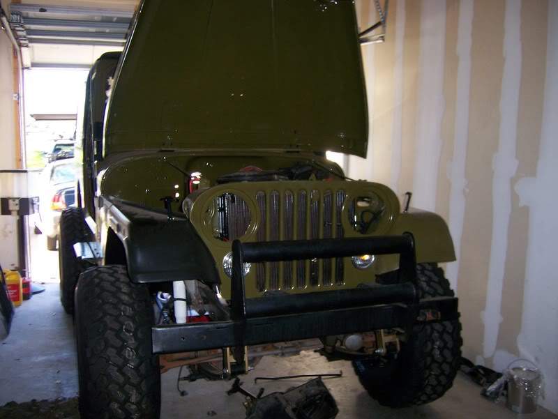

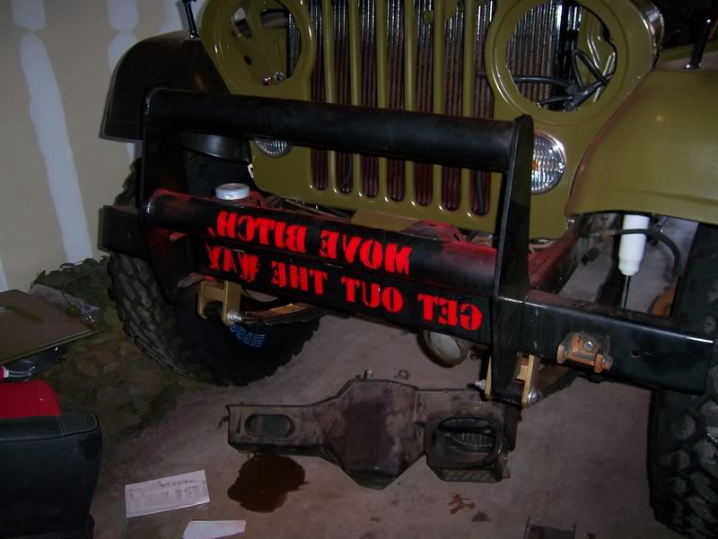

And a few after:
And hopefully she'll be running in a few weeks. More pics then.
