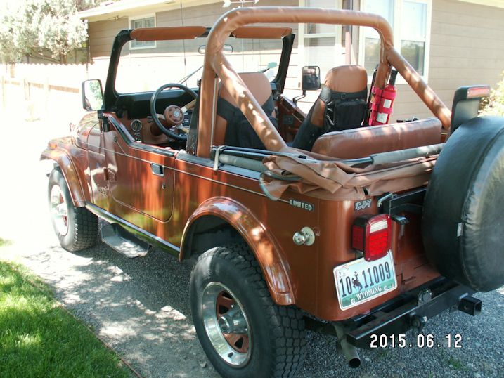

When I removed the cat, and went straight from the manifold to the muffler, my 83 CJ7 was much louder ... I added a glass pack, and it became comfortably quiet. Jeep 6-15 02.JPG
