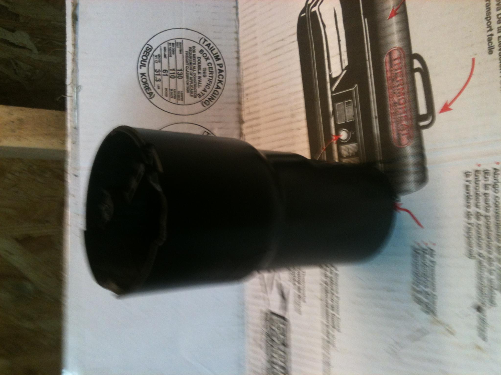

So, in the process of rebuilding my Cj's steering column, I broke the lower colmun shroud (well that's what the Saginaw manual calls it anyway) into about four pieces. It that's plastic cover that snaps into the metal sleeve, the manual says these two parts are one piece but I can certainly tell you it is possible to make it a "two piece" unit. Anyway, that whole piece is screwed into the upper housing (shroud) that contains the lock cylinder and is effectively the cover between the dash and upper shroud. Best part, I dropped it after reconiditoning/during the re-assembly of the column....... Oh, if you didn't already know, it's not just a cosmetic part, it holds a tension spring plate and the key release lever in place :cry:.

Hey Johnny,
I tried to send you the photo on a PM, but the system is not letting me upload from my files. This is the part. the upper half is plastic which is what broke.
