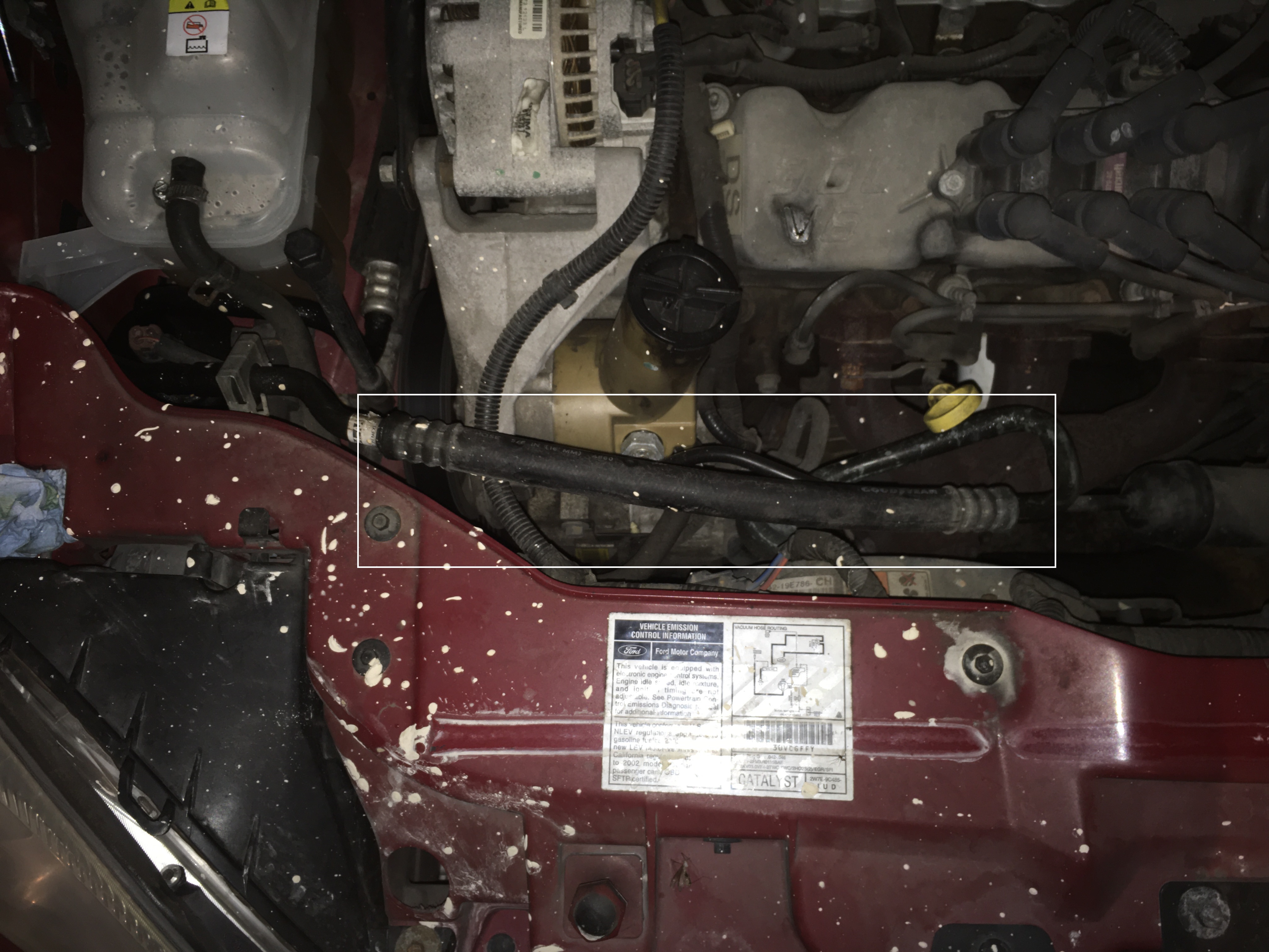

I have an '02 Taurus with 85k miles on her that I just bought. Today when I was checking something under the hood I noticed this metal line cold and dripping with water...
I had the air on but turned to the position of arrows pointing out of the dash and floor vents only. The defrost or a/c function was not selected. It seems to be doing it consistently. I haven't traced all the parts of this car's a/c system yet but I don't know of anything else under a hood that turns cold and sweats. Why would my compressor be working when it's not selected? What tests should I run?

I've since been told Ford designed it to turn on in the mode I was running it and the only mode the compressor doesn't come on is the floor only. Who knew.
