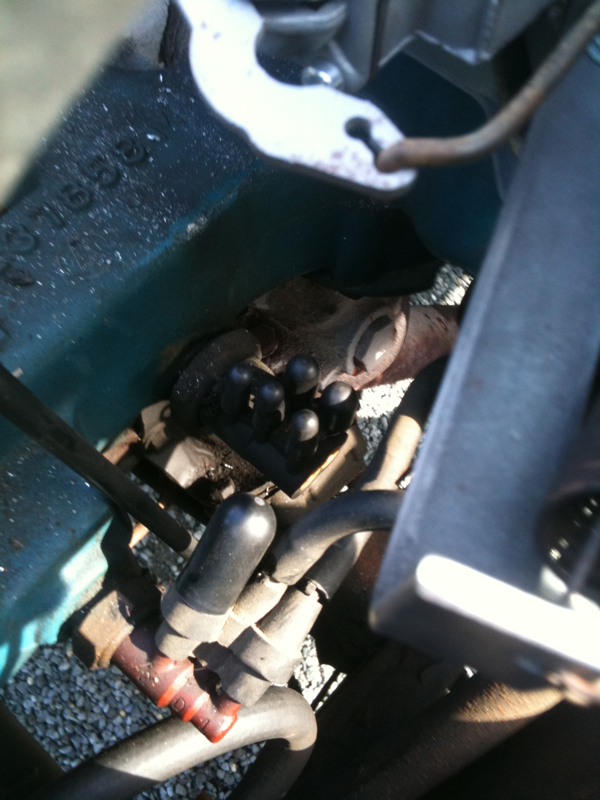

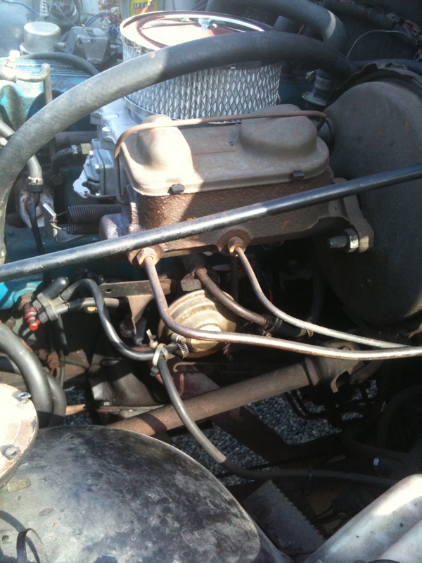

Hey superj, I just removed the web of vacuum hose and took her for a spin. Seems as though the brakes are weaker. Could this be or is it in my head? Here is a pic.

Did you disconnect the one to the brake booster? It's the fat one from the end of the intake, under the carb. Also, is your distributor advance still hooked up?
If you are doing the nutter, you are right in the wiring you were modifying
Brake booster and line untouched. Dist vacuum hooked up. I just removed and capped the plug with 5 ports. I also changes pcv to single output which goes to charcoal canister and is now in the rear of the valve cover. Front of valve cover has a breather. It's probably on my head. Braking always sucked on this. That's my next project.
