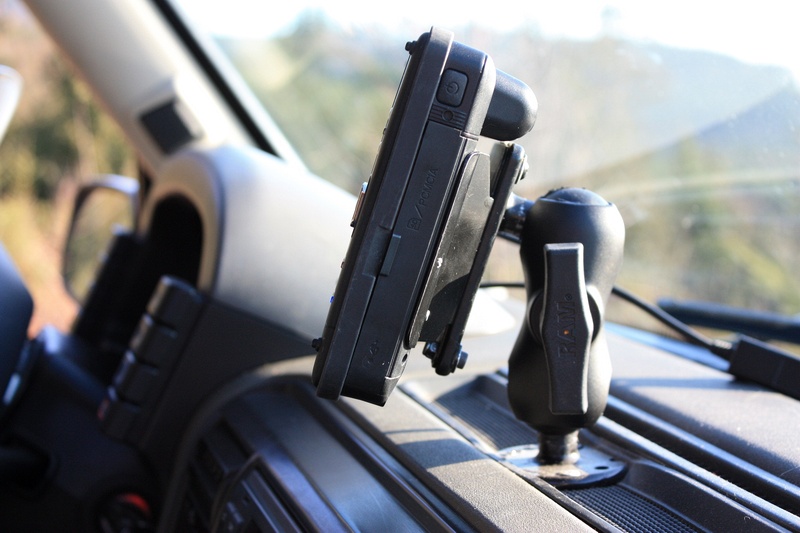

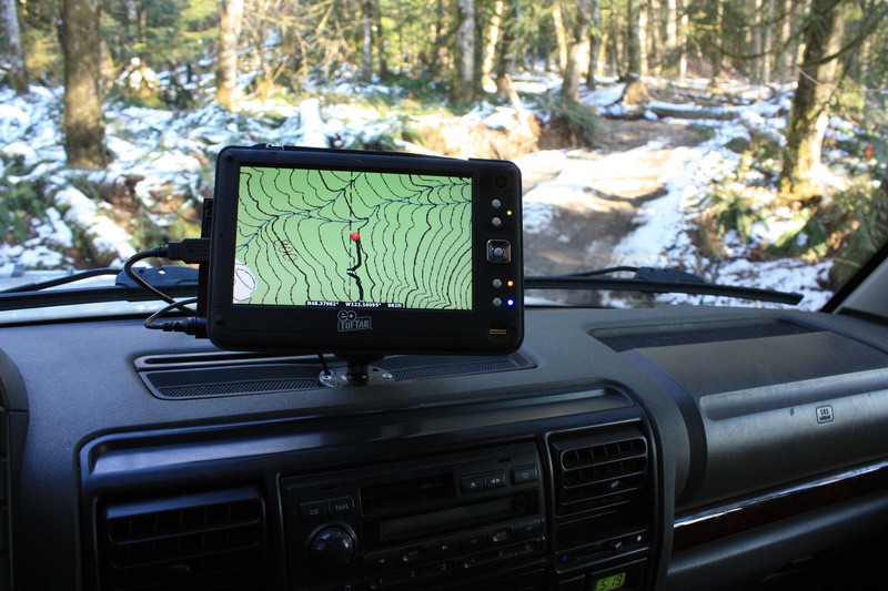

I've run a carputer in my truck in the past and am running a semi-ruggedized UMPC with a sunlight visible screen now. The UMPC is as easy to install as a regular GPS (Ram mount, bracket, 12v DC power, and UMPC). I like having the extra functionality and mostly the larger screen for reading maps.
Because nothing else existed, I decided to make a touchscreen friendly topo mapping package that I'm now selling. This is my first post, but if anyone is interested, and it's OK with the admins I'll post a link.
Craig

I sent a message to the Admin but haven't heard back. We're sponsoring the site now, and I'm pretty sure it is of interest to anyone reading this thread... so, here's the blurb, a link to the video, and a couple of photos.
Overland Navigator turns any Windows netbook, laptop, tablet, or UMPC and a cheap GPS puck into an easy to use offroad mapping system. Rather than create tracks/waypoints and download them to your handheld GPS, Overland Navigator is designed to be used in the field as the GPS.
* USGS topographic maps are rich in detail. More than just roads.
* Maps are seamless and automatic
* Record GPS tracks and waypoints
* Ideal for netbooks and UMPCs - Uses the entire screen
* Touchscreen, mouse, and keyboard compatible
See the "Testimonials" section of our website for example installations (still need to add the Jeep examples).
