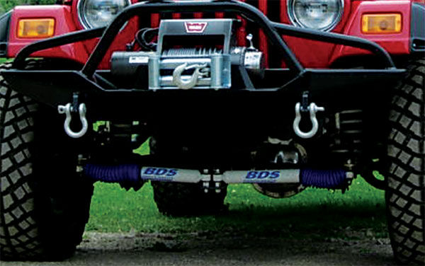

So, I'm getting the ORO U-turn steering system and I'd like to put dual steering stabilizers on it. Anybody have any good ideas and suggestions. I can't find any right now.

That's a nice setup, i just dont understand why you need a dual steering stabilizer with 31" tires. Isn't that a bit overkill?

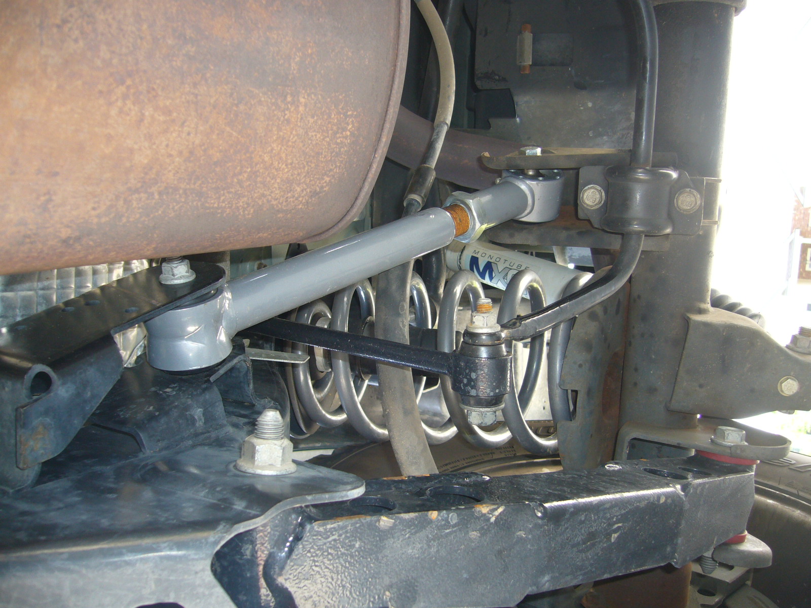

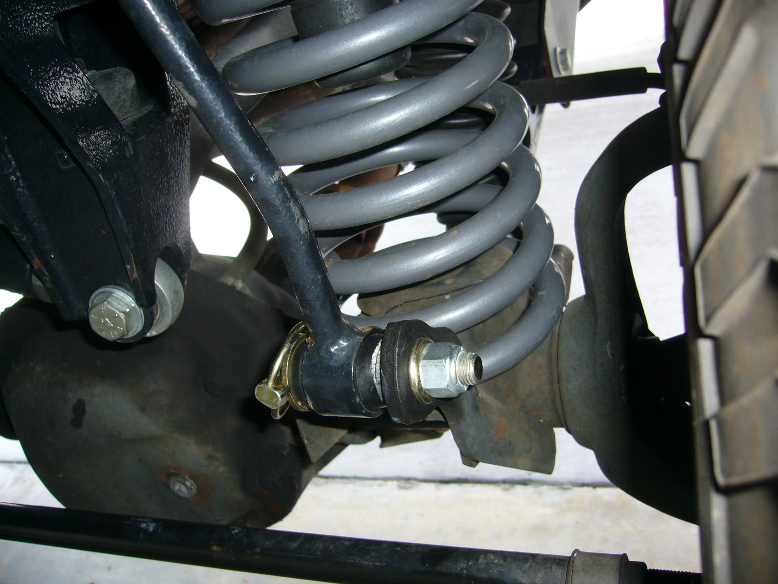

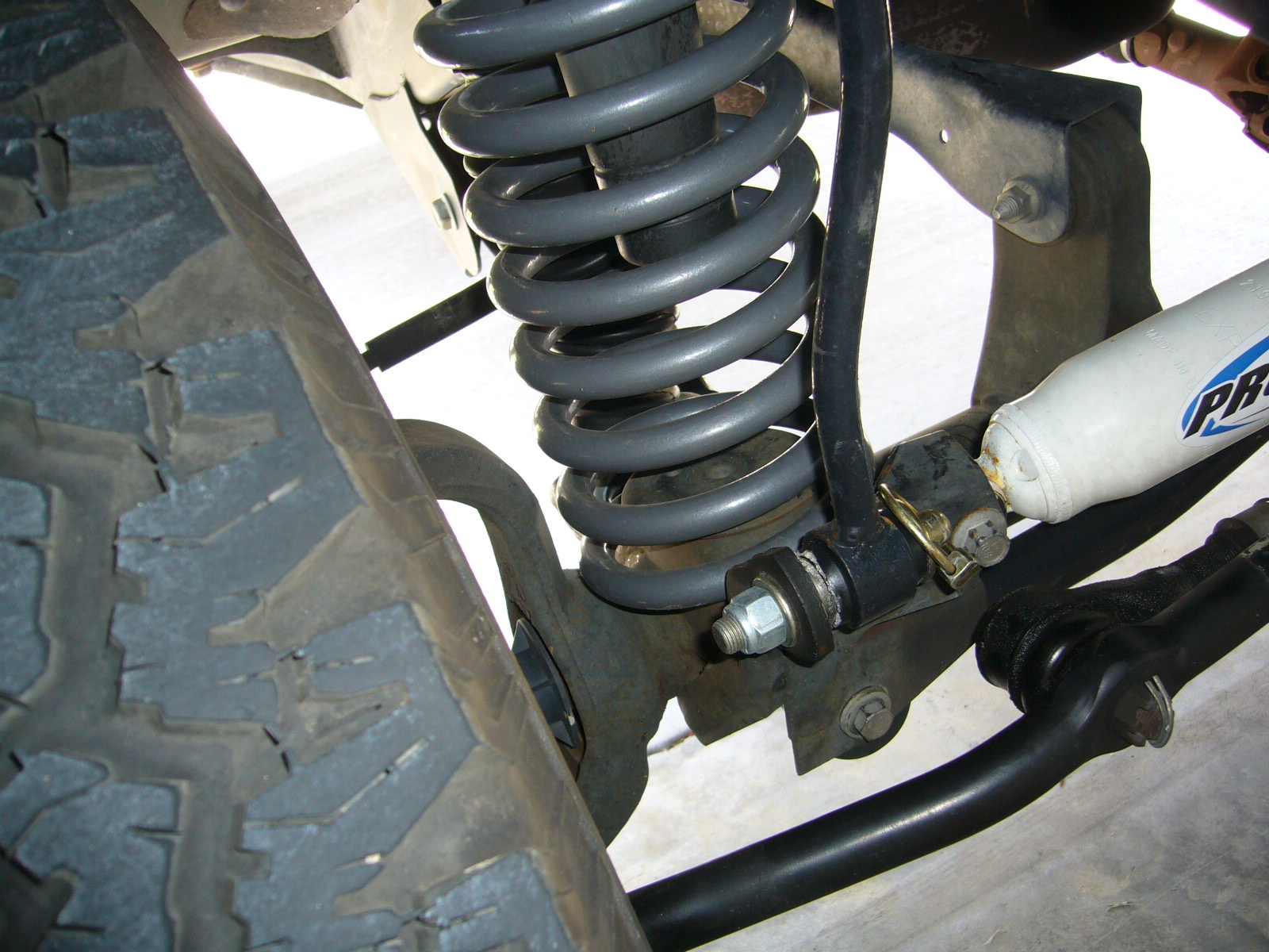

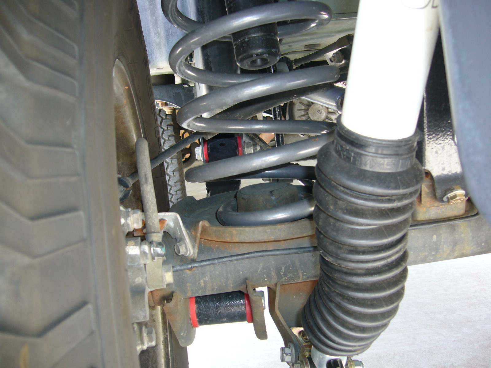

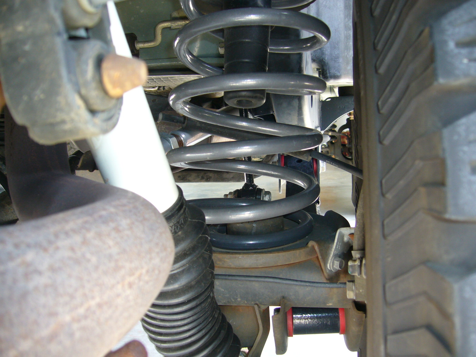

passenger Front Coil spring is 1/2 less the driver and the rear passenger is less than a 1/4 in than driver here are some photos. Also the front right and left coil butt up against the bottom and seem to be in place.
