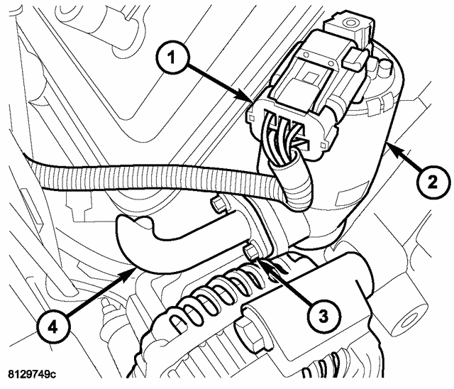

Looking at changing an egr valve on a 05 gand cherokee for a friend. Does anyone know how hard this is or have a diagram?
The electronic EGR valve and solenoid assembly (3) is attached to the front of the right cylinder head (1). An exhaust gas routing tube connects the EGR valve to the intake manifold.
  1. Disconnect electrical connector (1) from EGR solenoid (2).
  2. Remove two bolts (3) connecting EGR tube (4) to valve assembly.
  3. Remove gasket located between EGR tube flange and EGR valve assembly.

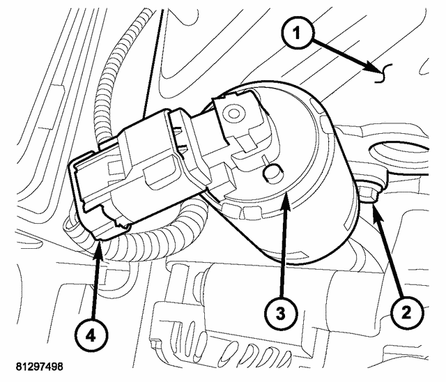

  4. Remove two mounting bolts (2).
  5. Separate valve assembly (3) from cylinder head (1).
  6. Remove and discard metal gasket located between cylinder head and valve assembly.
