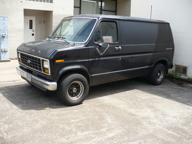

5801885688_3865776141_z.jpg Thanks for your detailed response jfrabat. This light system is actually for my other rig 'Easy Bake'. The Hella H4 shells have been on 'er since 1995 and since they've been working fine (except for those Wagner bulbs I was referring to) I'll stick with them until they become untenable, rather than pitch 'em for the HID.
