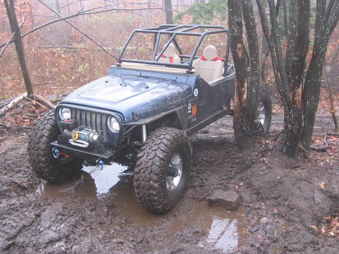

as for the 2.5, this TJ is one that we just finished
Jeep has 3.25" of total lift over a stock TJ, tires are 42" comp stickie Iroks, axles are CUCV axles with stock gearing of 4.56:1, has a 5.0 atlas and a bone stock 2.5L. on the shake down trip and two runs it has been on, jeep does very well in the rocks and on technical obsticals. we've driven this as high as 50 mph on "go -fast" trail and it is very stable and has the power, but if it was to be daily driven, it would not be Ideal due to the lack of either horse power, or gearing...
That said, this rig was built with Ultra 4 in mind (probably will never enter a competition) so a motor swap is coming soon either 5.3 or LQ9.
