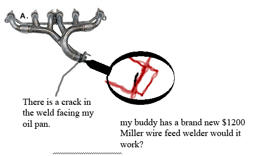

exhaust leak on header weld facing oil pan...
YuriSouder
Can i weld this Kind of metal????????
What kind of metal? Is it an aftermarket header?
Either way yes you can certainly weld it, but for the best weld you'll want to find out what metal it is.
