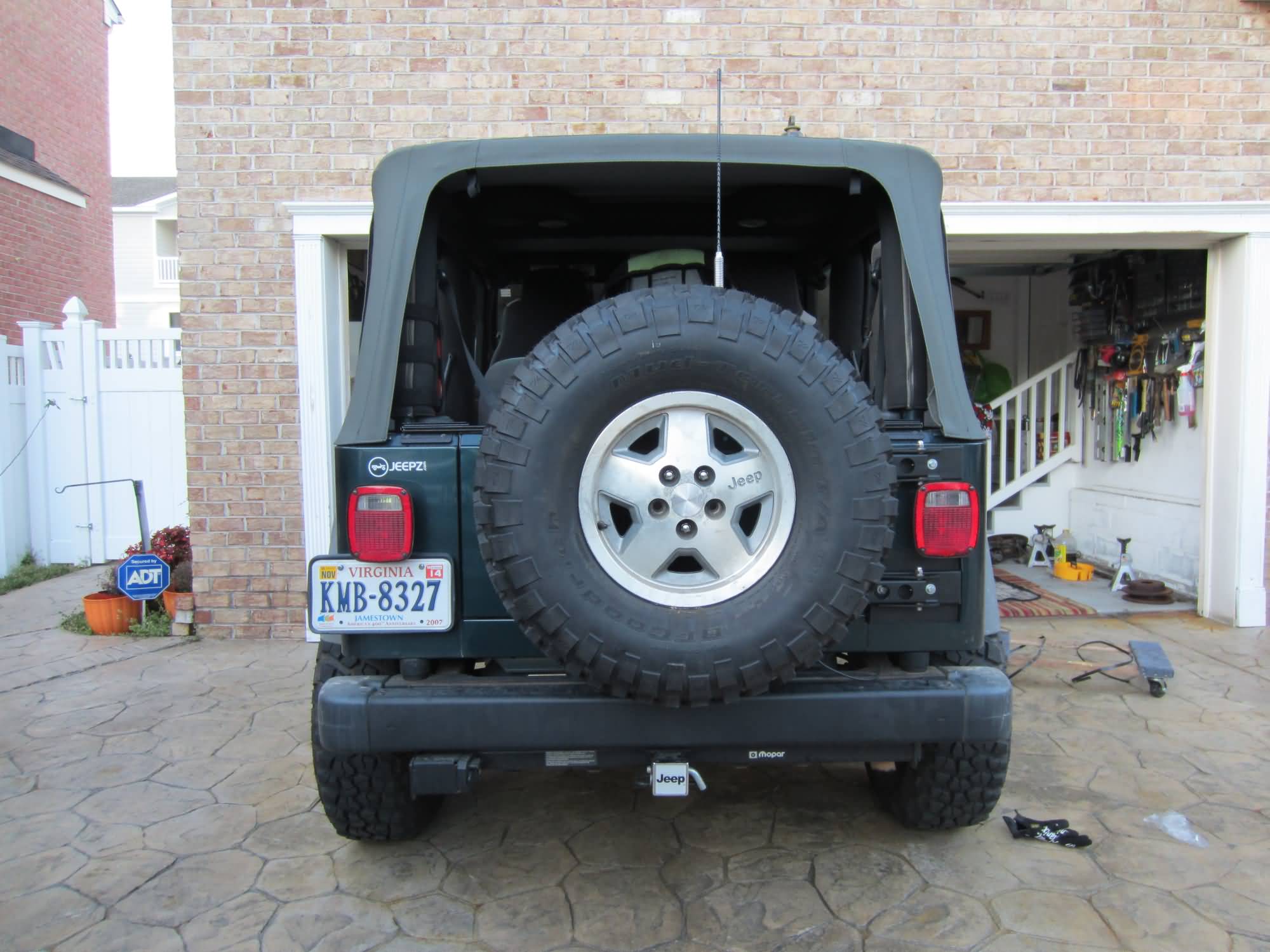

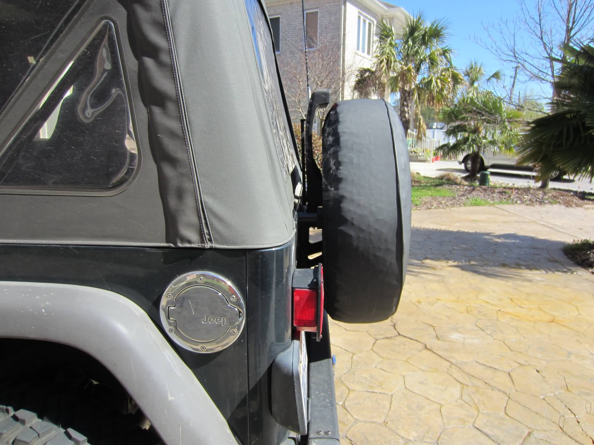

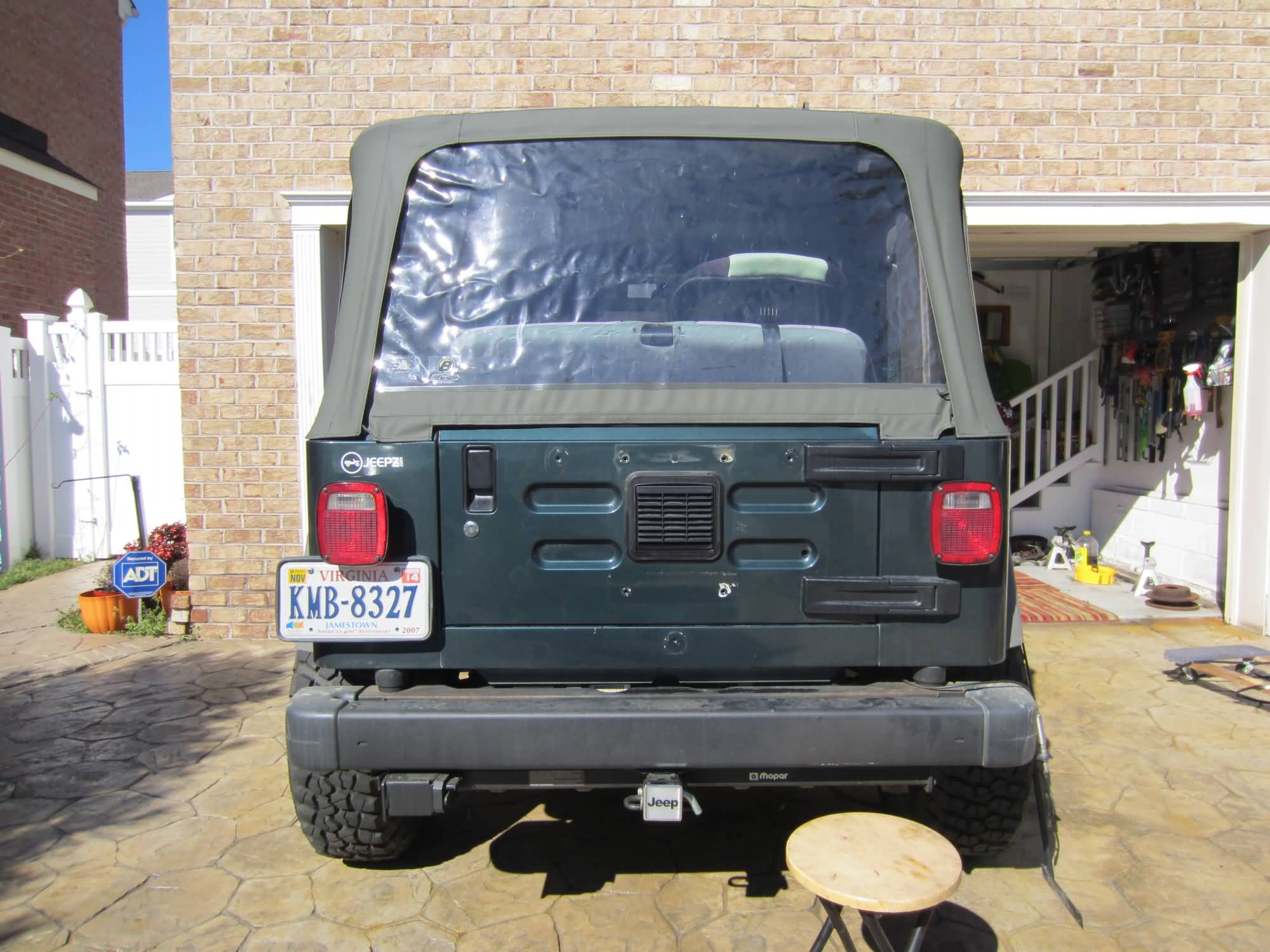

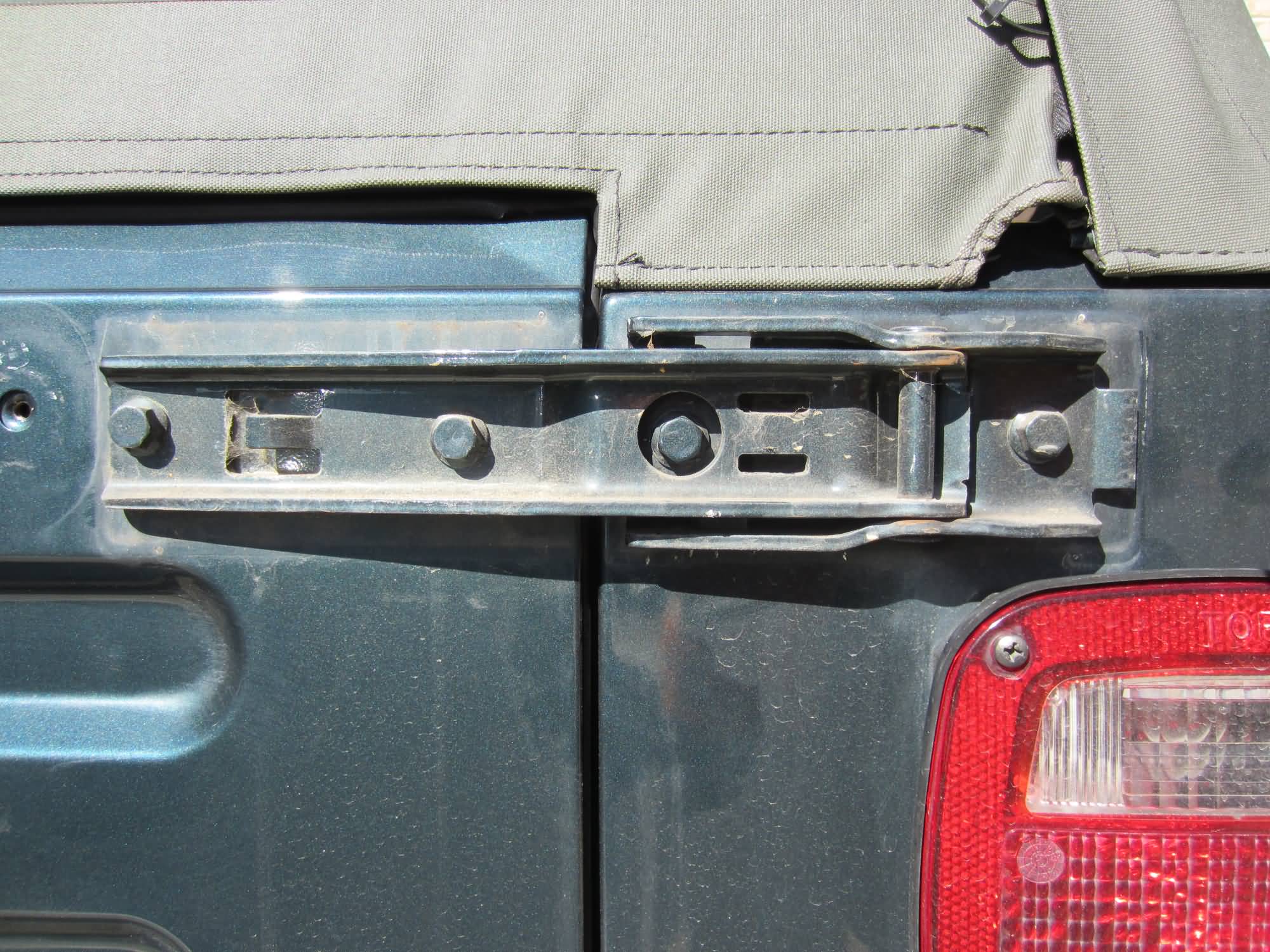

Stock Jeep TJ:

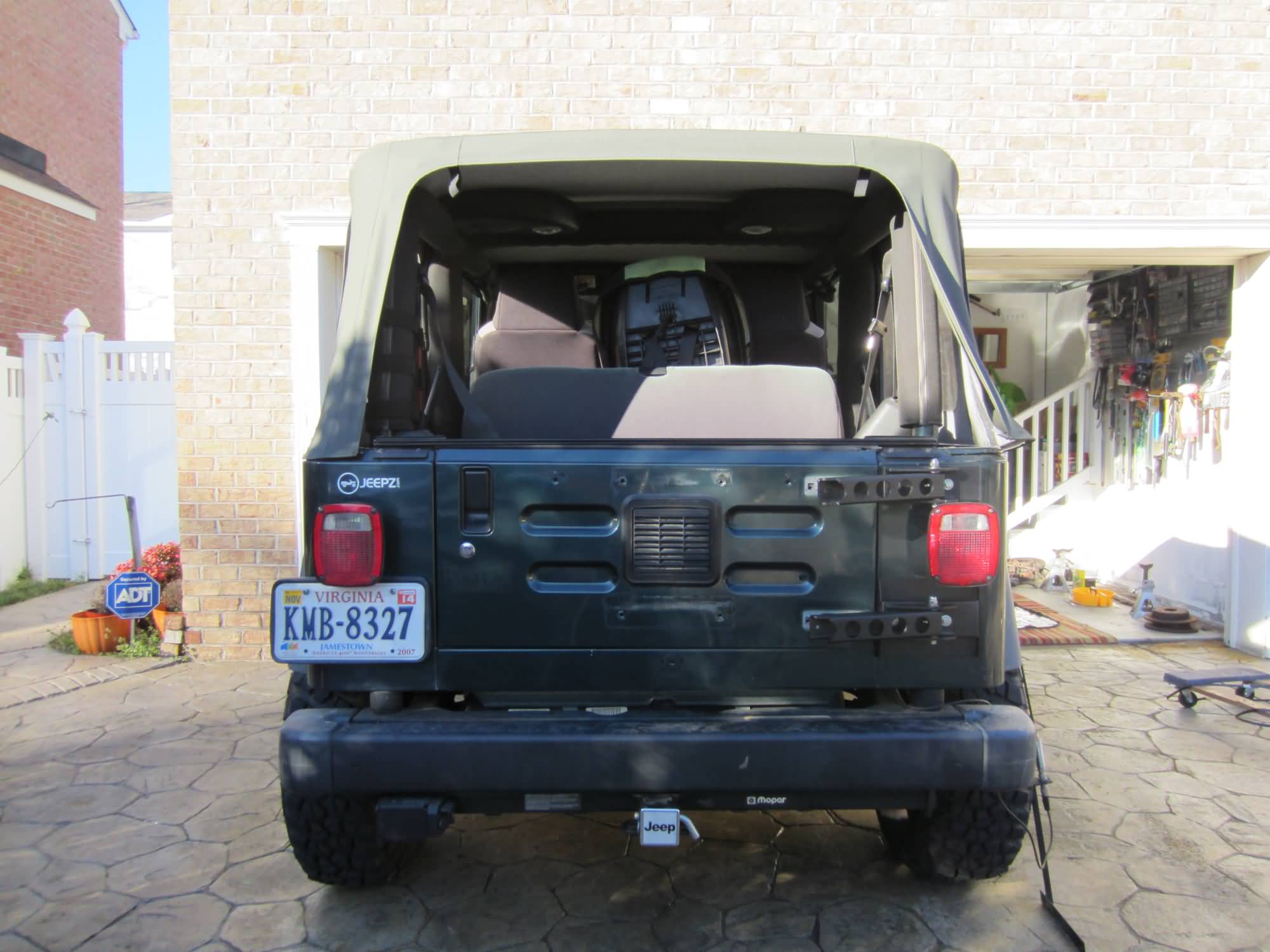

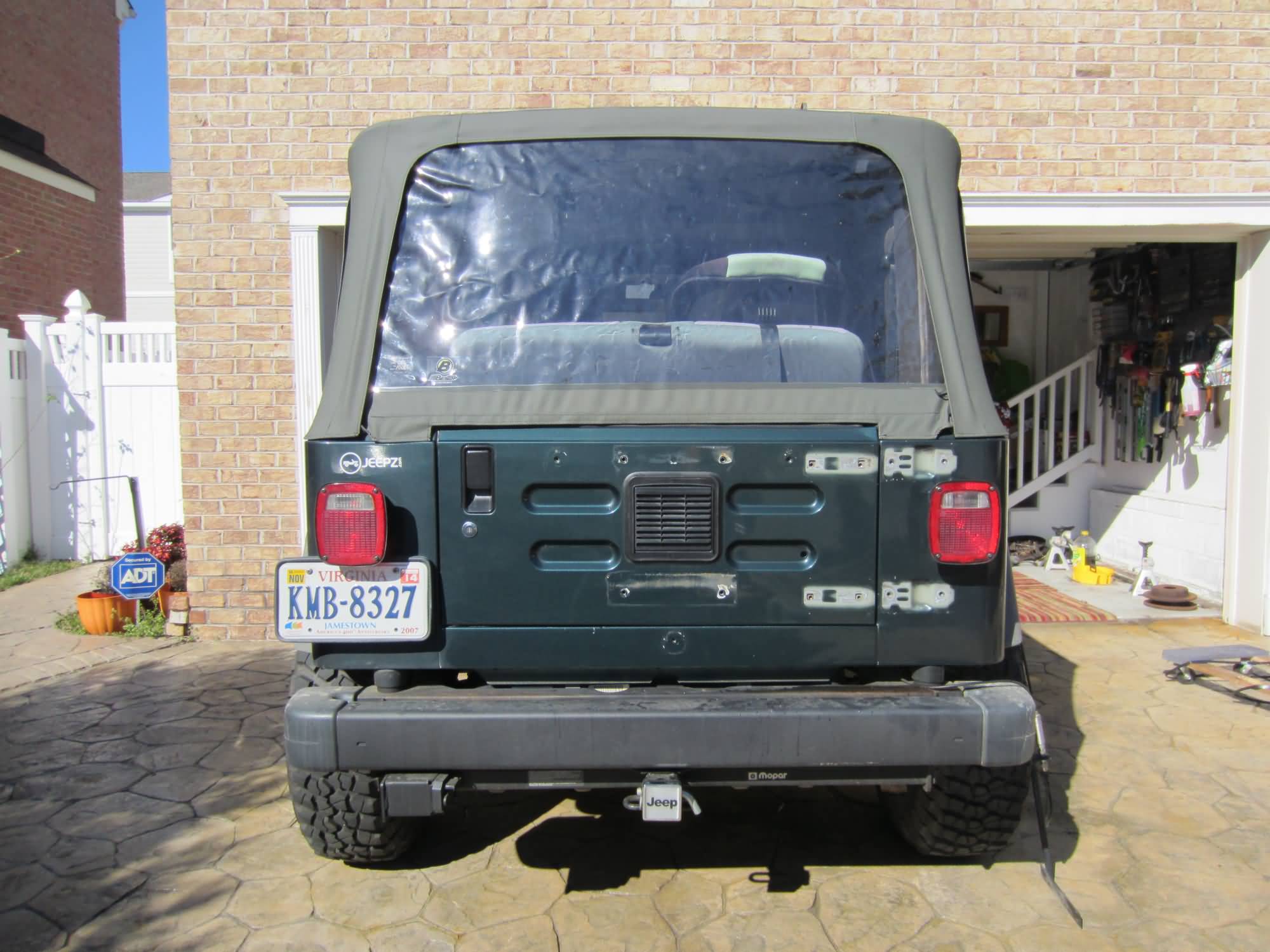

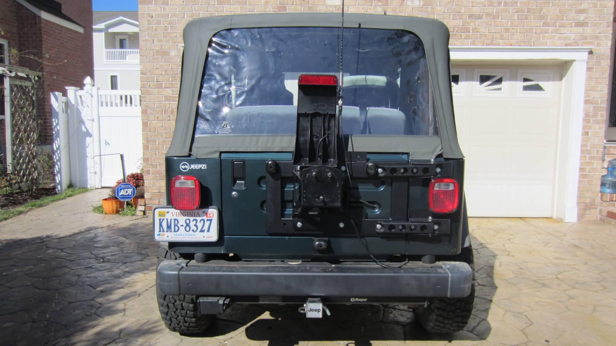

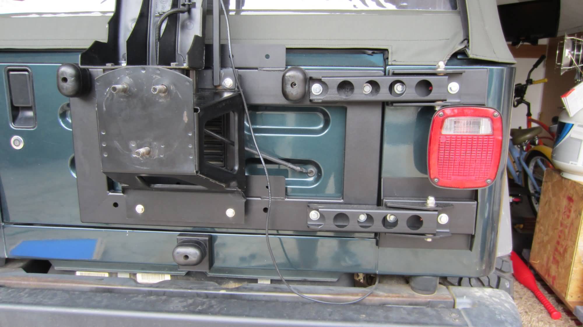

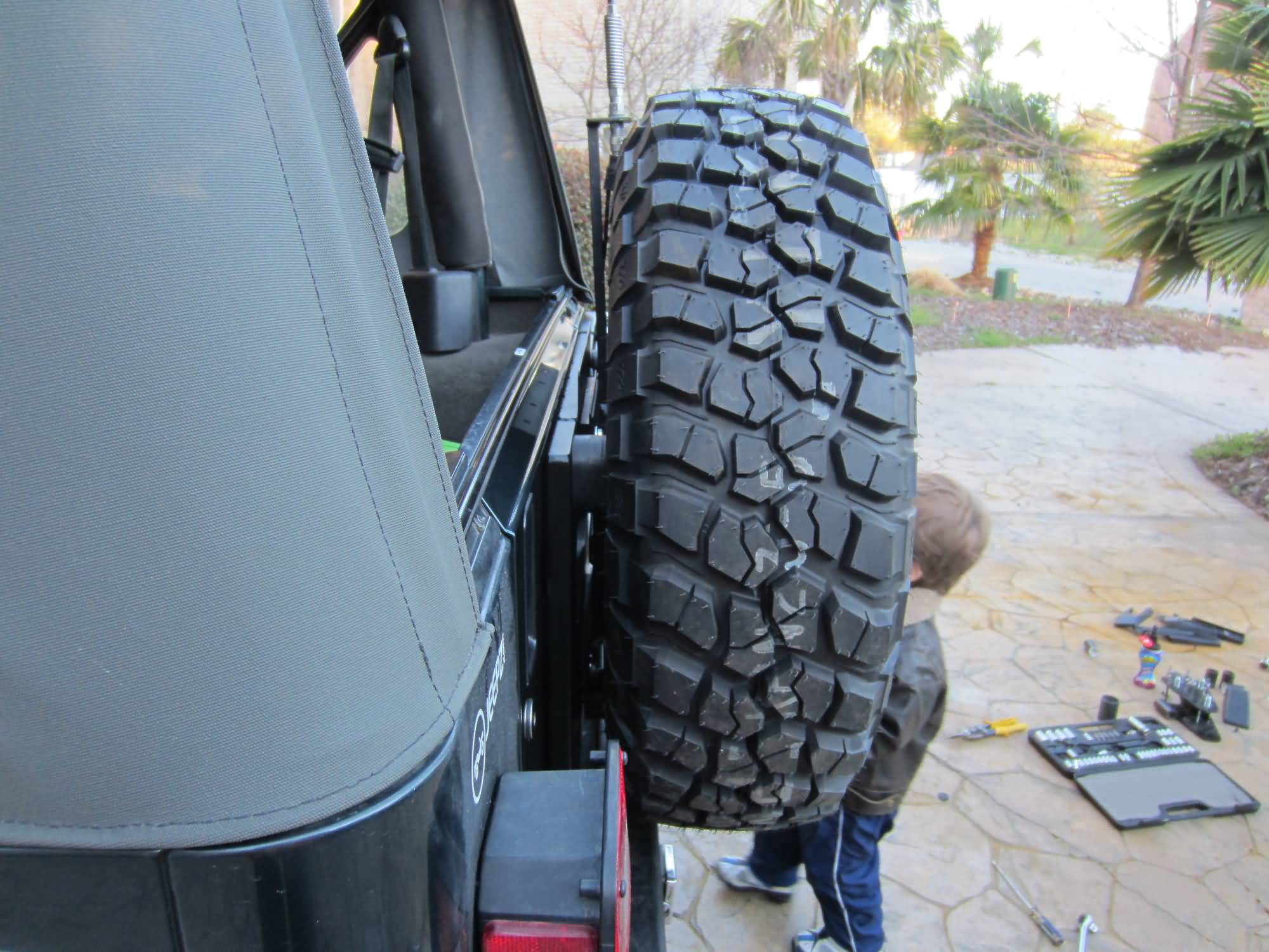

With the Exogate installed

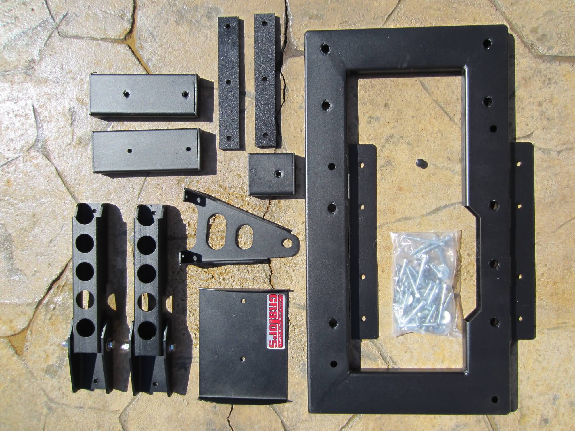

Here’s the complete Exogate kit:

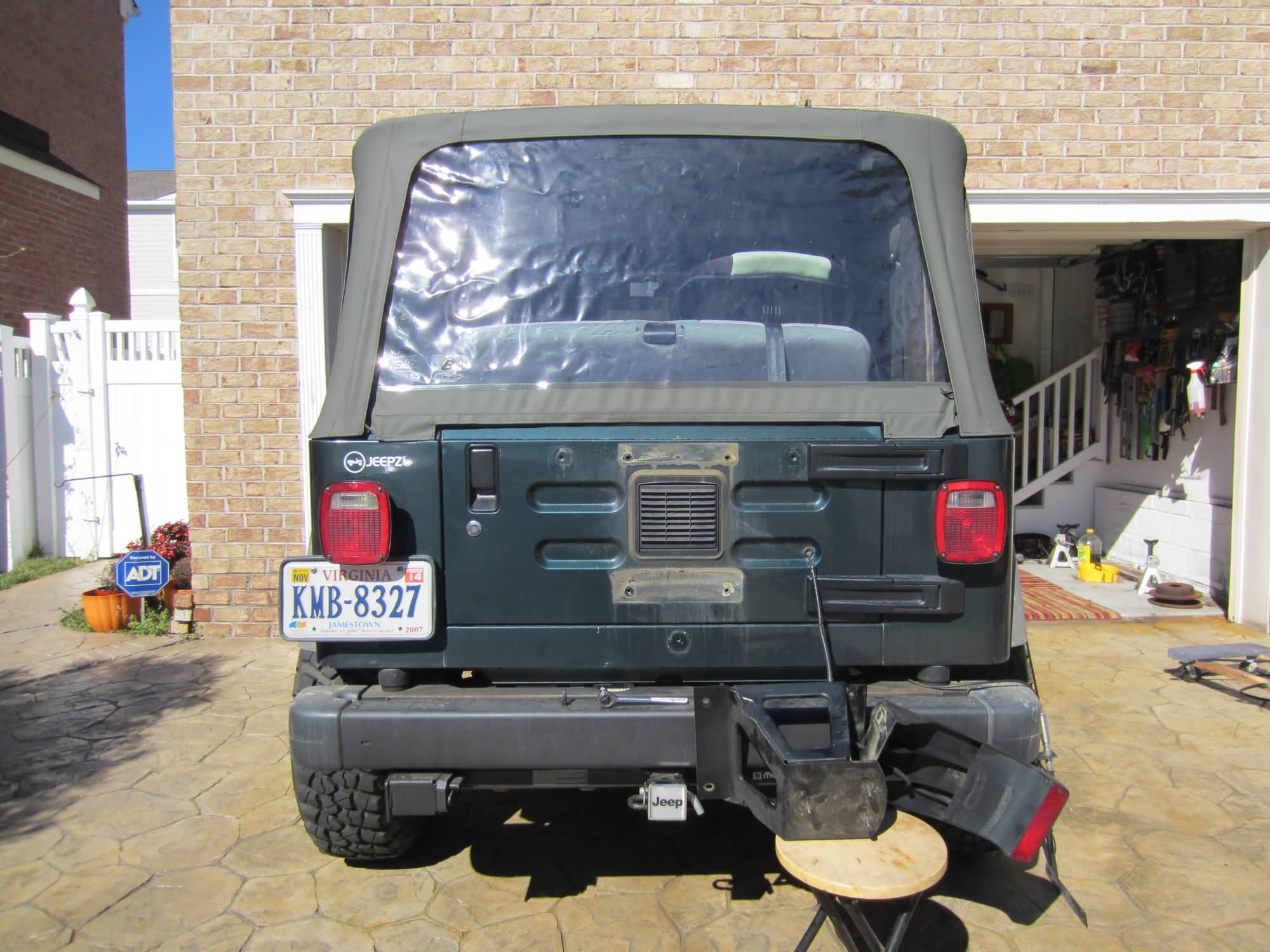

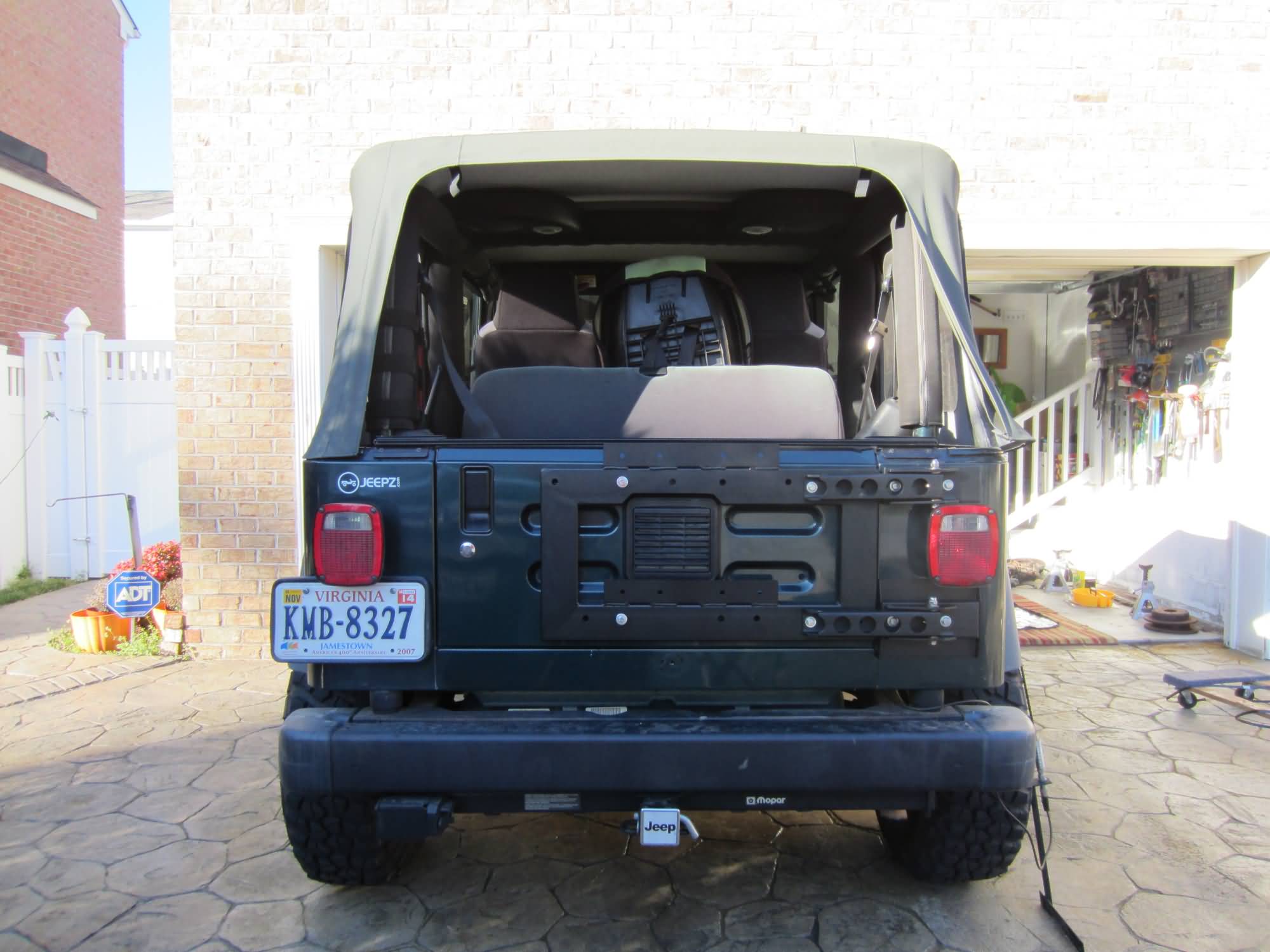

Installing is pretty straight forward, just start by removing your existing tire:

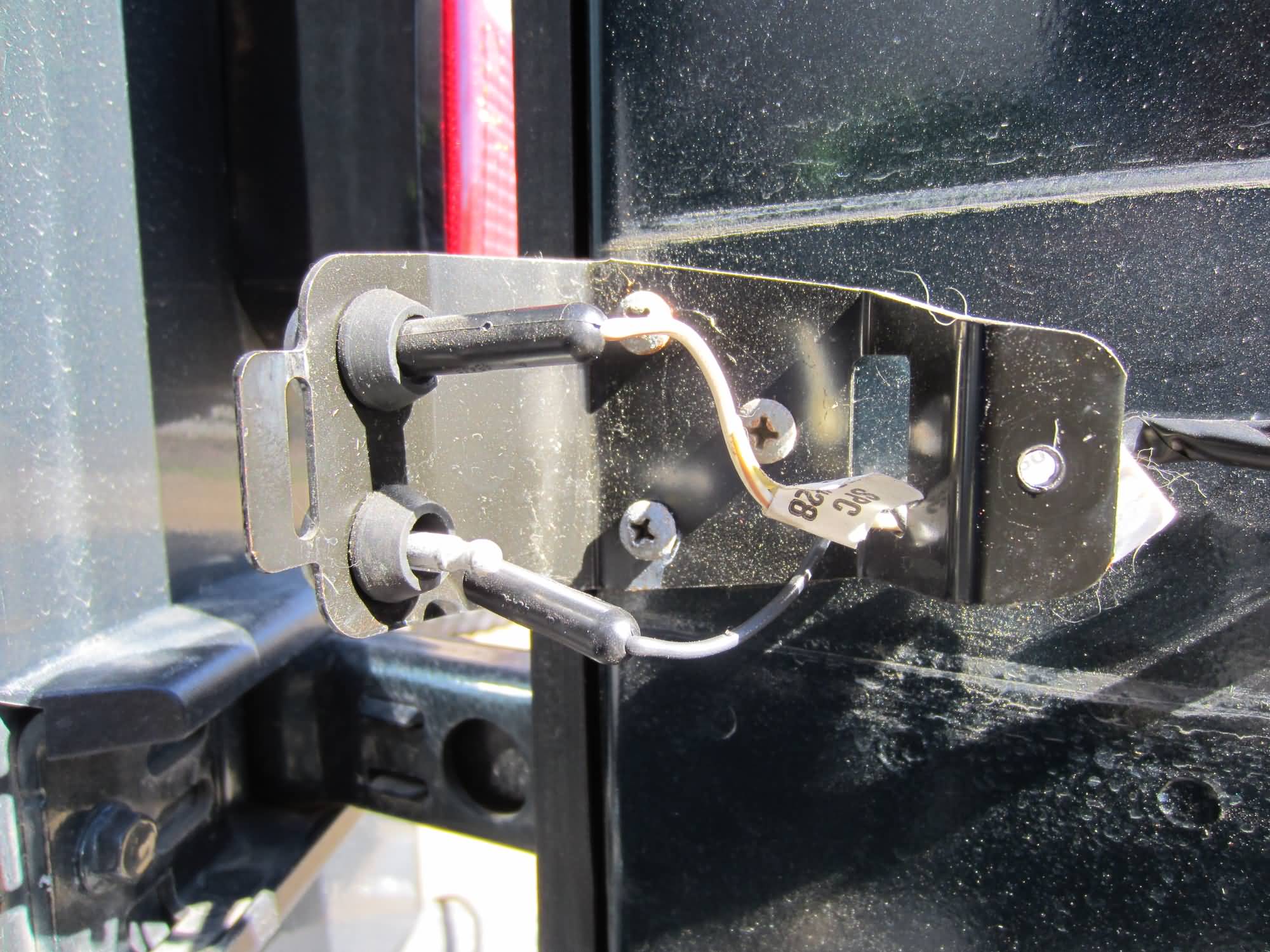

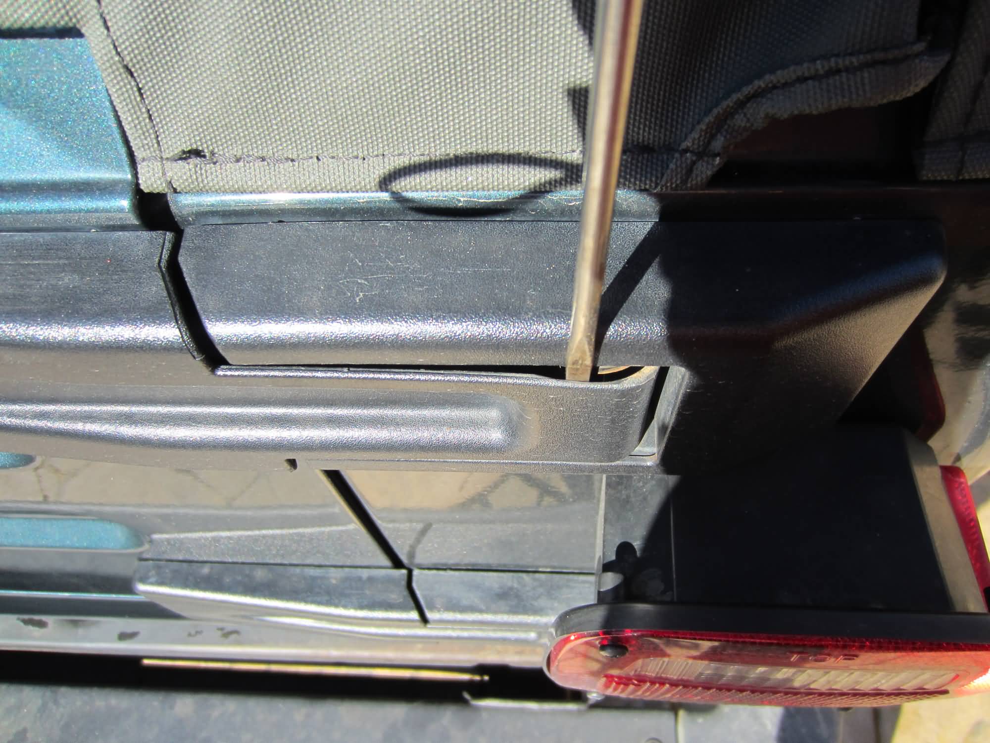

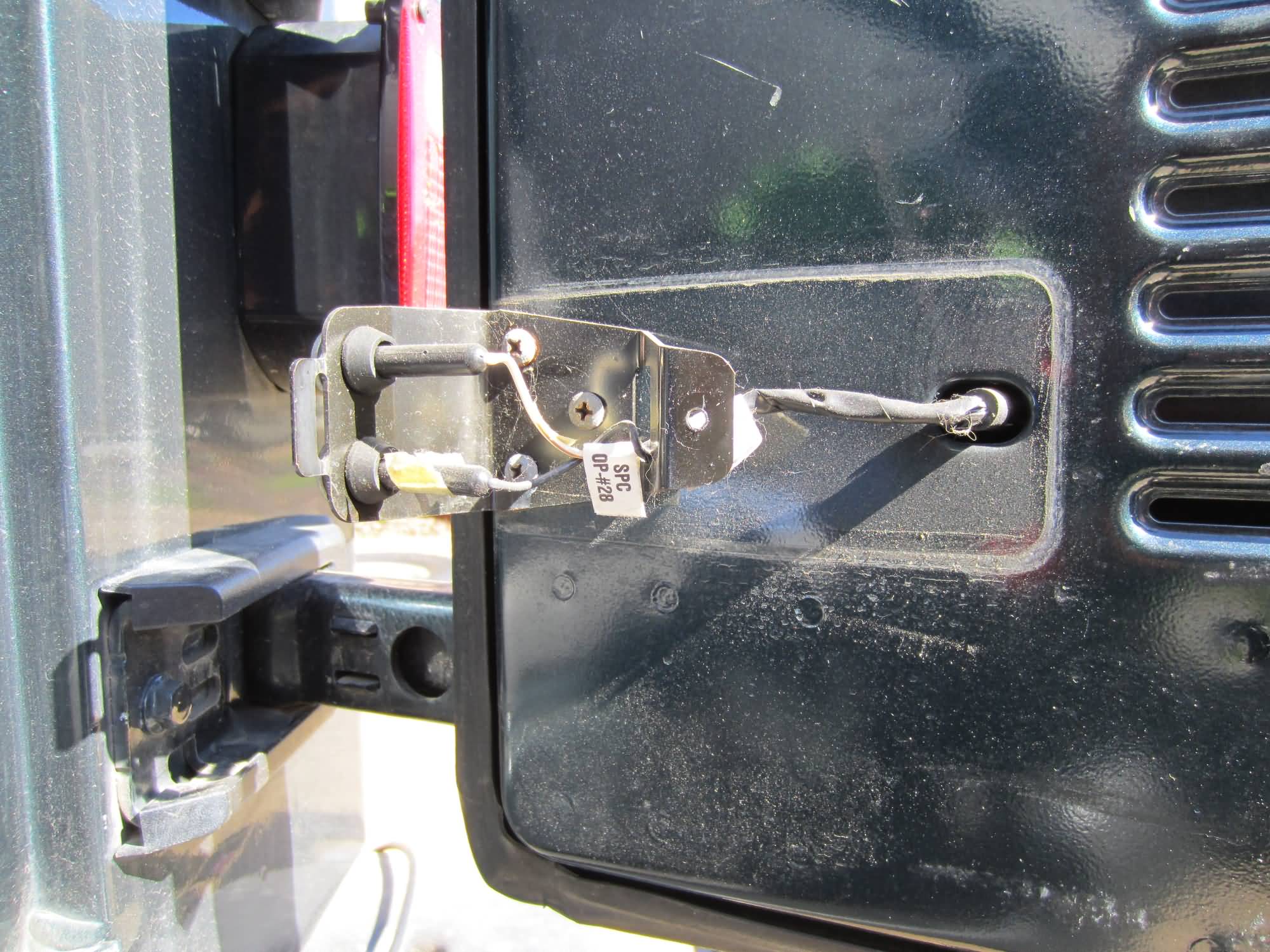

Unplug the 3rd brakelight wire by opening up the tailgate
Unscrew the screw and pop off the cover
Then unplug the wires, they just pull off (note where each goes for reassembly)

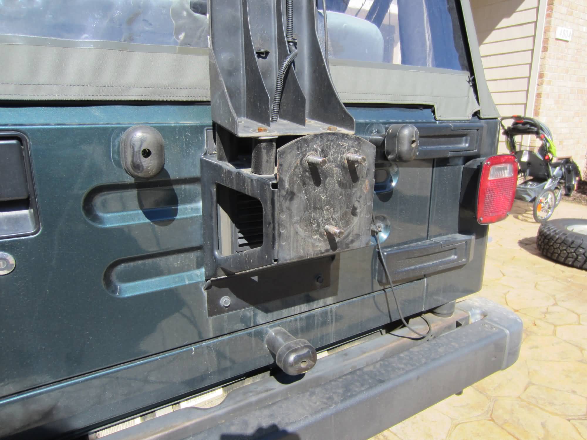

Unbolt and remove the tire carrier (and give it a good wipe down)

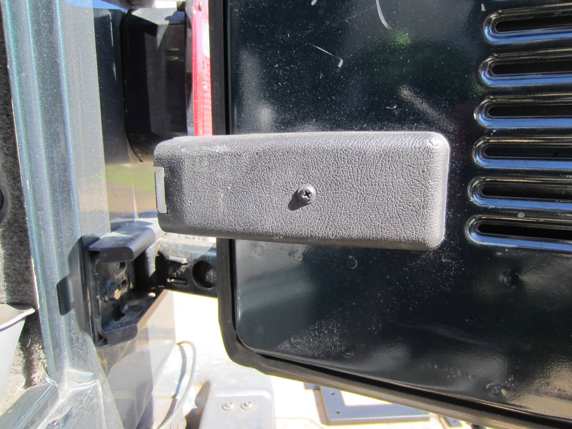

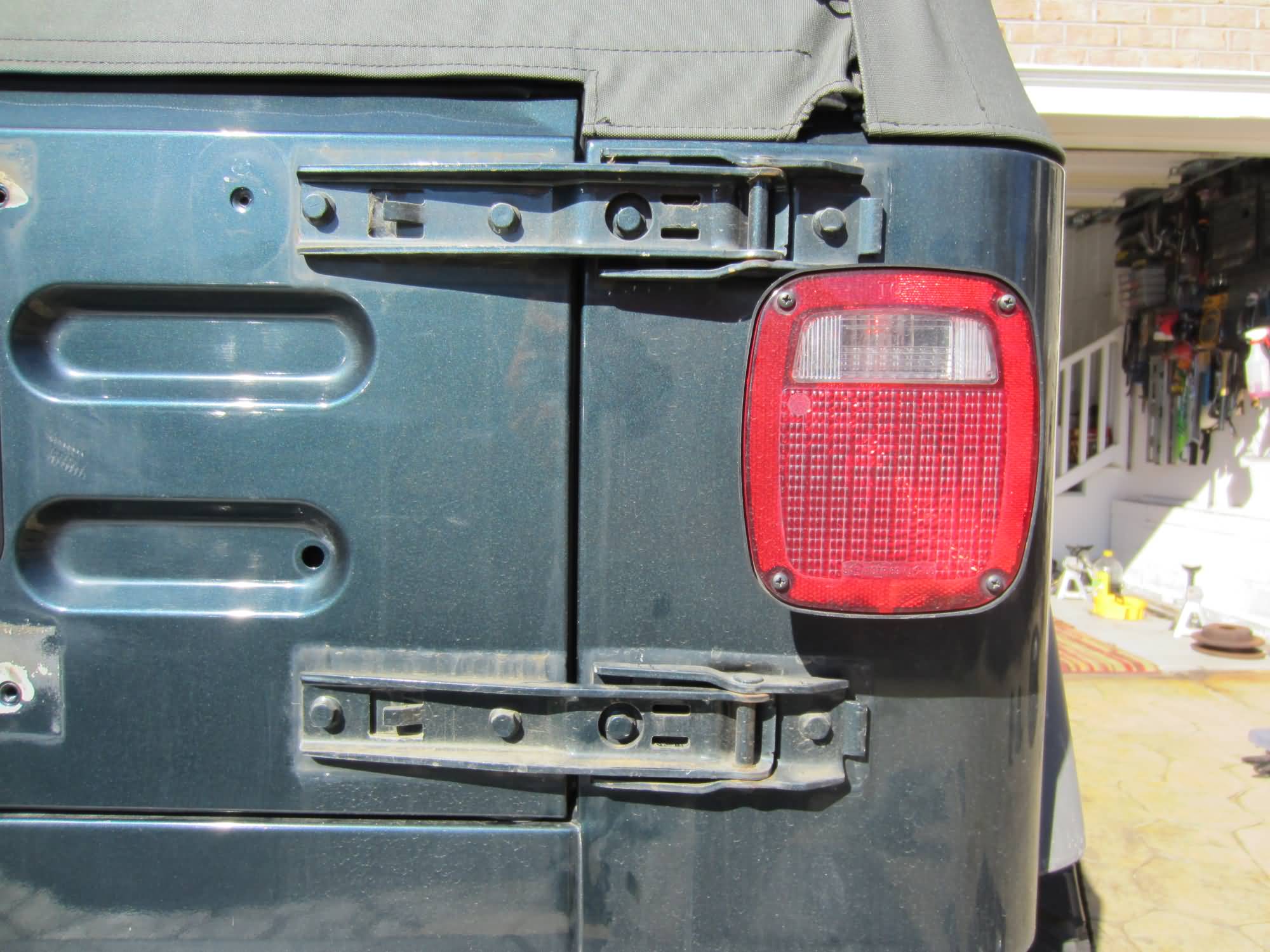

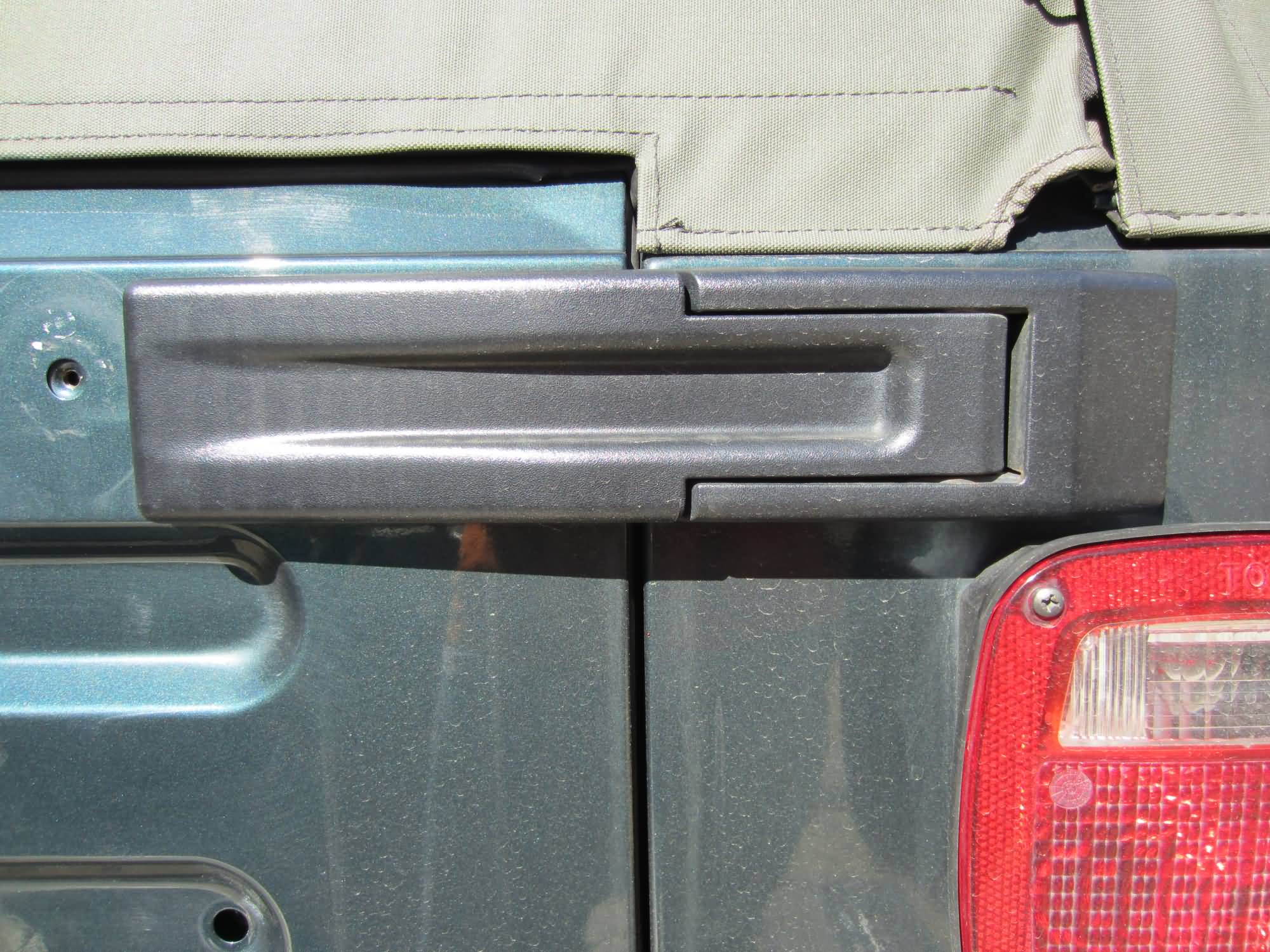

Now pop off the hinge covers

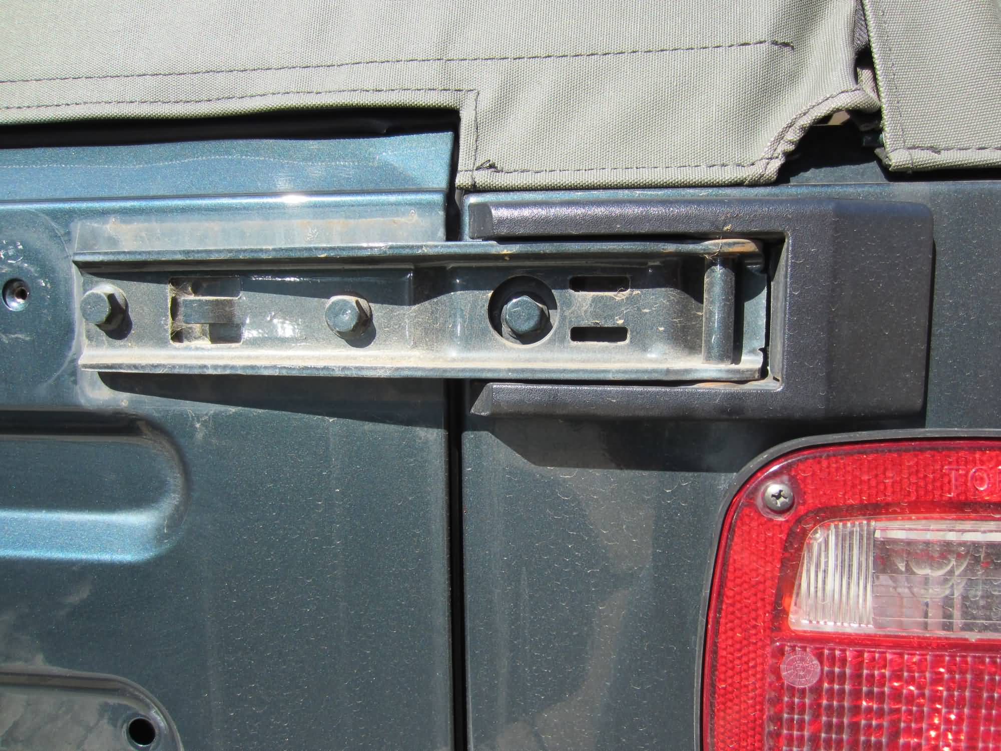

Now, leaving the tailgate closed, remove the hinges

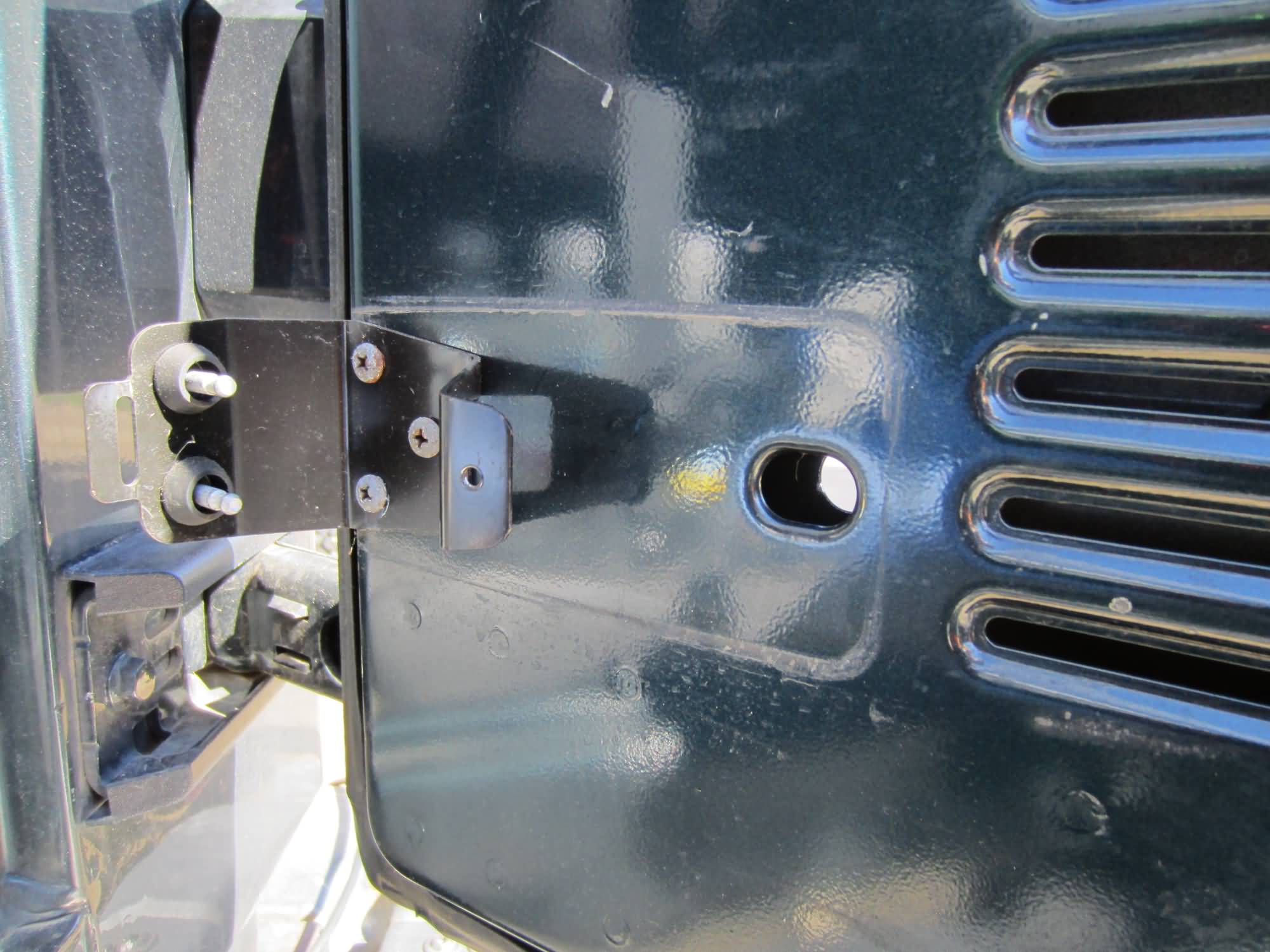

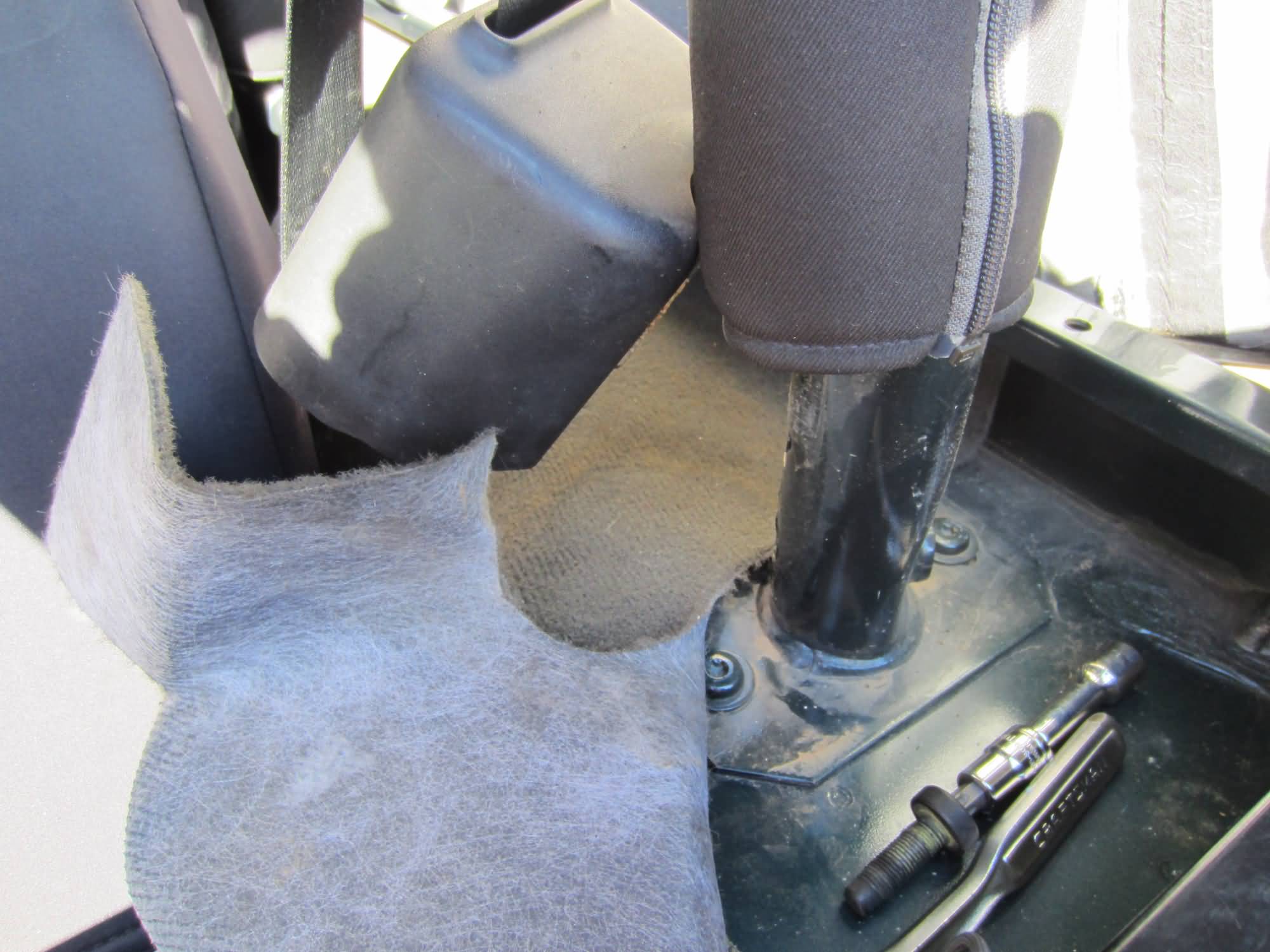

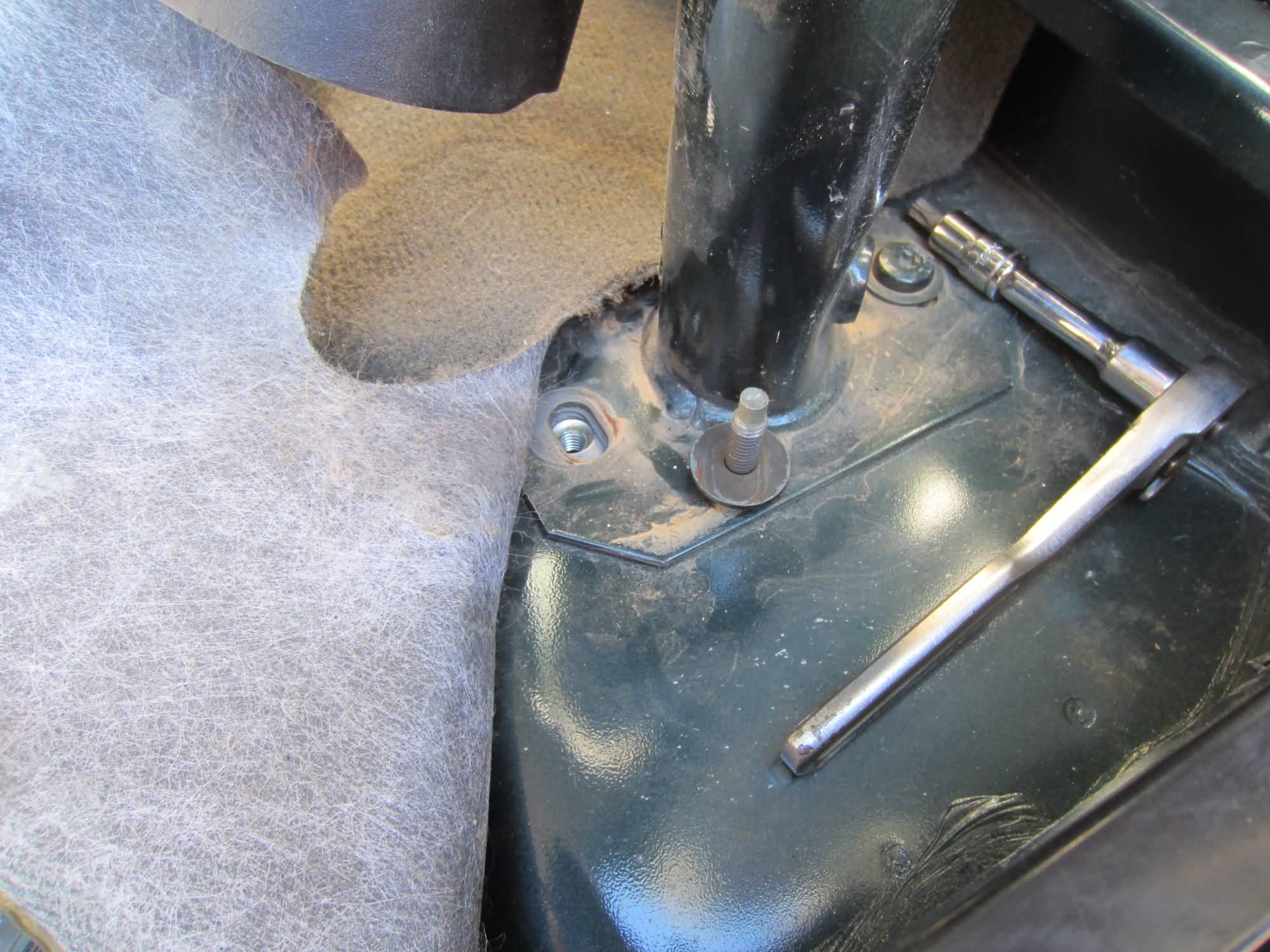

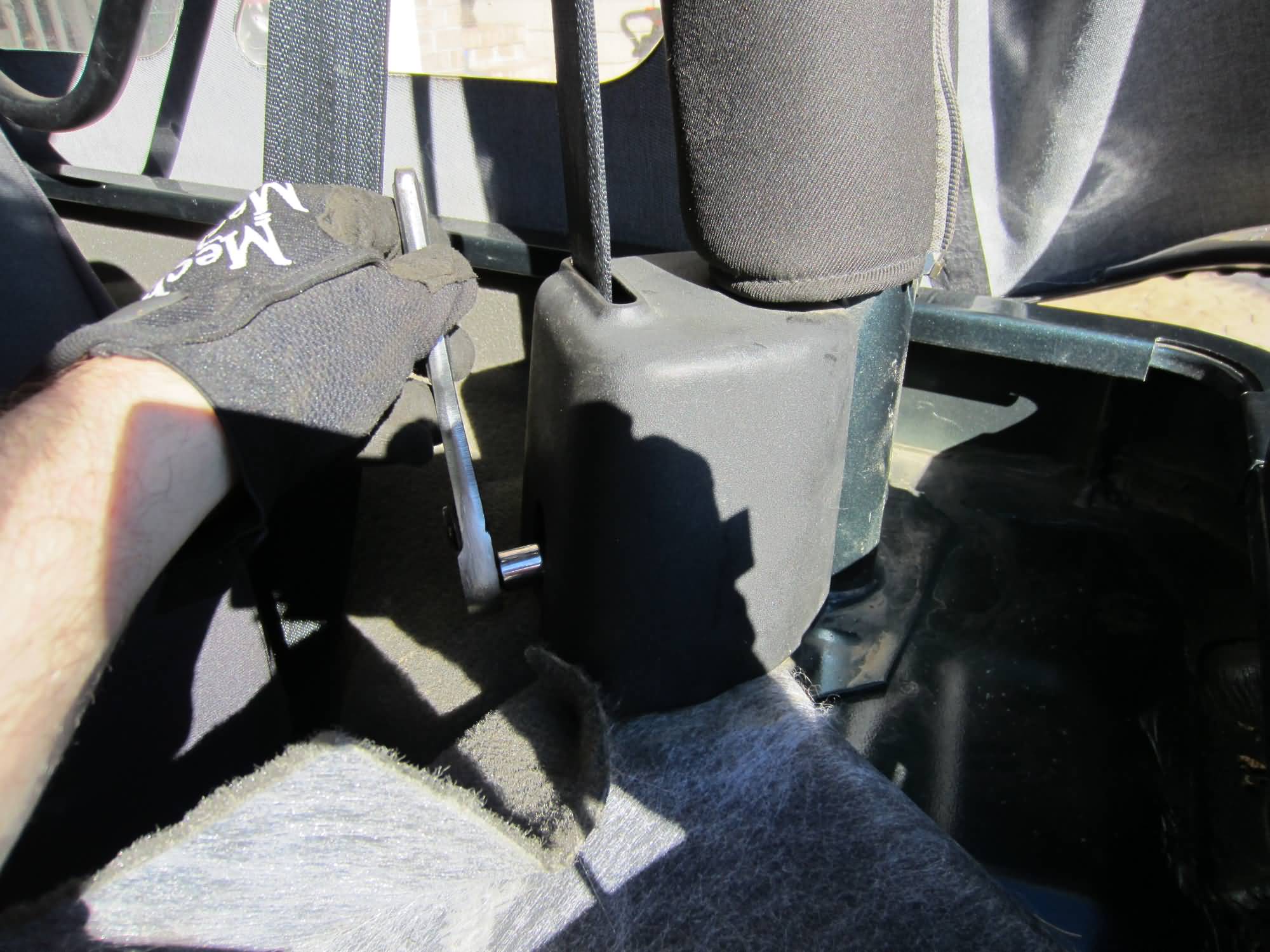

Now that the hinges are removed, you’ll have to install the roll bar tie in.

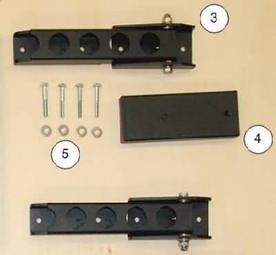

This was the only part of the install that caused me problems. This is how the hinges should be setup (this is a photo from the instructions – note the short side and position of the acorn nuts).
And this is how they came
I fiddled quite a bit with the hinges trying to get things lined up before I eventually compared my hinges to the instructions. Not a big deal in hindsight, but it would have been nice if they came either correctly assembled the hinges at the factory, or not assembled them at all.

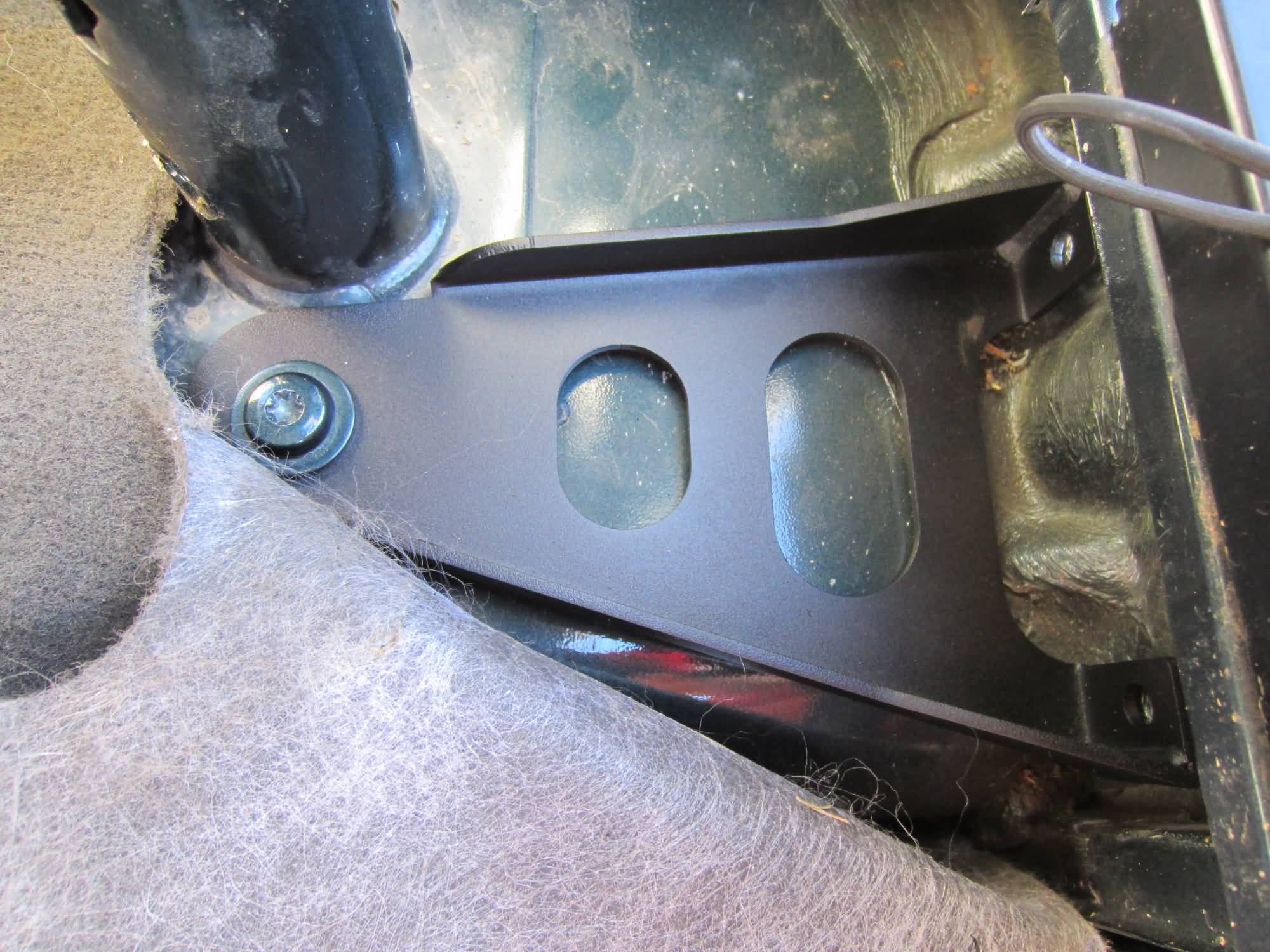

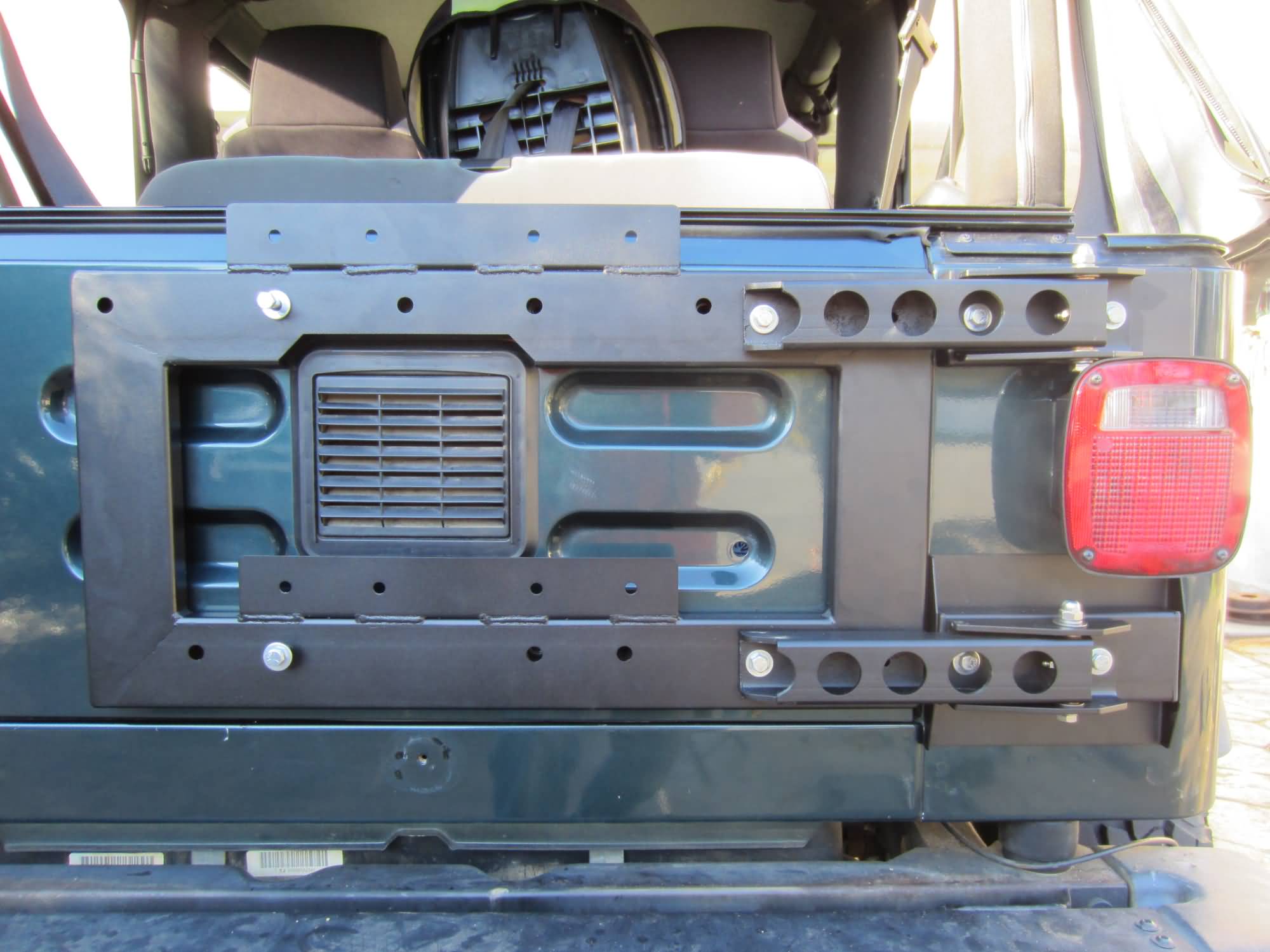

After figuring out the hinges, I mounted the body side (don’t forget the provided spacers)

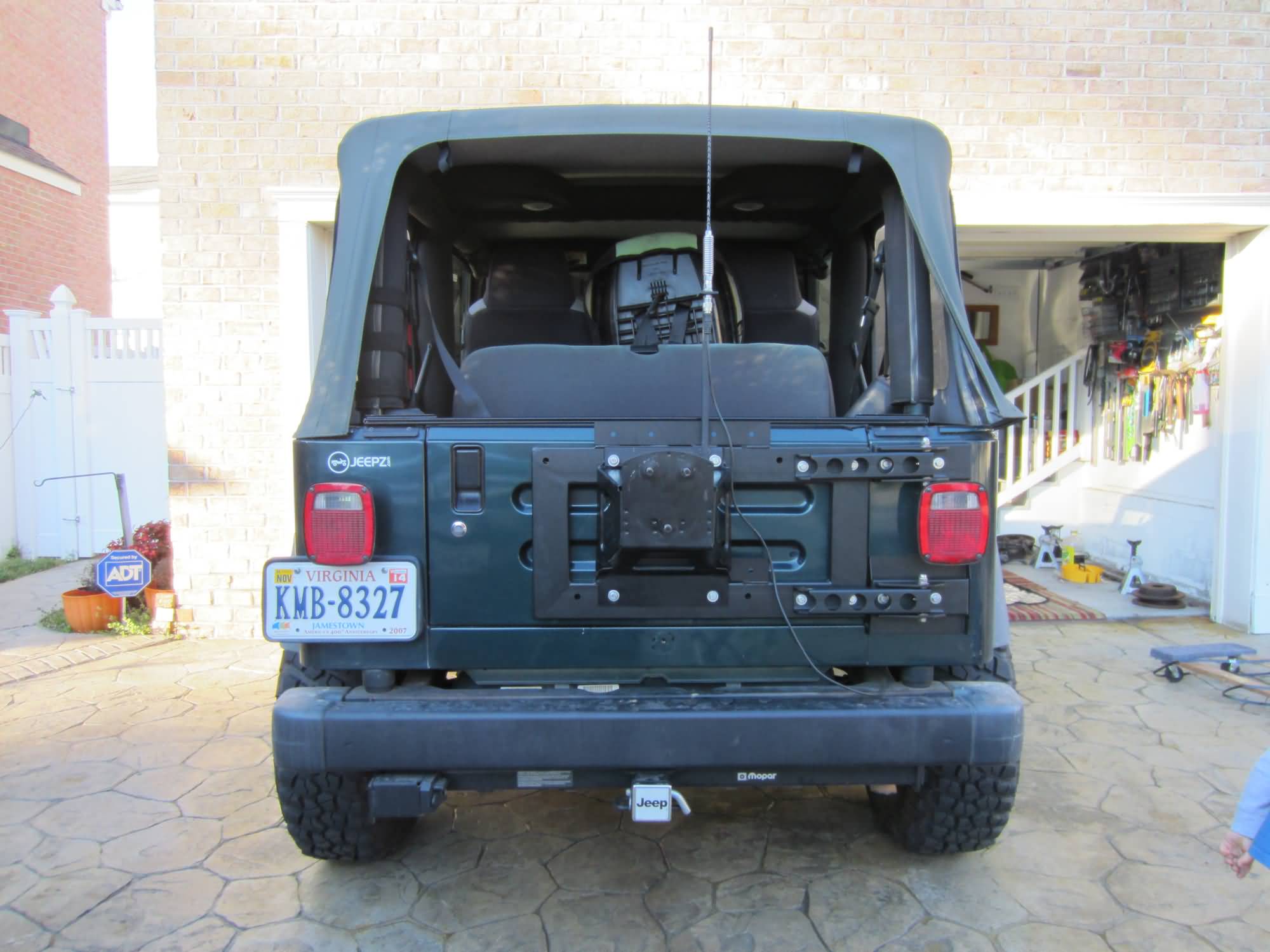

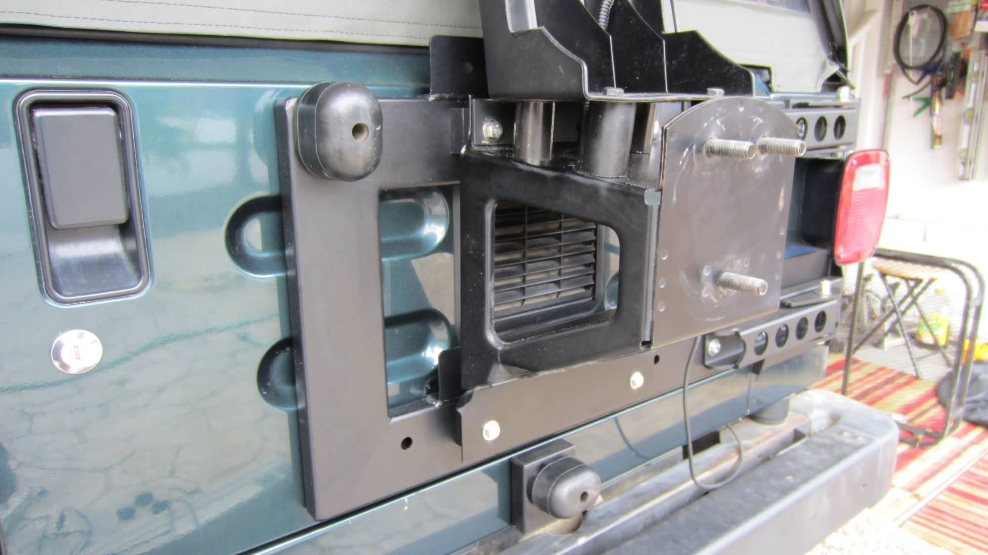

Next mount the tire carrier and install the rest of the bolts

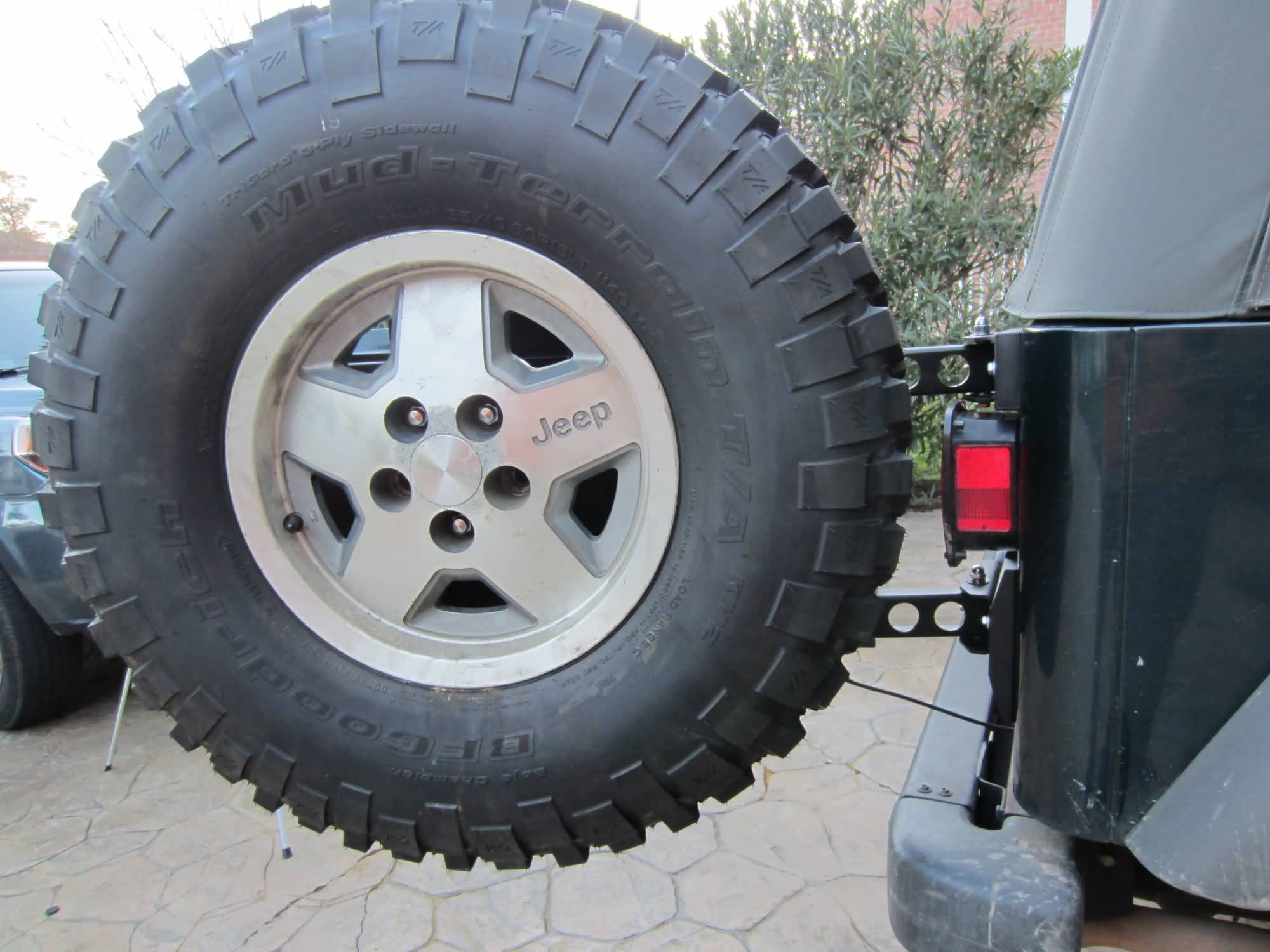

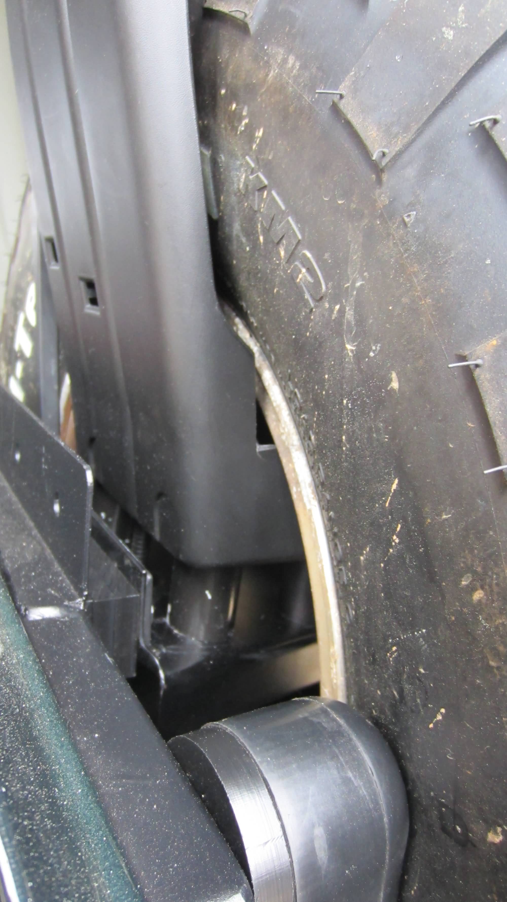

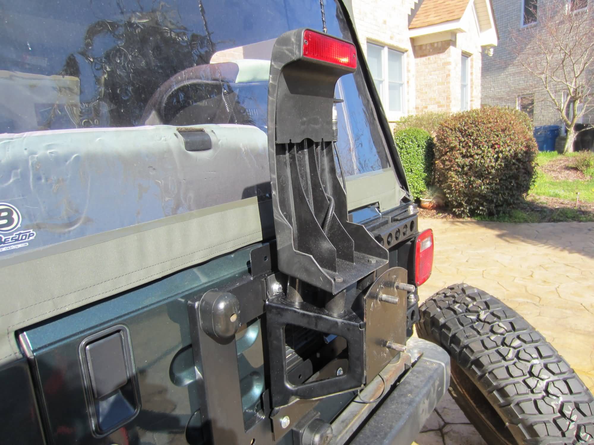

I then mounted the tire bumpstops and my 3rd brakelight. Since I’m running the stock spare tire I was forced to notch my 3rd brakelight to make things fit (I plan on either getting a different rim, or a wheel spacer in the future). This isn't a fault of the Exogate, since I could have installed more spacers behind the tire to make it fit - I just didn't want the tire sticking out farther than it needed to. You can also see the 4 pieces of PVC pipe that I used to raise the height of the 3rd brakelight.
There are a few different mounting heights you can choose when setting up the Exogate – I opted for the lowest setting, so that less of my rear view would be obstructed. If you prefer (or have a larger tire) you could mount the tire higher. Once installed the action of the carrier is nice and smooth, and the tailgate of my Jeep now shuts with a good solid feel. There are no vibrations in the tire as I hit bumps in the highway, and after about 6 months of use the tire carrier feels as good as the first day it was installed.
In my opinion this is a fantastic tire carrier, and at $400 it’s cheaper than most traditional swing away carriers. I wouldn’t hesitate to purchase this tire carrier again.

Stock Jeep TJ:
