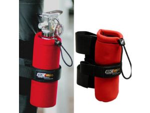

How you mount it depends on the size of the extinguisher. A lot of extinguishers come with their own mounts and you can either screw them on the roll bar or use heavy tie-straps. Small diameter extinguishers can be mounted in pouches with Velcro straps.

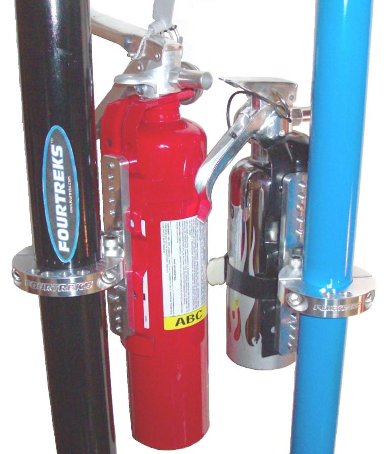

You can get fancier with these billet aluminum modular mounts from Fourtreks @ Modular Fire Extinguisher Mount

Honestly, I don't know many that have chunked out that kind of change for extinguisher mounts but they sure are pretty sweet.
Biggest thing is that the extinguisher has got to be secure in the event of an accident, rollover, whatever. You don't want it flying around like a projectile but it also has to be quickly released and removed for use.

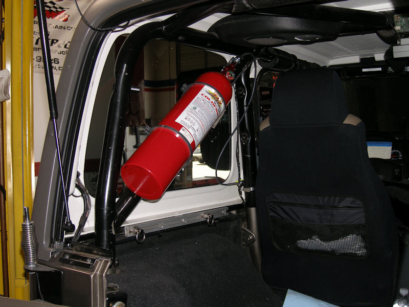

Or for containment of an engine fire you can mount an full or semi automatic fire suppression system like the one in my rig which is a 10# Coldfire unit with dual discharge nozzles under the hood...
