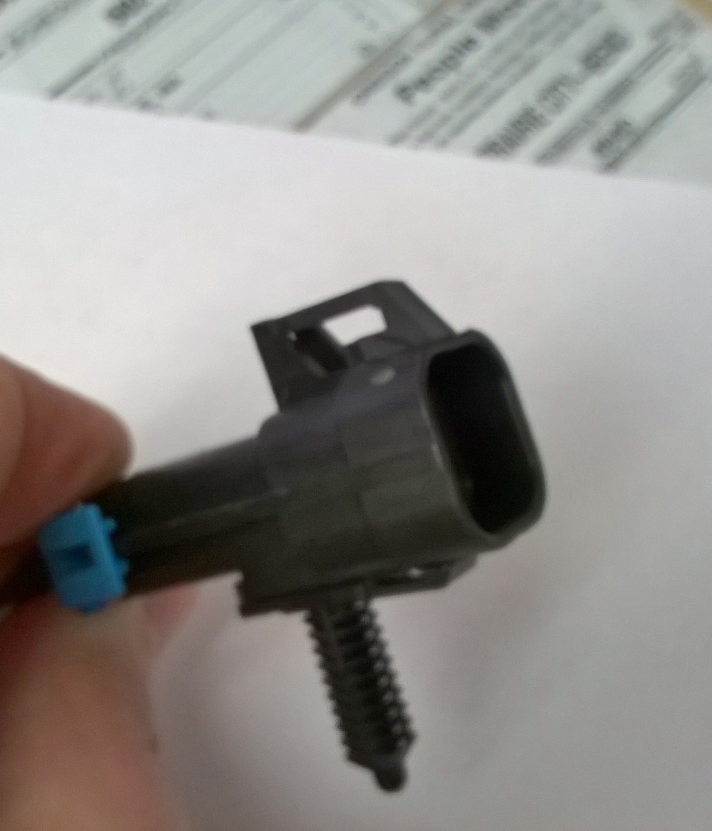

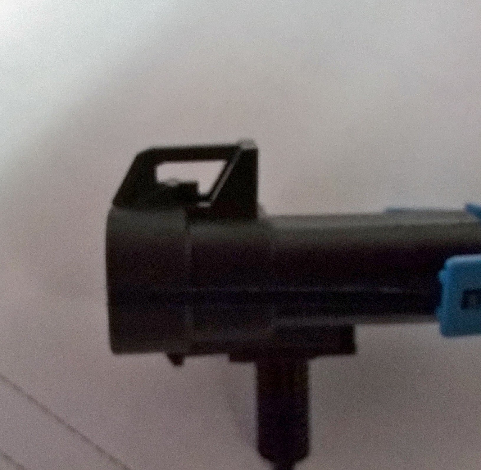

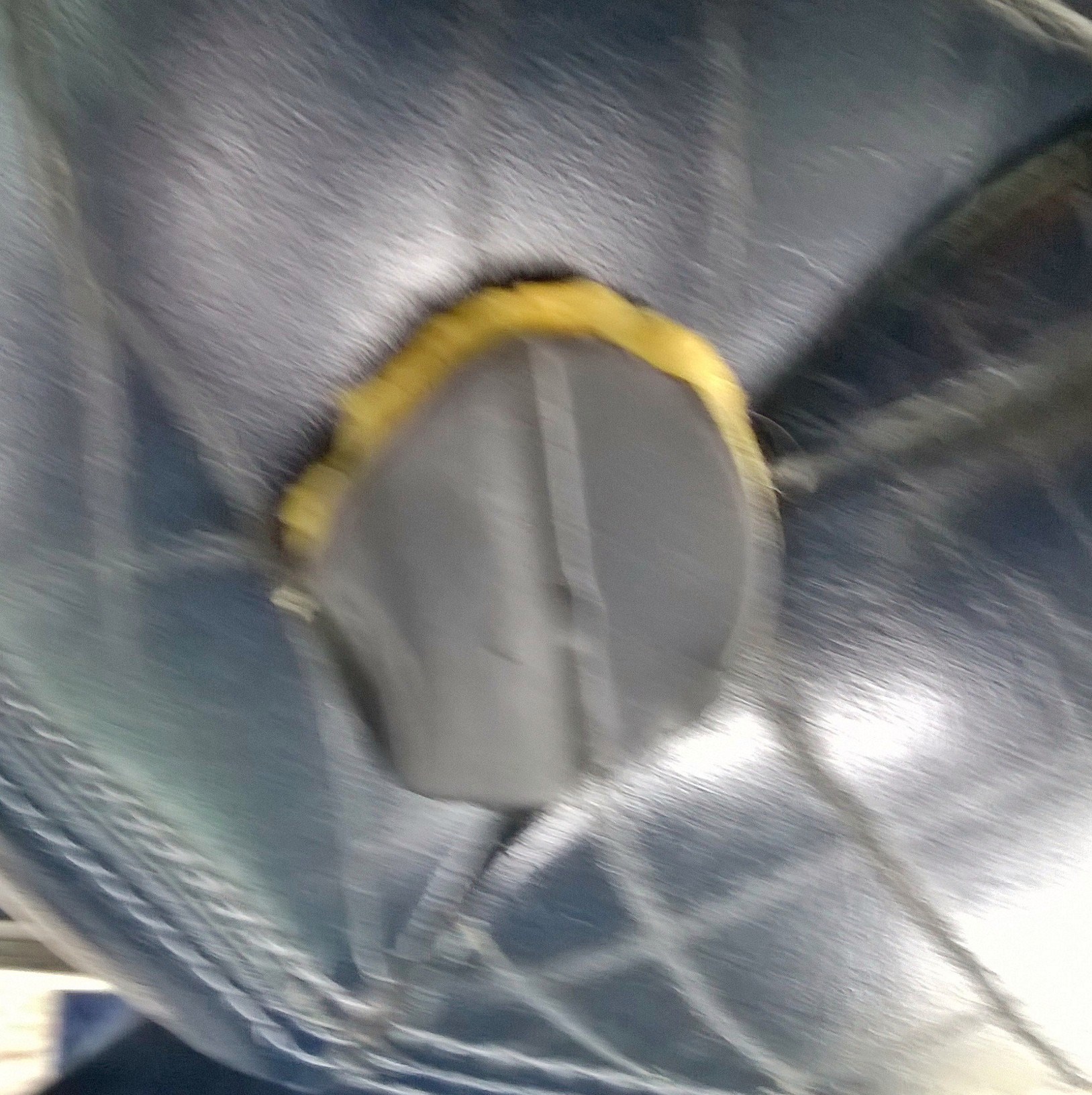

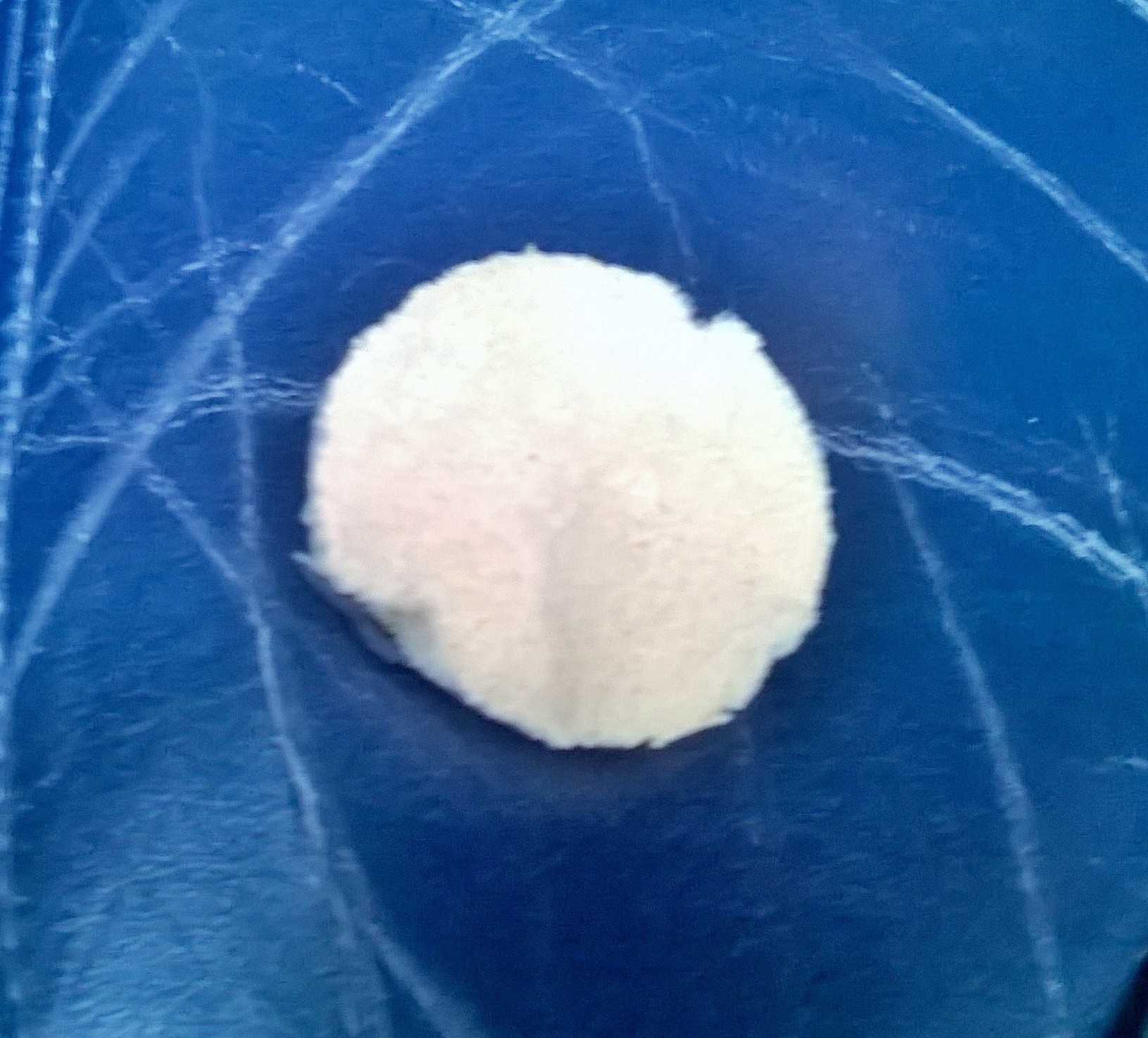

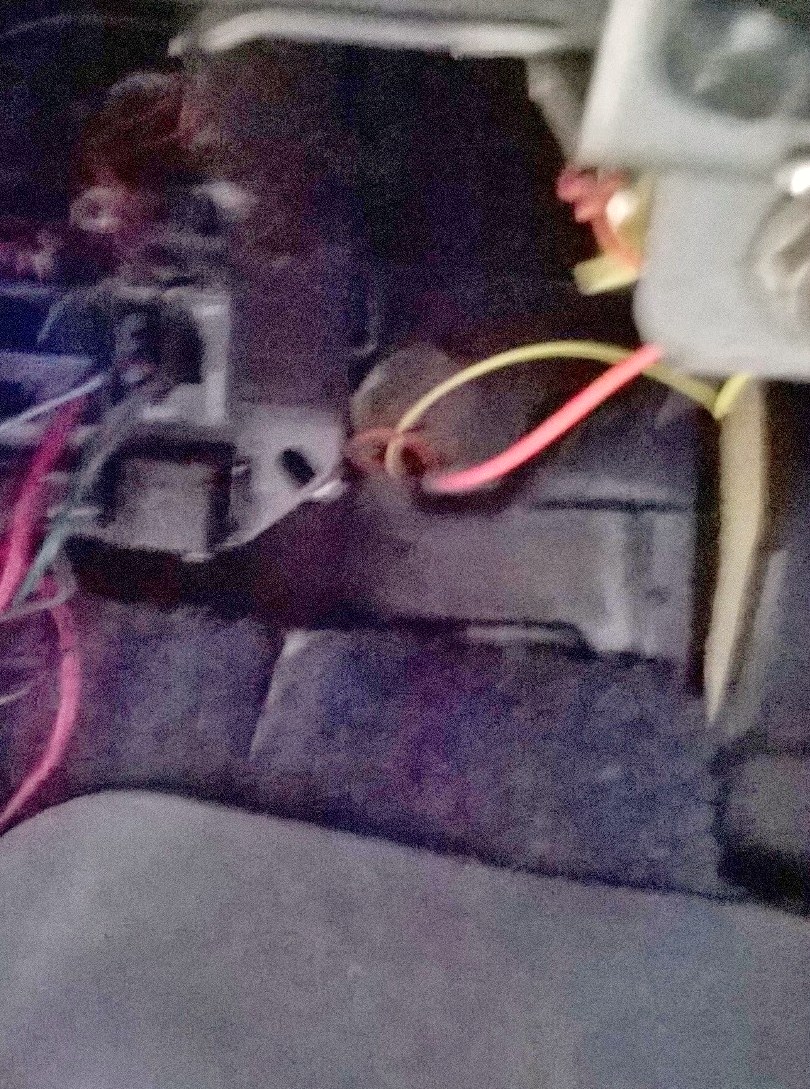

Most jeeps have wires running through the firewall into the column or other area. Just trace those wires and zip ties will be your friend. My TJ looks like a gaming computer on the inside with all the lighting and things that have been ran.
