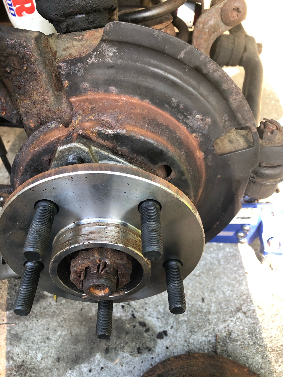

Replacement wheel hub looks exactly like original but somehow maybe the dust shield is wrong ??
Wheel seems to go further back and is being tightened against the dust shield. I thought this was a bad front caliper issue so put on new ones only to find out after tightening one wheel it won’t budge.

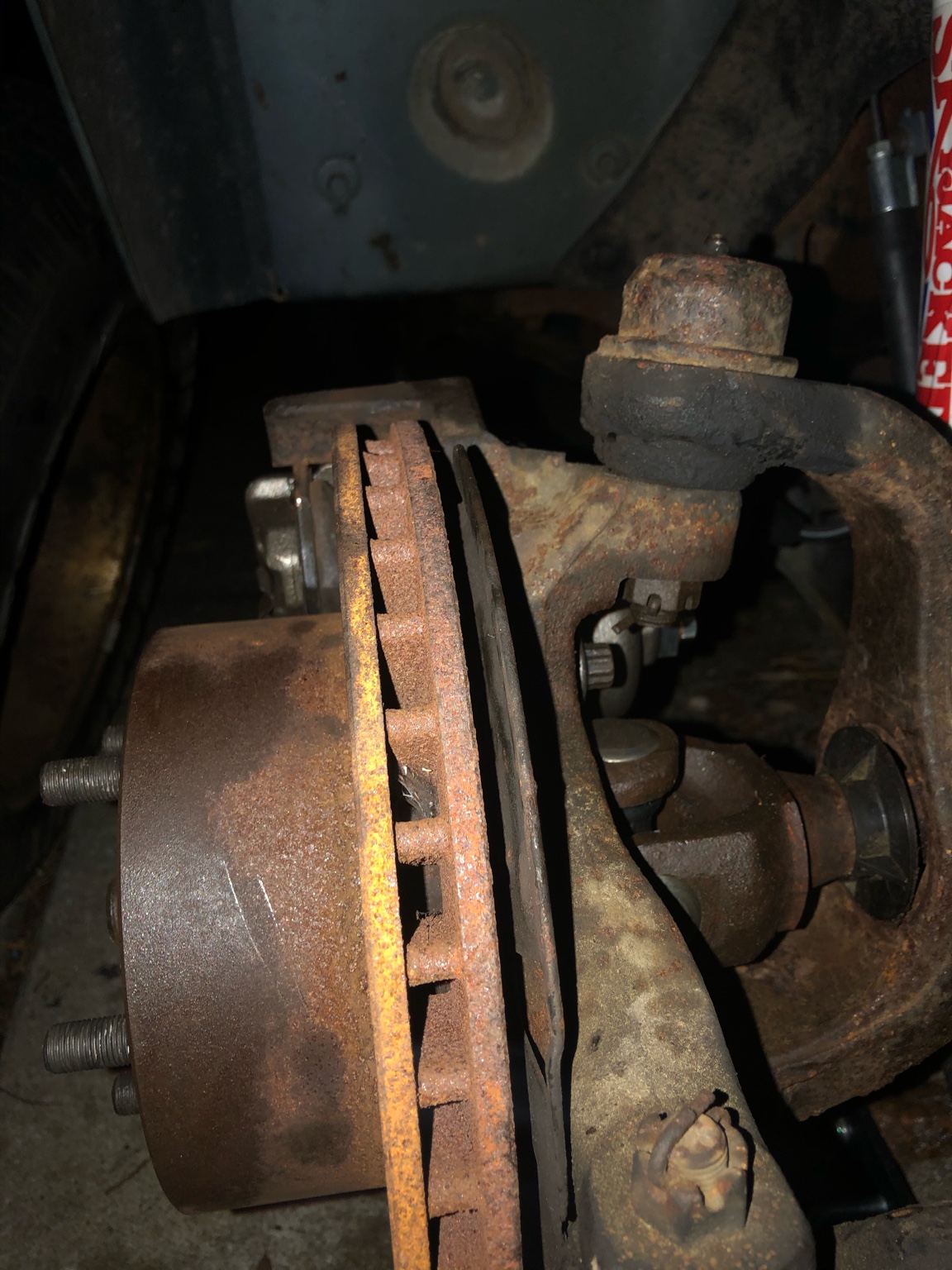

Rotor is obviously going too far back on the hub. Not rubbing calipers or any other part.

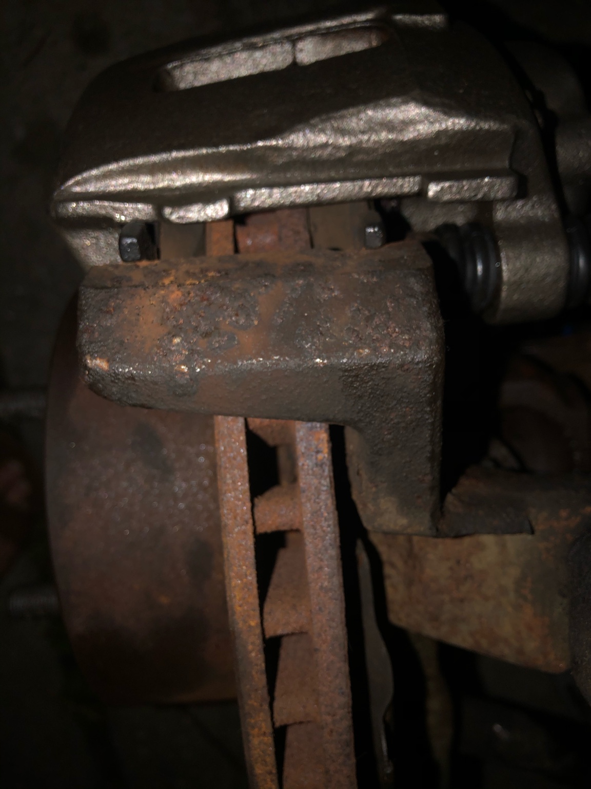

The rotor seems to have the perfect “fit” but I can also push it back and it then hits the dust shield. So tightening down the lugs pushes the rotor so far back it locks on the shield.
And by perfect fit I mean it rests on a normal position and just a few more pounds of pressure it will kind of “jump” past that position and hit the shield plate. I’m stumped as this happened on the original calipers as well. ??????
I’ve seen comments on the caliper bolts being too long. But the original calipers should not have had this issue (?)
It does have a fair amount of play with the new longer bolts ( new one has a steel bolt sleeve) but it’s not the job of the caliper to hold the rotor in a fixed position. I’m stumped.
