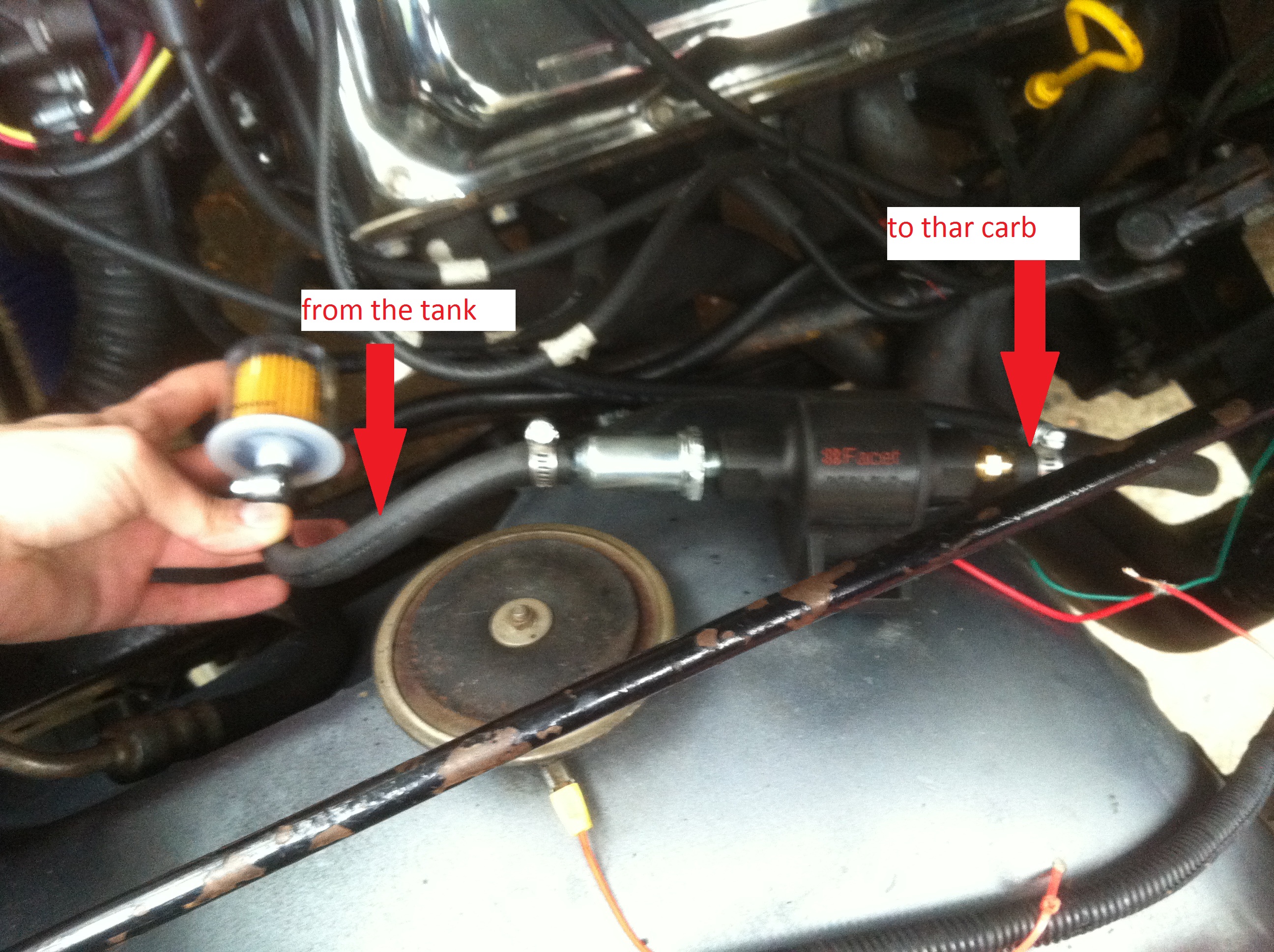

I think i may have stumped myself lol. I cant get the darn fuel to pump through! so here's a few pictures of my set up, maybe i messed up something.

suck the fuel until its in your filter and it should be ok from then on. you just have air in the line and hte pump won;t pump air.
also, that pump is going to crap out on you in a few months. just spend the 100 and get the holley low pressure rebuildable fuel pump. your set up just like i am not, minus the bigger engine

I looked up that pump and theres no way it will be able to support my engine. It will suck up the fuel faster than it could pump it.

That's what it's supposed to do. The fuel system if operating properly will regulate flow. The flow ratings are at no restriction. I run a Holley blue in all my street engines anything from a chevy 250 straight six to my solid roller 355 with a 250 shot of nitrous.
that mr gasket pump is terrible. it was on my 6 cylinder jeep when i got it and it wouldn't keep the weber running properly. the holleys are great and you can get ones that have a higher volume then the low psi street carb models. i am just trying to keep you from having that mr gasket one crap out in a bad spot like the one i had did.
