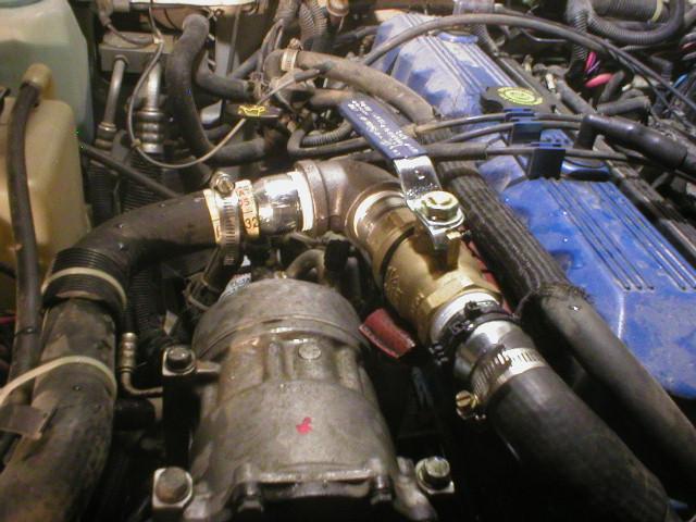

A friend of mine has been battling a similar heat problem for a year or two, replacing most everything. He bought an IR heat gun to check temps across the radiator and at each hose. His last venture was to install the valve in the pic below. We went wheelin Saturday and we weren't on the trail long when his temp shot up to 240º with the valve open. He closed it a bit, and as he found out during earlier testing, the jeep cooled down and ran cool the rest of the day. His conclusion was that the coolant was moving too quickly through the radiator and/or the fans were not sufficient at cooling the radiator before the coolant exited.
Excellent thinking on his part, having the coolant flow too fast not giving it time to shed the heat IS a problem on alot of 4.0s
I would also suggest finding someone with a heat gun and verifying that your coolant is actually as hot as the gauge says it is before you spend any money .
