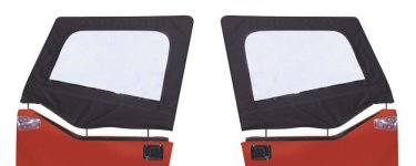

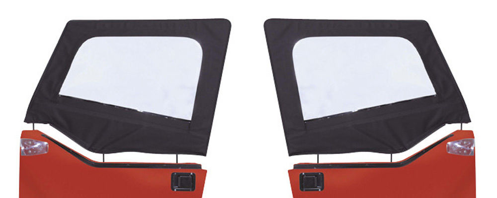

Look out for the shape of the upper window. Your hard top has a rounded corner, however YJ soft tops are made to accept a pointed corner like this:
All this means is that you won't be able to use the full doors with your soft top unless you find / buy a new door surround.
You'll need to buy the full soft top, with frame, windshield header, etc.
