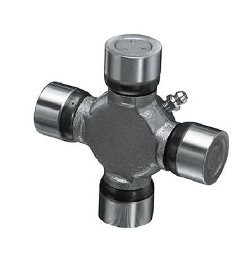

How exactly do you grease them?? Which joints are we referring to?
This is what you grease. If you notice, there is a little nipple(grease fitting) sticking out. You use a grease gun to inject grease into the joint.
You can buy a grease gun at pretty much any auto parts store. There are also grease nipples on the drive shafts. Take note that there are different kinds of grease fittings. If the grease doens't go in, there is either too much pressure on the joint, clogged, or you don't have the proper attachment on the gun.
Hope this helps!
