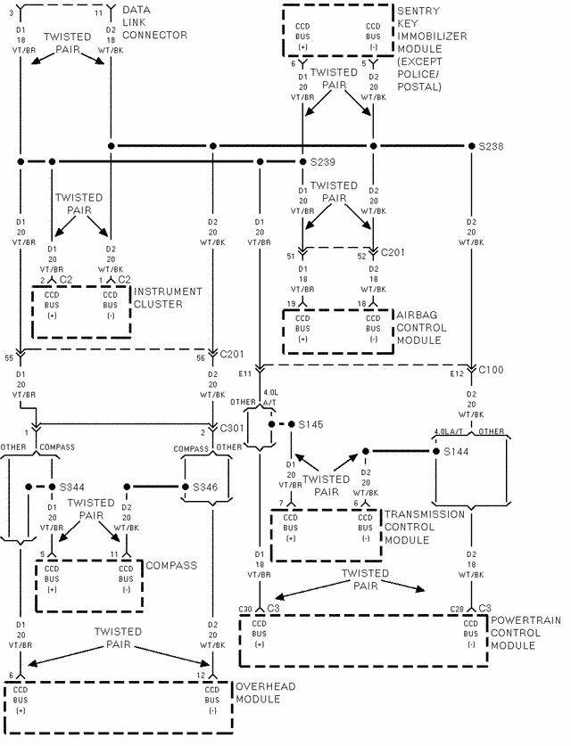

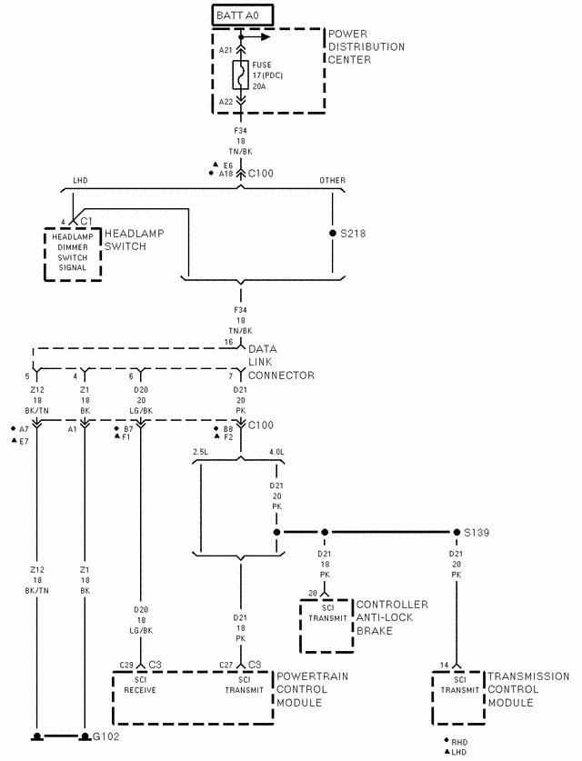

P1698 is a communication code fault from the TCM( Transmission control module) . The diagnostic procedures can be found on a 1999 service manual. The 1998 service manual will not have the diagnostic procedures on this particular DTC. The procedures are as follows:
Check the CCD bus lines from the TCM
Check the TCM connector for corrosion, pinched wires or severed wirings.
The possible cause for the communication error would be an open short, short to ground or short to voltage.
If all of the diagnostic test passes, the TCM is at fault and will need to be replaced and possibly flashed.
Here's a couple of wiring diagrams that will help you trace the CCD bus communication wires to test and verify.

It's not that bad considering that there are only 2 items your verifying on these schematic diagrams, SCI communications between the PCM and TCM and verify the CCD bus line as well. If any of those lines are faulty, it would need to be repaired, if they test good, replace the TCM.
