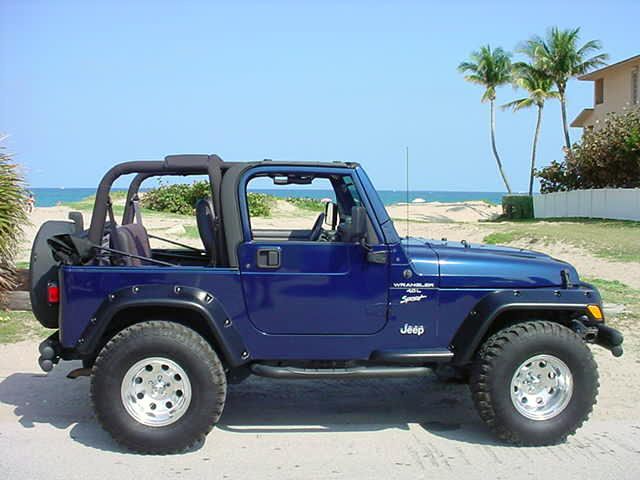

It's the tires and lift for sure. I've got a 2000 TJ with 33's and I'm getting about 11-14mpg on the freeway. My speedo has been regeared to show the correct speed so my mpg are accurate. The next move for me is a gearing change to get my engine rpm back within it's ideal operating range. My stock ratio is 3.07 and I'll need to go to something like a 3.83 to correct for the tires. Even with the gearing change I don't expect to get the same milage as before but it will improve. Has anyone done the gearing change after living with the stock ratios on this site that can report on the actual gains in mpg?
