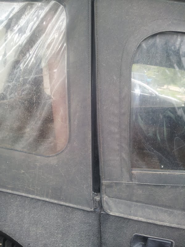

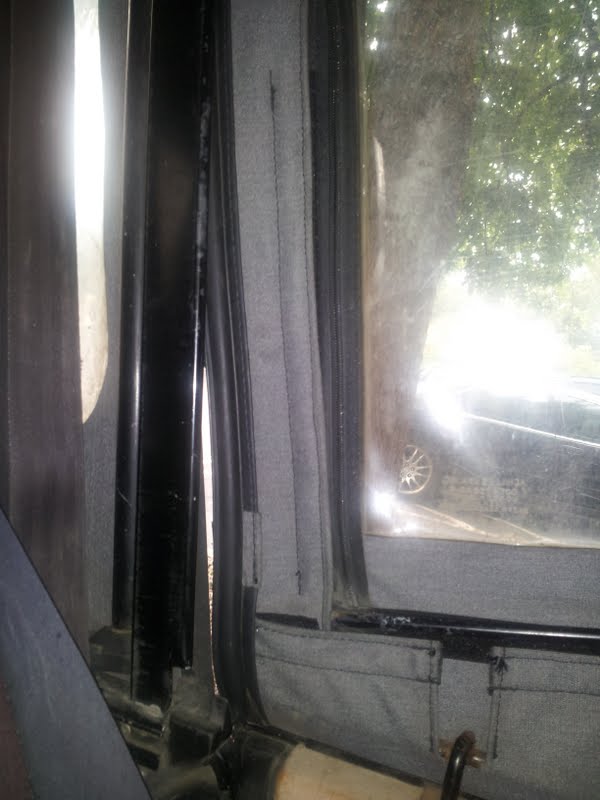

I think if I can just keep the warm air in and cold air out that it will be warm enough. We have one of those baby air temp readers so I will know if it is to hot or cold. The gaps are mainly up by the doors. I still have the original top that came on her but its really worn out and missing the back windows...It looks like the new top is just too short. (only a year old) The gap is about an inch and and half or so between the door frame and the windows. (I have the half doors.) I was thinking of rigging something up out of the sealer/weatherstrip stuff that you put around the front door on a house. Think that will work?
Any chance you can post a photo of the gap?
Is it a gap between the front windshield and the window on the door? Could be that you have TJ softop door uppers on your YJ
I will be working on her in a minute. (blew a radiator hose last night) So I will get a few pictures. The gap is between the door and the back windows. I bought the top from Bestop, was told it would fit... Kinda makes me angry.

can you adjust the door stricker so the door closes tighter and seal the gap? I have a gap as well in the same area, but mine it at the top of the door.
Sell the baby or move some where warmer.You can give up the Jeep! :lol:
Looks like something is not square.How are your plastic inserts where the upper window slides into the doors?Other than that can you bend the window to fit.Even new window need bent to fit properly.If all else fails your idea with the weather stripping should work.
Just like the last two posts, I had a similar problem with a gap in my door. Have you tried going to the "Bestop" site and checking for tech. help?
My doors have adjustments (slide in or out) at the hinge pins for the soft doors or the the whole steel door hinges can be adjusted.Plus, with the soft doors, I had to bend the upper part of the door a little. The soft doors also have set screws (Bushings) to rasie or low either end of the upper half. Can't see if you have the same thing? I realize that you have half steel doors, but I believe you can still adjust them to some degree.

I will Check when my husband gets home from work. I don't remember seeing any thing to adjust them with...But I wasn't really looking. The door fits perfectly everywhere else. Just not at the back. it's like the soft part of the doors is too short or something. Thanks for all the help though. Got a few ideas as to how to fix it.
Are you sure that it's the door that's off and not the top side of it? The way that your window is slightly wrinkled makes me think that the bottom of the top needs to be closer to the door.
This may involve drilling a new hole for the soft top hardware, but may fix your problem.
I agree. Try on a warm afternoon in the sun, unzipping the side window from the back only as far as the upper corner. Pull the bottom out and readjust towards the front. Pull the back corner lower around toward the side and rezip the side window.

looks like the rear window and top rear corner need to be pushed foward. Mine does this every so often but my top has seen way better days (reason it comes off March - October). When mine is streched out it does leave a small gap at the bottom of the rear window zipper use your tape there if needed. If thats the issue its an easy fix.
Unfourtunatly, whoever had her before me did one hell of a remodel on the wiring/ underdash area. I had to kinda rig the heater to work as much as it does...I knew she would be a project when I bought her (a year and 4 days ago) but I hadn't planned on having a little one so soon. I will try to stretch out the side. It should be warm tomorrow. Thank you all for the help and Ideas. I will post back if I can get it fixed ^.^
