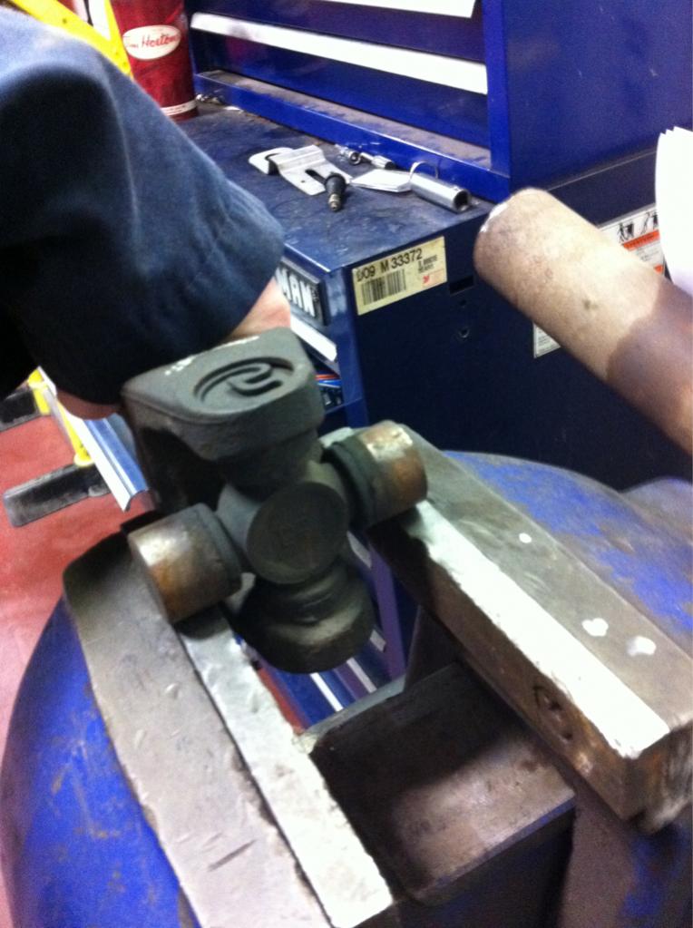

I place the yoke ears on the vise jaws and get my big hammer and hit the opposite yoke. Don't hit the shaft it will dent. If it is the diff end with just a u joint you can put the u joint cross on the jaws and hit the yoke on the driveshaft. If I'm confusing you I can take a pic tommorow at work

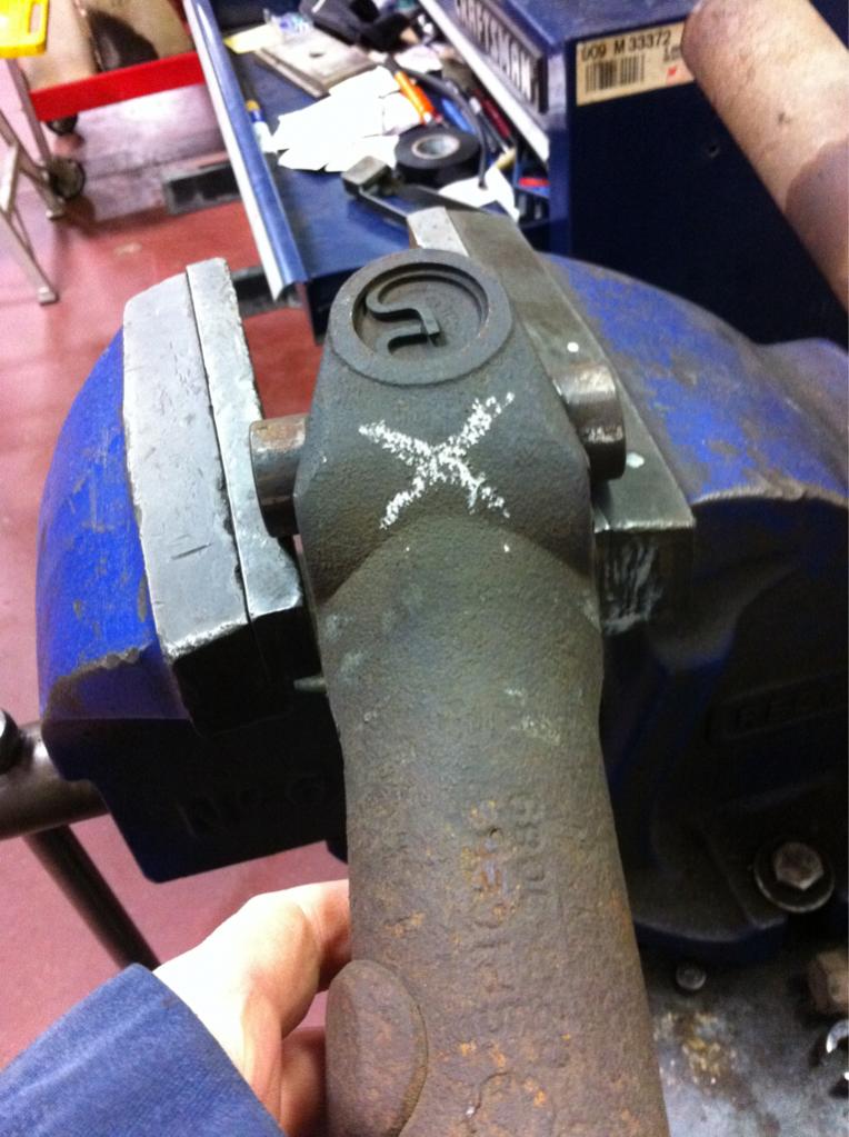

Hold the shaft supported in the vise as shown and x marks the spot you wanna hit.

Jester32 said:
Dont forget the clips lol I was just using a good shaft for demo lol.
Haha..yeah. that would be funny if I didn't take the clips out. Lol! Im just beating on it thinking to my self "wonder why its not working?"... im sure there are people that would do that, luckily im not one of em... what about heating it up like was said previously? I've done that with race bearings before, but it seems like something like this, would make it prone to bend or be brittle while you were pounding on it.
