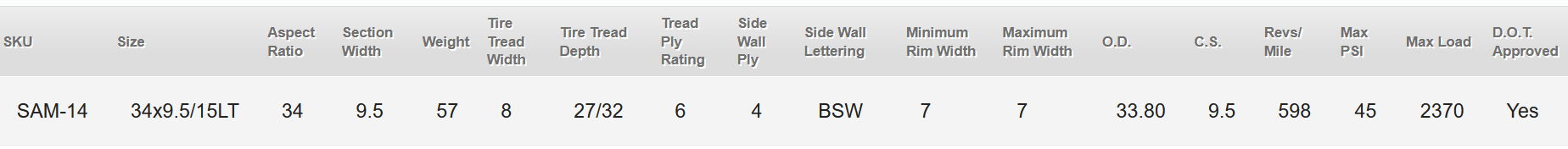

I just bought a '69 CJ5 and I want to set it up for trails and mud. I would like to put on 35" tall tires that are not ridiculously wide, I want to keep the tires inside the wheel wells. So far, what I've found is the Interco Narrow SS TSL at 34" and they call out a 7" wide wheel for that tire. Interco does sell a 35-10.50 Bogger which would be perfect, but they are $650 each, they call out a 7-9" wheels for that tire.
ETA: I found some other Interco TSL tires, they are 35.5 x 10.5-15, they call out 7-8" wheels meaning I could probably go with some 80's 15" x 8" factory white spoke wheels. They are on the upper end of size that I want to go to for a Dana 27 front axle and I may need to go with a 4" lift. I would love to find a picture of a CJ5 running that combo.

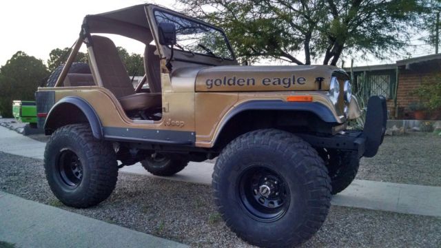

Here is a 1979 with 35s and a 4 inch lift

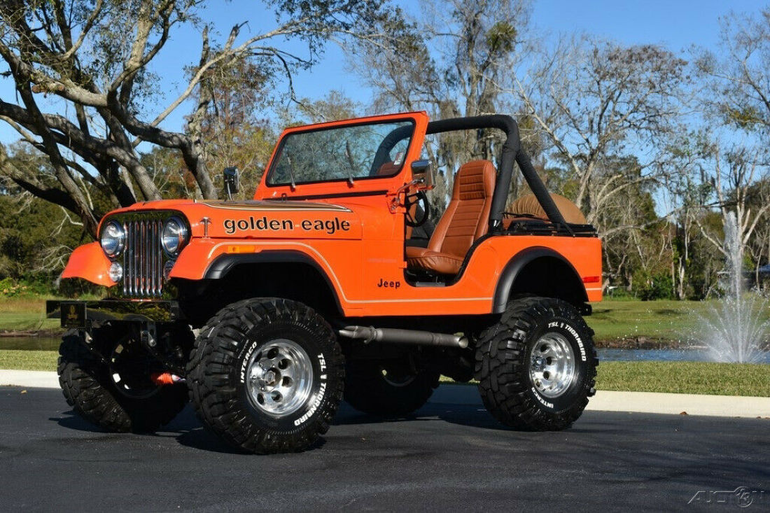

Here's another 1979 with 6" Lift and 35 x 14.5 x 15LT Thornbird Tires

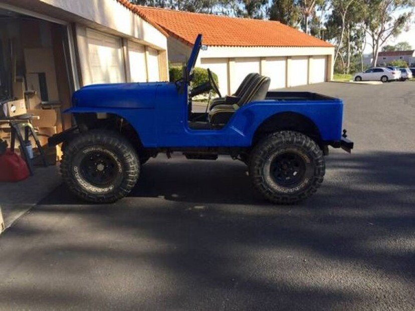

1971 with 35 tires. Looks like the front fenders have been trimmed a bit.
So looking at the pictures, it looks like I may be best going with the 34 inch tall tires and a 4-in lift I don't want this thing to be so top heavy it just tips over in a stiff breeze.
