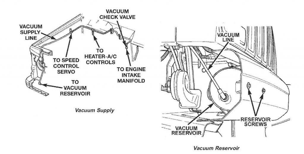

Idle should be 750 rpm. When it first starts cold it may hold 1000 fir 30 sec or so but should idle at 750. You have a vacuum leak. That may be your issue when you put it in gear.
Those codes are odd.
Clean the TB and IAC. If it still idles above 750 take WD 40 or TB cleaner and spray around the intake starting at the TB base. Then spray each injector base, each spark plug and then vac lines.
Front end collision? Did you go this far with the vac checking?
yeah, actually that vacuum reservoir for a long time we had unplugged and ran fine, but then we found out that we needed it to change where the heat was coming from
