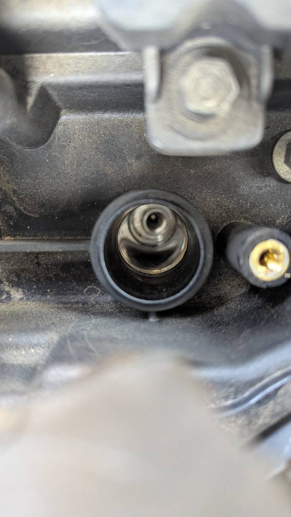

Here's a picture of the threads of from the spark plug stuck in the hole

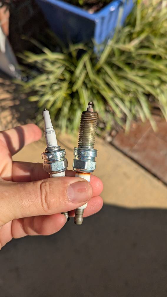

And this is what the broken spark plug look like after he took it out

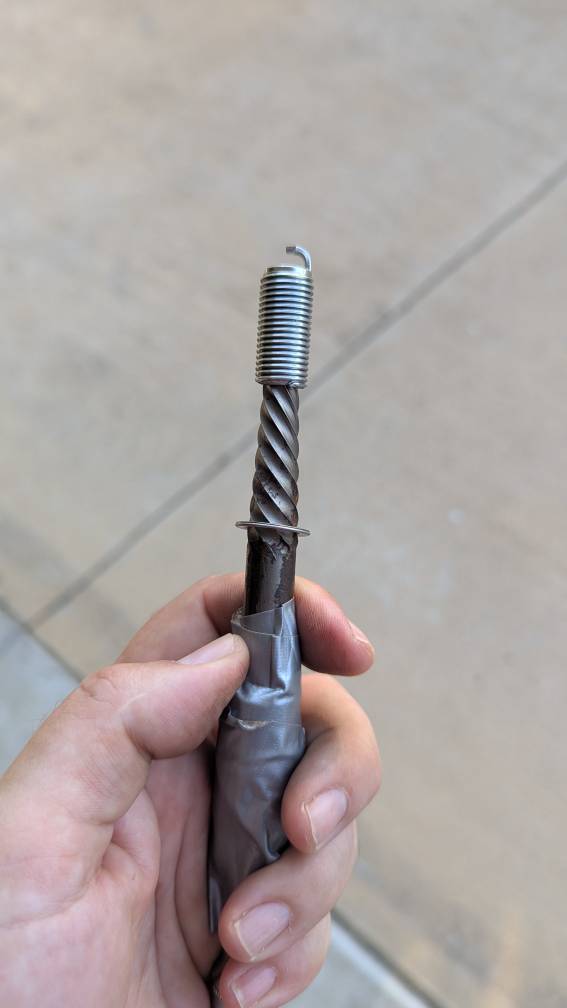

Here's the contraption we built to get a left hand thread easy out down the spark plug hole
